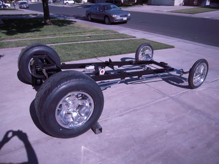

            Ok time for more pix. With the chrome all back from the shop and the chassis painted, it was a pretty quick job of bolting it together. Here are a couple pix of the chassis as a roller. He picked up Rocket wheels with M/T Sportsman s/r tires. The fronts have the original hubs rechromed, new 16" rims, and new stainless spokes.
ID:	863385Click image for larger version
            Rich
