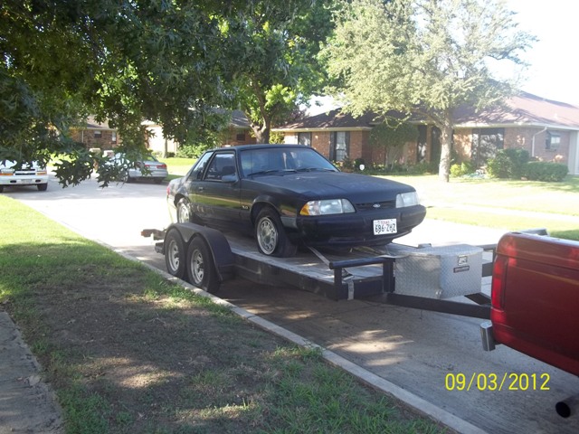

    Low option 1990 LX 5 speed - electric windows and a/c is about it for options. I'm afraid to look at what the several trips being drug up that trailer has done to the subframe connectors. They were welded in many years ago. Eibach 1.5" lowering springs as I remember it. Rides ... uh... firm. Definitely not sprung for drag racing. Oh well.
    This poor car has been sitting for 12 years. I don't even what to know what the bores look like on the 342. I pulled a 302 out of a 89 Lincoln LSC to get it back on the road in 5 days, should be interesting. The LSC mill is probably a little tired, with 100k miles on it, but it will hopefully pass inspection with it.
    I didn't want to put it in 5k builds because I don't plan on it staying there. It will return to street duty as my dd. Here's the sad story today:

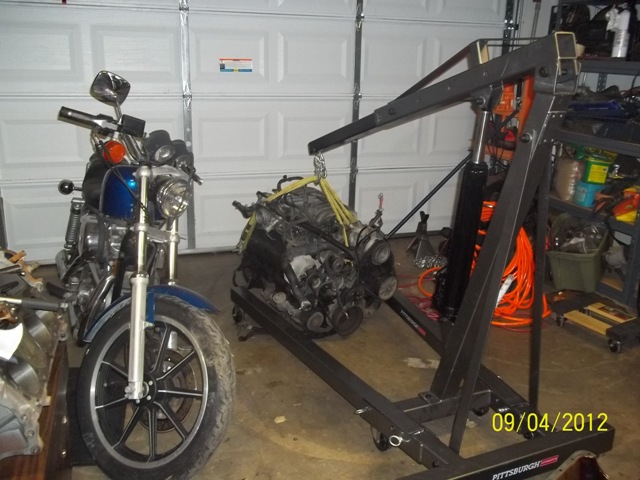

    Step 1a - 302 from LSC and T5. I should probably wash it all first.
    Harbor Freight is trying to lose the cheap orange paint=cheap chinese junk by painting it grey. lol.. they must have hired one of our old managers. We fixed reputations by renaming things. hehe.
    I'm almost positive all the sending unit / sensor stuff is exactly the same and the LSC was a SEFI deal so I'm pretty sure my harness will plug right up with no mods needed. If anybody knows different I could sure use the heads up.

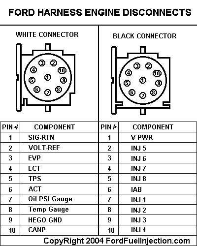

      Yes, all the engine sensors are the same as the Mustang. The shortblock in my Ranger started in an LSC. The injector harness is different from a Mustang piece, it is missing the dash coolant temp circuit, dash oil pressure circuit, and O2 sensor ground circuit.
      Small details but they are of note if you're leaving the upper intake on there. So you'll want to splice into the engine harness and add a ground for the O2s. It's orange at the salt and pepper shaker, goes to pin 49 of the ECU if you want to double check it's location.
      My LSC also had a giant alternator with external regulator.
      Not sure which side of the connector this is...
