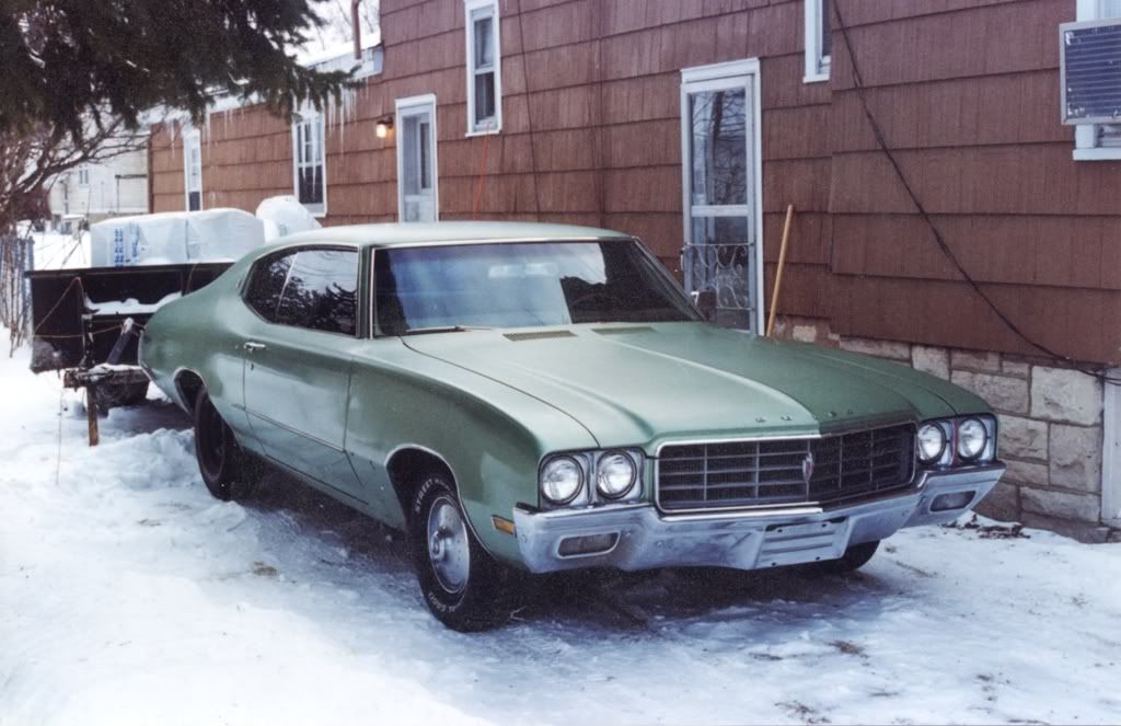

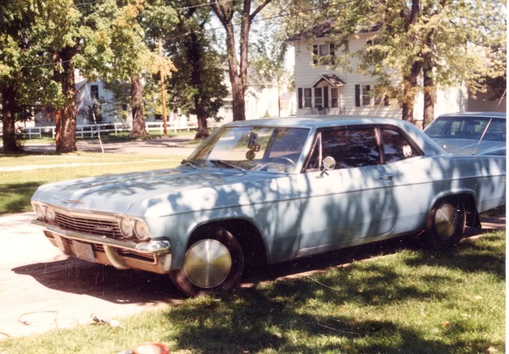

      My little guy is really into it, he wants to help already at only 2 yrs old. My older daughter is not nearly as enthusiastic about these projects, but still thinks it’s pretty cool. Found these pictures over the weekend, thought I would share.
      These are the three previous efforts in building a car, and yes I learned a ton, mostly “what NOT to do”. I still seem to learn most everything that way.
      The blue 65 Chevy actually DID get finished, but was wrecked in an accident. The first car bought with my own money and my favorite.
      The Red 66 Buick was taken apart and never put back together. The result of this one is truly embarrassing! Turns out you can NOT build a 10-second street car living on your own making $7 dollars an hour, go figure. I took the body off the frame and now I am not sure why, it needed “some” bodywork, but certainly not a frame-off, what was I thinking! I got as far as taking it apart and getting a 455 Buick (#1) short block finished. Car got trashed, and the finished block was traded for something??
      The 70 Buick was bought and sold within a few years as I got bit by the motorcycle bug, along w/the 455 (#2) that was gonna go in it.

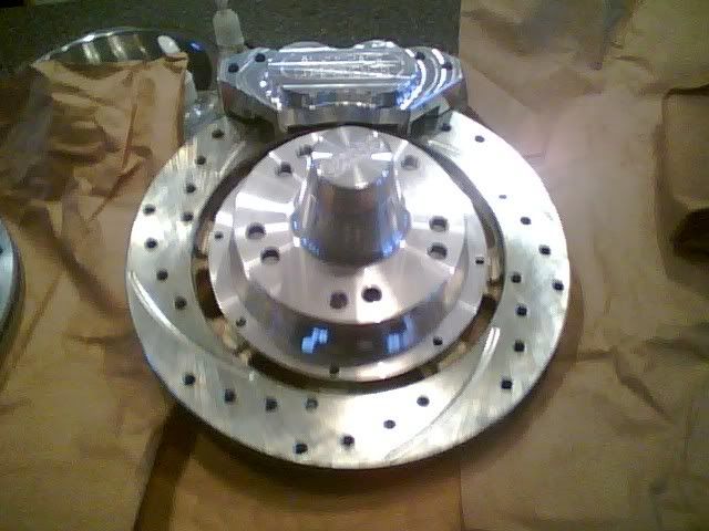

            Here's a here is a couple crappy phone pictures, the brakes (Aerospace components) and the boxed lower control arms that I am nearly done with.
              #21
              Re: mike343sharpstick's 69 Javelin project
              Boy - I bet those brakes were CHEAP! :o :o

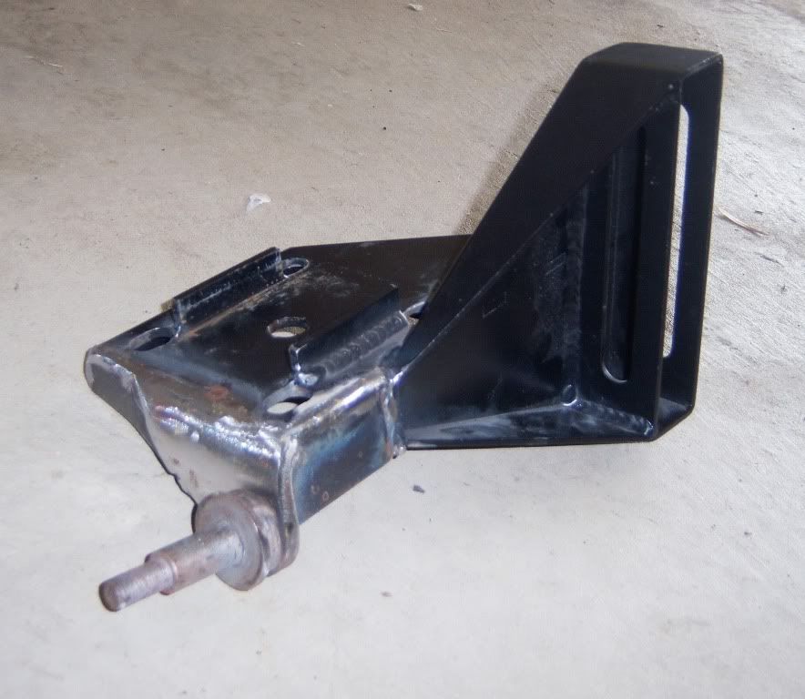

                Finished my panhard bar spring plate, this was originally a Maier racing part for a mustang; I basically cut the front off and welded the Javelin portion on. Us AMC guys often buy parts for other cars and make ‘em fit, the real talented guys make stuff from scratch, I am NOT one of those. More to come on this but need to get the car close to resting at ride-height before I can continue.

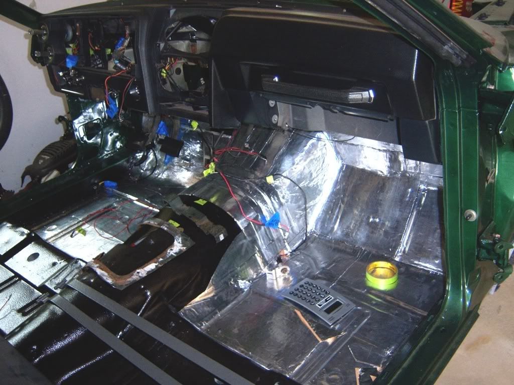

                Finishing up the dash and sound deadener.

                  I gotta ask.....What is the Calculator for?
                  Seth
                  200 mph or bust.......
                  • Brian Lohnes
                    • 18784
                    #24
                    for totaling man hours of labor...HA!
                    Awesome work man. Looks clean as a whistle. I really dig the boxing of the control arms, total 60's racer looking modifications there.

                          what did you use to "paint" the floor behind where you have the sound deadener?
                          • mike343sharpstick
                            • 2615
                            #28
                            Truck beadliner coating.
                            The beadliner coating is actually under the sound deadener too, it is coating the entire inside floor area and trunk floor.

                              That's going to be one quiet ride! (well, depending on muffler choice that is!)
