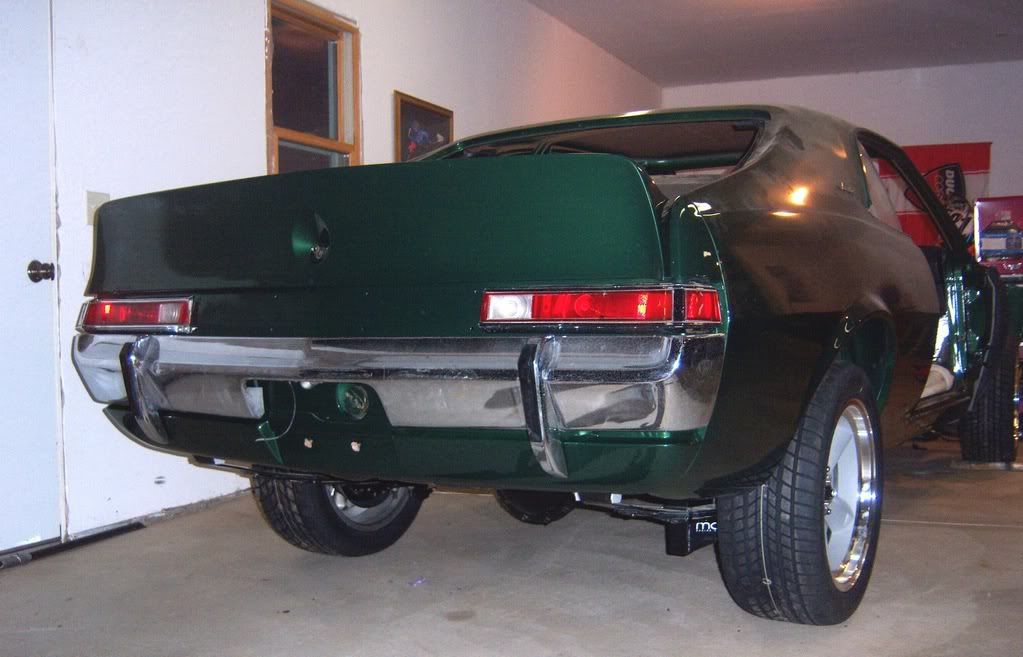

          Hey all, last weekend me and my body guy painted all the bits at the back of the car.
          Today I fired up the propane heater out in the garage and got the parts installed.
          I may be a little biased, but I think this is one of the best back-ends on any car ever ;D
          Clearly the rear bumper is not rechromed, I'm just gonna call it 'patina' for now ;)
          Today I also got the fuel tank and fuel line finished up too.
          In the next week (or so?) I will be getting the glass installed.
          Cheers
          Mike

            You probably already know this, but you can use an SOS pad to get all the water spots out of the bumper. Then, some chrome polish to bring out the shine. I have been making do with old chrome bumpers for a long time. Just thought I'd try to help.
