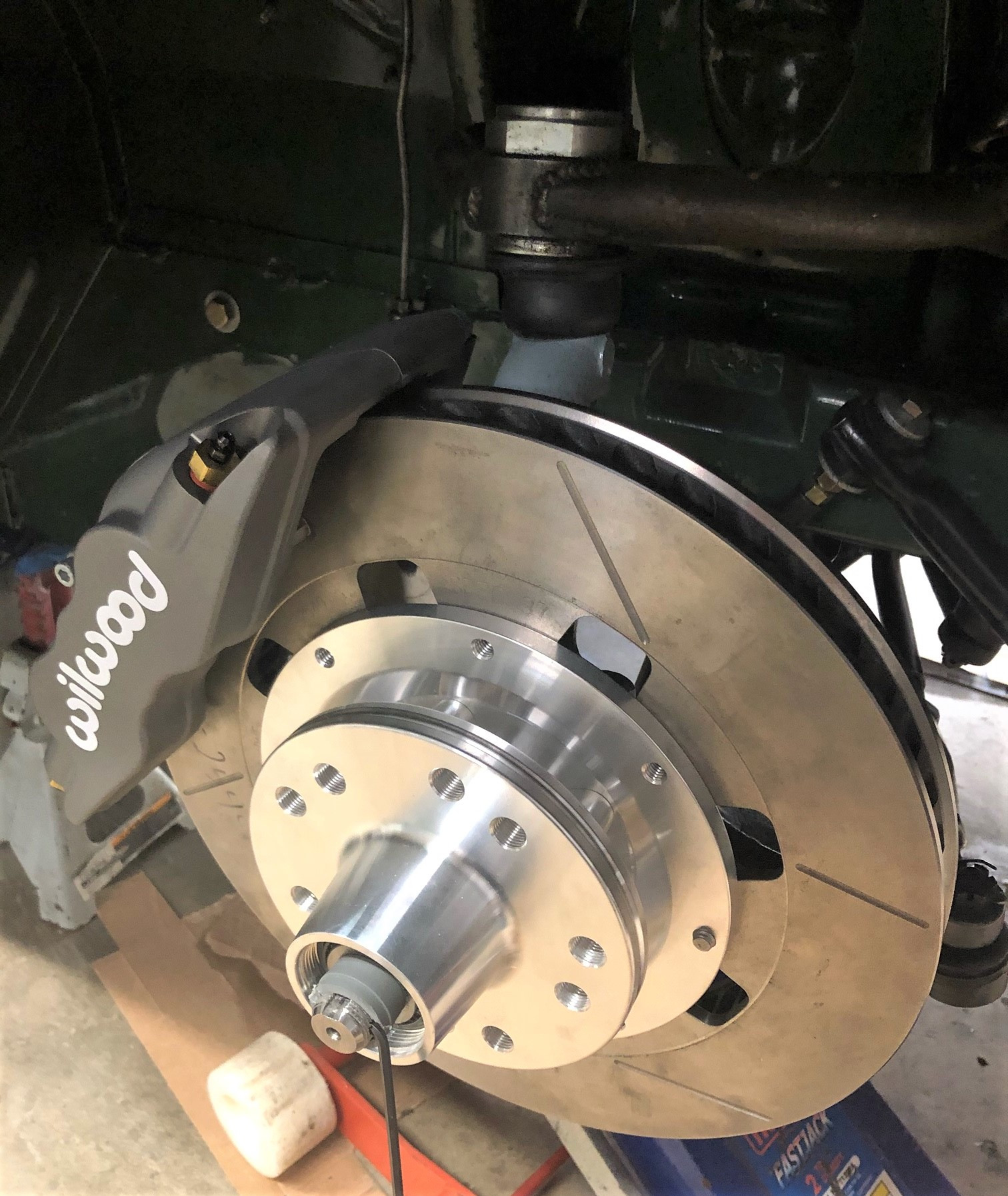

    I just got the car out for it's first drive for the summer a few days ago.
    I added a Bluetooth receiver to my amplifier, This little JL Audio MBT-RX is a clever little devise. I wired this to my Sony amp, and that's that. In other big news, I added an electric fan and shroud to the radiator, and finally painted my fancy custom suspension.
    The brake package upgrade is on hold awaiting my machinist to finish the caliper bracket, all the other stuff is done!
    Nothing too interesting going on, but it was nice to get it out finally.

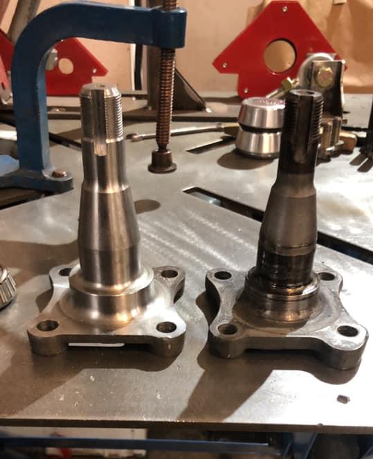

    Originally posted by mike343sharpstick View Post
    This winter, lets make the brakes even a little better. A company is making new spindles for AMC's (Strange but true).
    The new spindle is dimensional the same as a Mustang II, which is also larger than the stock AMC spindle. So armed with that information I went ahead and started to put together an upgrade to my aerospace kit.
    The Aerospace Brakes Kit has been excellent, but I want to take this to a more capable brake package.
    On the new spindle I have the Wilwood Pro hub, and the Wilwood GT48 curved vane 12.72 x 1.25 rotor. This will require a 16-inch or larger wheel.
    Then for the Caliper I'm looking to use the Wilwood Forged Superlite Internal 4 Caliper. It's huge, and been a bit of a challenge to fit.
    I prototyped the caliper bracket in wood, and will have that machined in aluminum.
    Click image for larger version Name:	Brake4.jpg Views:	0 Size:	590.2 KB ID:	1286528
    Click image for larger version Name:	Spindle.png Views:	0 Size:	417.2 KB ID:	1286526
    not sure why you'd work on the brakes, all they do is slow you down.....
