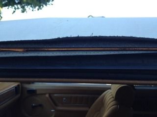

            I'd replace the fake convert top with a vinyl top since you have all the trim pieces. Since there is fiberglass under the convertible material, it's unlikely that it's rusted out. A vinyl top would give it an unique look.

              It's actually already vinyl. The problem is its turning brittle and just breaking off, so I don't know about salvaging any of the trim.

                I'm voting Rhino-lining instead of vinyl. Cheap, won't blow off, sorta looks like vinyl.
                I'm curious what the metal looks like under the fiberglass though. Chances are good its in fine shape, course chances are also good its pitted.
                Either way, Rhino-line the fiberglass, or toss the fiberglass and Rhino-line the metal part.
                And if you get lucky and the metal is in good shape, sand-mask-and-paint.
                More pictures of the weirdo fiberglass thing where the trim line is would be cool?

                  I have to say I've never seen one of these tops - interesting. I would pull it off and keep it - you just don't know what will be collectible in 20 years.
                  Stiney as we already know - is brilliant - yes 100 times yes on the rhino lined roof if you have pitting issues.... if the roof is saveable in nice metal - paint it white and put the trim pieces back on - it will be a very unique and cool "old school" look for a notch.

                    John, I don't know if it would survive being taken off. The seam in the picture snapped apart in my hand. It's like that all the way around the car and the trim isn't any better. If the metal is good I might just have it painted because the ridges should be in the fiberglass (hopefully).

                      I'm not speaking about saving the vinyl over the fiberglass - just the fiberglass itself, but if it comes apart in your hands (old 'glass has a way of getting brittle) Selavi - get out the 80 grit and the power sander - take it down to metal - self etch primer, and you're good against rust for a while at least, for some time and about $25 in paper and spray cans.
