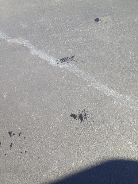

                      I took the car to the NMRA World Finals yesterday at Beech Bend, but before we even left I noticed oil splatters on the driveway. The bottom one looks funny because I stuck my fingers in it to see what it was (keep your jokes to yourself!). Do valve seals have a break-in period or something?

                        Not gonna be valve seals. Thats gonna be a leak. Look over the motor, check valve cover gaskets, oilpan gaskets, timing chain cover and your oil plug and filter. It can leak more place but those are the more common ones.

                          Go by an appliance store and get a big sheet of cardboard (plywood works) and park the car on it... Mark the tires..
                          After some time, move the car... You will know where it comes from then..

                                #60
                                Oooook...lots of info for me to translate. I also realized that I meant valve cover gaskets instead of valve seals, since that's what I just put on there. Bob, I hope to do that this weekend when I finally have a little free time. Tom, the top IS a POS lol. I'm just trying to figure out what I want to do with the car in general...if the metal is good I might not put one back on and just paint everything. Russell, I'm still trying to figure all yours out...sorry! I'm a hands-on learner so until I actually pop the hood and see stuff, I have no idea what's going on. The thing is, I have access to a 302 that came out of my uncle's '79, I'm just not sure if it's the original engine or the ~11-12 second drag engine. I have a lot to figure out, but I have plenty of time till I have funds available anyway.
