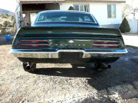

    Back to the car, I was casually looking for one over the years and about a year ago a BangShift member put me in contact with a fellow Power Tour'r in Alabama that had a '69 Firebird for sale. After looking at some pictures and talking with the owner I decided the price was good and flew out the Alabama to drive the car home to Ely, NV. Which is the second time I've done the fly and drive home routine, the first was with my Thunderbird out of Colorado. On to the pictures.
    The car itself is pretty decent and solid. It has manual drum brakes that have been gone through and manual steering. It needs some wiring work, but I plan on doing quite a bit of wiring with the EFI anyways. The first picture from 383S-10 on here.

    Fast forward one year and I am finally starting to actually move forward with the OHC project. I moved over the last summer so it stalled a bit, but it was all worth it as I now have a nice work area to work in, as opposed to the car port in the above picture.
    The engine sounds and runs pretty good. But the V8 400 is coming out for the OHC Six.
    Lined up the car in my new to be barn's shop.
