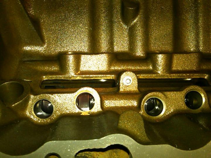

      Ya, same friggin' one. The guideplate ear broke off, allowing the pushrod to flop, and I'm guessing the mis-aligned rocker pushed down on the spring retainer, allowing escapee keepers to flee to freedom in the oil pan.
      Hang on, I'll show some more pics...

        I'm gonna go out on a limb and say that's what allowed the slop in the valvetrain, and that extra movement was too much for the old re-used valveguide. Stupid me for re-using the old ones. Never again.

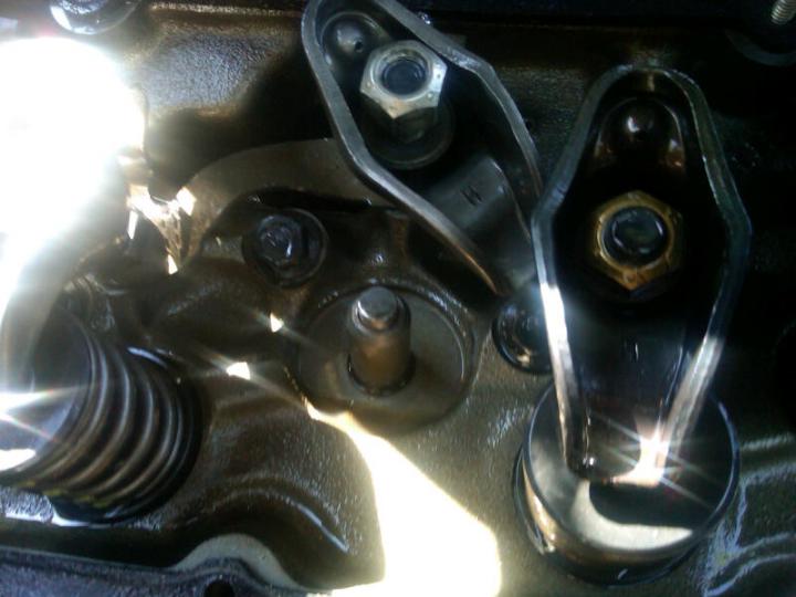

          I think it actually spit the lifter earlier in the morning, somewhere on the 20-min ride to the hotel. Note the discoloration of the rocker arm nut, it got pretty damn hot, probably from lack of oil.
          That rocker was blued from heat, the rest looked fine. It was also the only one that the rocker-ball was scarred up pretty bad. All the others looked new, but that one that starved for oil was smoked.

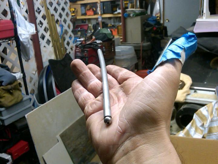

                This pushrod was NEW. Apparently my valvesprings were a little too stiff, AND I had a bent valve.

                  And yes, the underside of the hood was sharp. Hence the blue tape on my thumb.
                  Tetanus shots are for wusses.

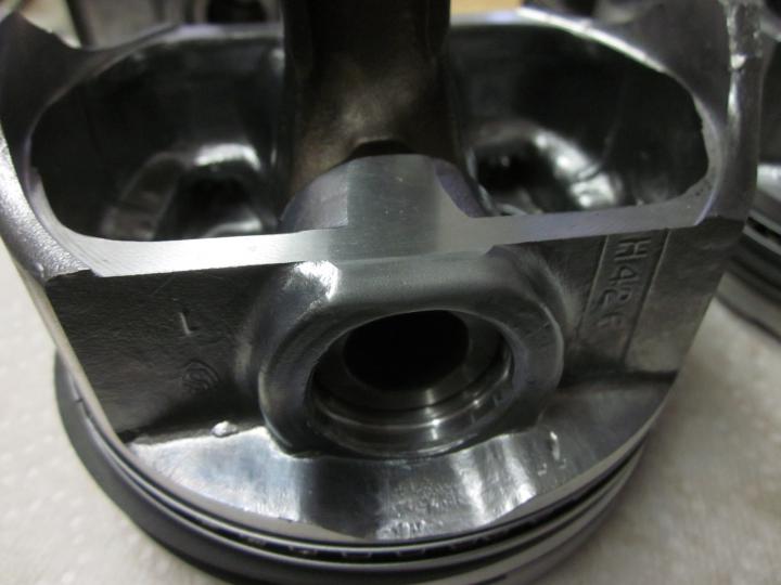

                              Here was the biggest nick, in a spot that I was initially pretty concerned about, right below the pin bore. However, its not technically load-bearing, since its outside the pin, and is pretty superficial.

                              This one got nicked up too, more from pushrod debris ping-pong than anything else.

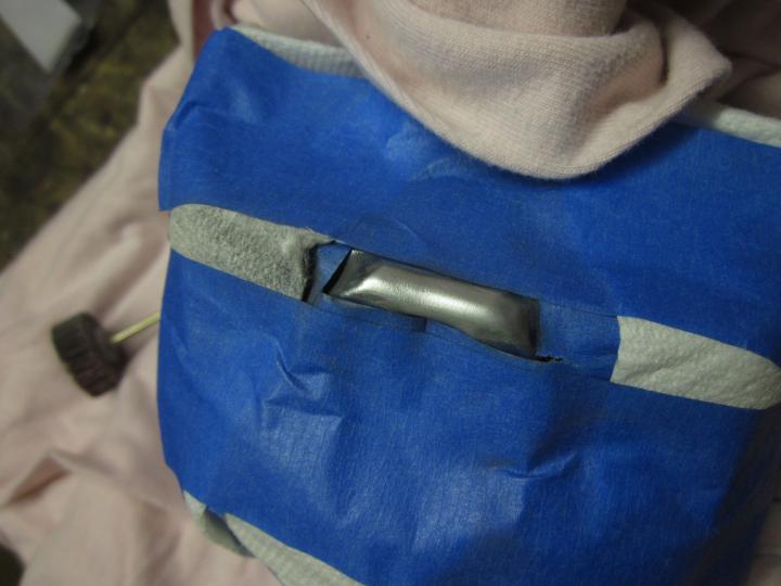

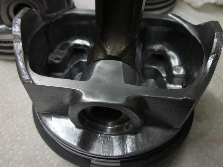

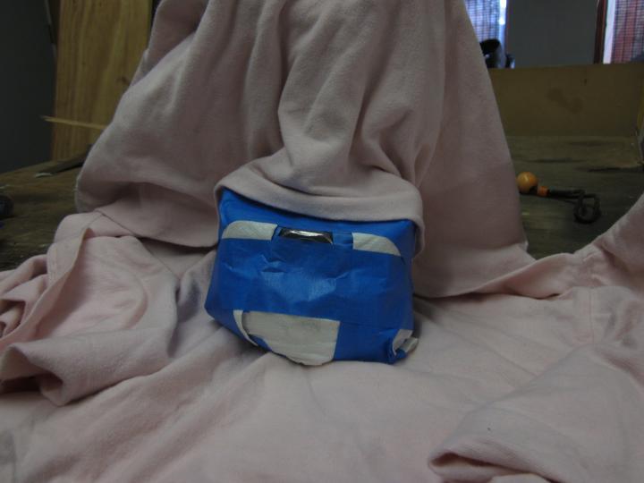

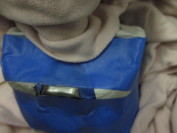

                              Here's the beginning of the remedy: mask it off so aluminum dust doesn't go everywhere...

                                With nicks in aluminum, within certain limits, you can just get rid of 'em to avoid any stress crack starting points.
                                Step one: Knock down the big high spots with a small stone in the Dremel, VERY lightly so as to avoid removing too much material.
                                Step two: 80 grit flap wheel in the Dremel. Also VERY lightly!

                                Cover up the rod and pin to keep 'em clean...

                                After the 80-grit flapwheel
                                After the first of the polishing attachments on the Dremel...

                                Finished up with the finest of the three polishing attachments on the Dremel... after this step, sanding scratches from the flap-wheel are entirely gone.
                                THOROUGH cleaning with Brakleen to get any aluminum dust out of the pin area.
                                And they came out pretty dang clean. If I hadn't told you these were the same pistons as in the photos from the previous post, would you have known?
