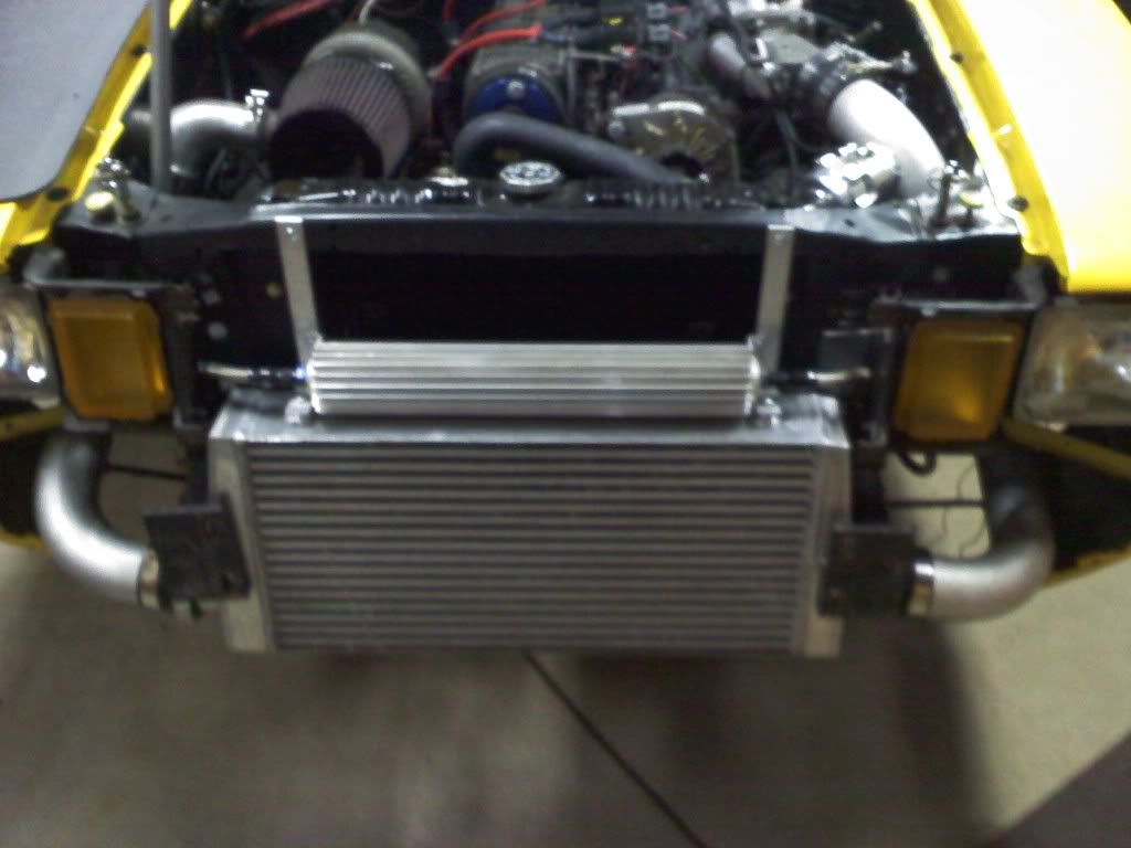

    Big time fan thought I would throw up some pics of my 4 year project. That is with in sight of driving under its won power... whoo hoo
    1977 ford pinto w/ 79-80 front clip 1978 tail lights, custom cowl induction hood...
    huge 4" core air to air intercooler w/ 3" inlet/outlets tial wastegate and bov
    Ford 2.3 with stinger header modified for a holset hy35 turbo, turbo joe fuel rail 90lb fast injectors, complete a1000 fuel system w/ sumped stock tank, gutted and rottated intakes and 65mm thottle body, ls2 coils, ems pro efi, c4 with trans brake, ford 8" with mini spool 3.50 gears for now... caltracs and split mono leafs

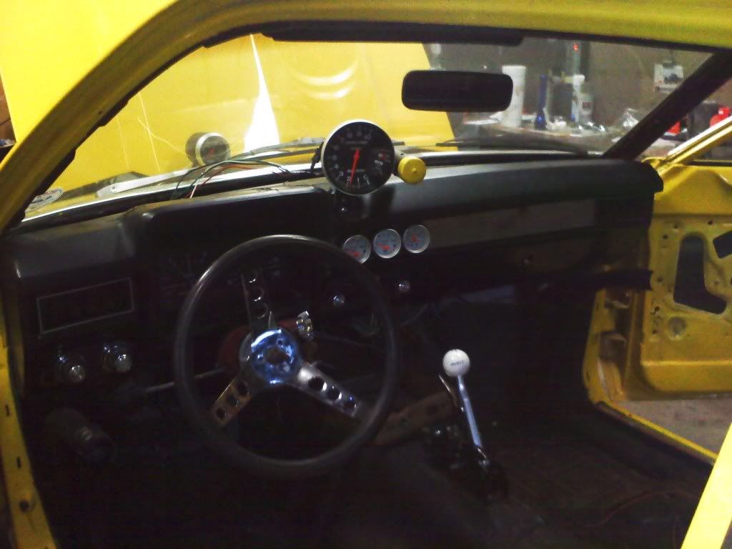

    interiror is one big kirkey race seat to fit a wookie In a pinto, passenger seat is 65 mustang bucket, made a custom dash panel to cover up the last owners attempt to put guages in the dash, but Im now planning on using efi analytics Shadow dash software and a 7" tablet in the car.... so need to make a mount for that...
    Hope to redo some of the engine bay wirring and finish the rest of the wirring to get it road worthy for spring, since we are still half frozen in minnesota..
