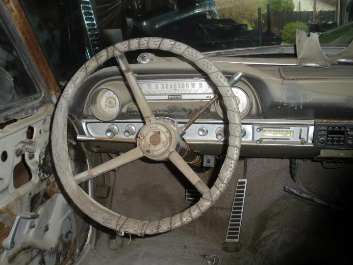

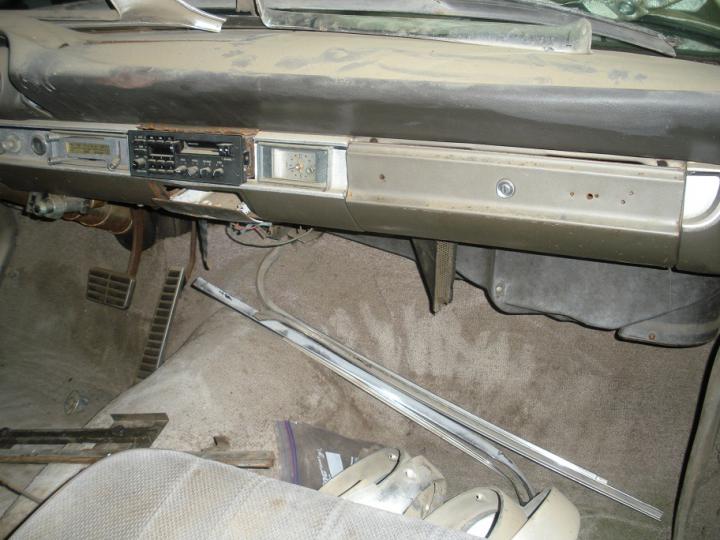

                            #43
                            interior shots
                            here are some of the inside. I haven't yanked that late model oem radio yet but I'm hoping there wasn't a ton of hacking. I think I found a dash plate in the trunk so hopefully it goes there. I also found the horn assy for the steering wheel in the trunk and incredibly it's not broken.
                            As I mentioned it also has some late model buckets in it but it did come with an original rear seat and the frames look to be in good shape.

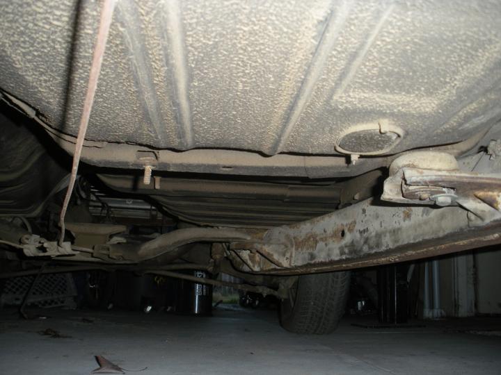

                                #45
                                under the car and rear end
                                well it looks like it has a 9" and if I'm correct, since there's no taper at the ends of the housing, it's big bearing too.
                                as mentioned before, I believe most of the rust I have seen is simply surface rust so it's a pretty solid car. The leaf shackles have been flipped to jack up the back. If I hadn't seen/ read about it on FastEd's 66 Thunderbird thread I wouldn't have known why it looked funny and so high. I'll probably wind up in a similar build mode initially just to get it on the road until I can spend the money to do all the extras to the engine, suspension etc... I like the idea of having a long lowered car to cruise in for this summer.
                                anyway the pix:
