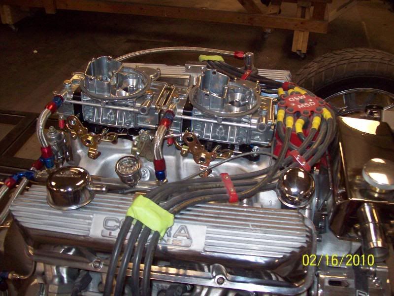

                      I think the frame rails are too jacked up on a car for the CV front end.
                      First things first, if the frame rails are 34" apart, you have a good start.

                        Yeah I noticed the spring pockets are part of the stock frame. Boo.

                            oof that picture looks cool. That must be what my friend Dave was talking about with the 2 x 4 setup. I really like that overflow/ radiator fill setup.
                            Yeah the frame on this won't work but I imagine the Crown setup would work on other cars, like converting a shock tower car over?? Probably too wide for a Mustang but there's bound to be others that could use it. Maybe a newer Galaxy/ Fairlane since they have single attach lower control arm like the early Mustangs.
