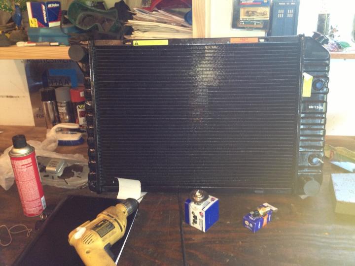

                • New radiator is in. Time to get the old Trans out.
                  Here is a pic of the new parts:
Name:	New Cooling parts.jpg

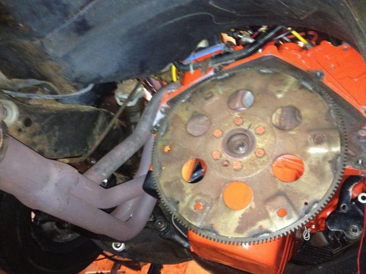

                    • For the "pictures or it didn't happen" crowd:

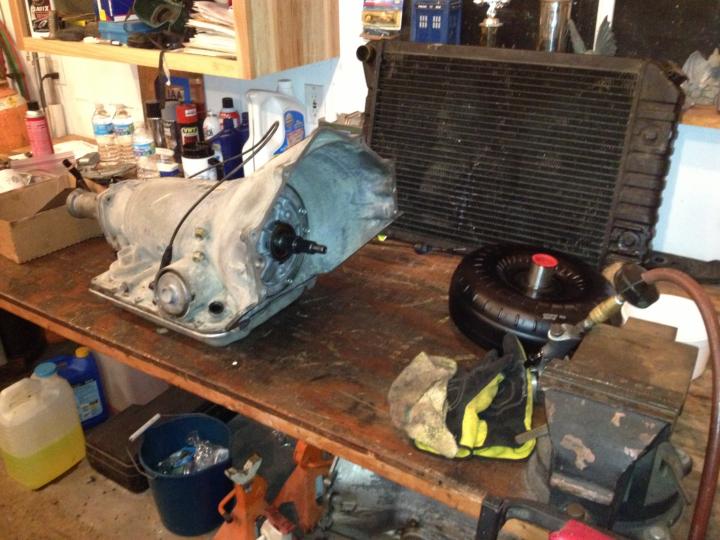

                      • New stuff ready to go. Old radiator. Had to quit at 12:30 am so I could get some sleep before work. Hope to be back on the road Saturday.
Name:	Trans ready to go.jpg
