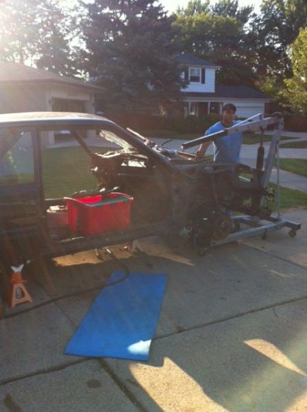

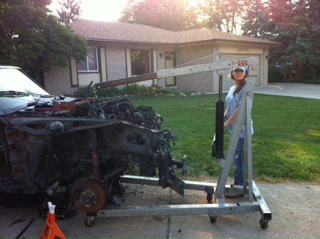

            Worked on the wrecked svo today, pulled majority of the interior parts, and then went to work on pulling the engine.
            The car fought back and some of the sheetmetal sliced up my arm good enough at the tricep to require 6 stitches at the ER. Seeing all layers of skin sliced with muscle and fat through the wound was enough to convince me that a band aid woudnt cut it (no pun intended). Post recovery finished up unbolting a few parts and then was off to John's shop to pick up his cherry picker. Luckily he had some suds to help the mood as the pain killers were wearing off.
            With help from my wife was able to pull the engine and trans together and they are now tucked away in my garage for future use.
            This is the 3rd engine Ive pulled this summer in i believe the same amount of months. While pulling engine and trans from the front with zero front clip was easy, I think I still prefer the method of pulling trans from the bottom and engine from the top separately (with hoist of course). Click image for larger version

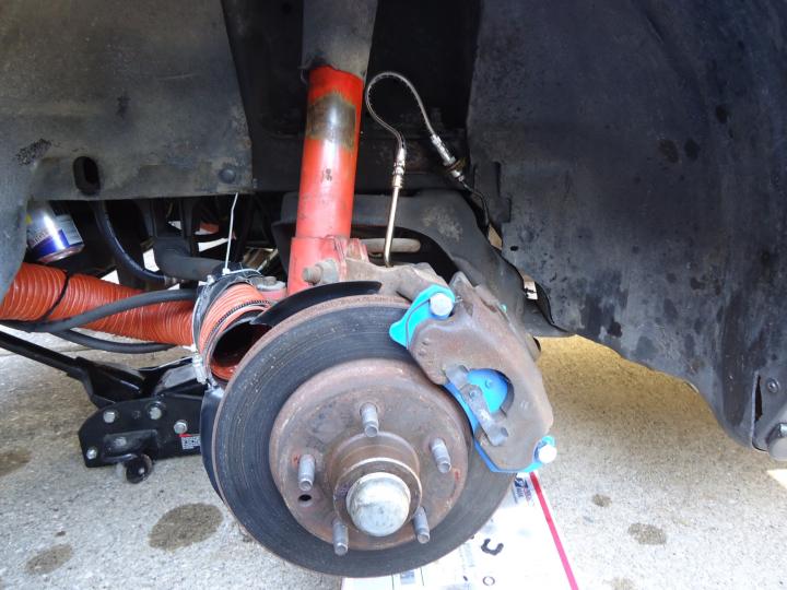

              Put new SS lines on the front of the SVO and the Hawk race pads. During the burnish session found out that the phenolic pistons were growing too much....now have to take the system apart and put calipers with steel pistons in. ugh only 4 days left before the track event!
              first picture is the stock rubber lines

                Is that a beer can catch can?
                • odmarco
                  • Apr 2013
                  • 83
                  #53
                  yes sir!

                      I'm impressed you got the engine and trans out in one piece without doing more fluid spill damage to your driveway.
                      Nice work wounded warrier.

                        It helped that the car had to have lost the majority of it's fluids back during the wreck, so no coolant or PS fluid to worry about. The only thing that made a mess was the trans fluid....which is why i would have preferred to drop out the bottom. don't have a plug so best i could do was have a pan follow the trans on the floor as i inched it out of the car and have the fluid leak out of the tailshaft into the pan.

                          I dont have a trans jack and I think unbolting a trans is a pain so I always pull the trans with the motor out of a fox. I have never done it in the driveway where I cared about making a mess. Drain the tranny, drain the coolent, remove belt, un bolt alt. and PS pump.... You know the rest. I have always wanted a SVO

                            yeah in hindsight i should have drained the trans... given that my driveway is sloped and i didnt trust that car all that much...I really hated being under it. Actually i didnt even unbolt the driveshaft from the axle....just pulled the yoke out from the trans when the engine was moved. But yeah next time i'll drain the trans fluid.
