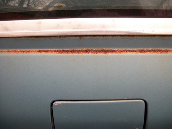

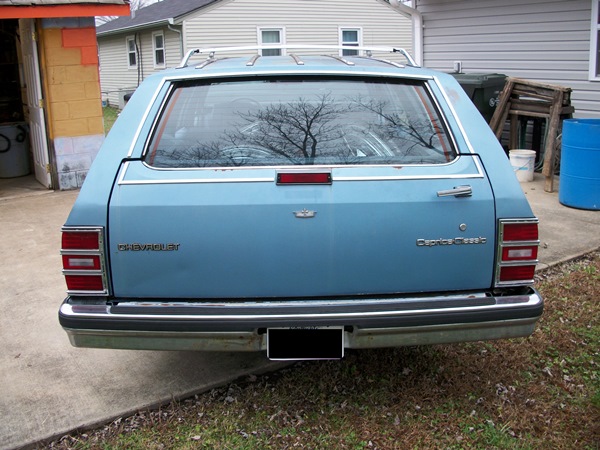

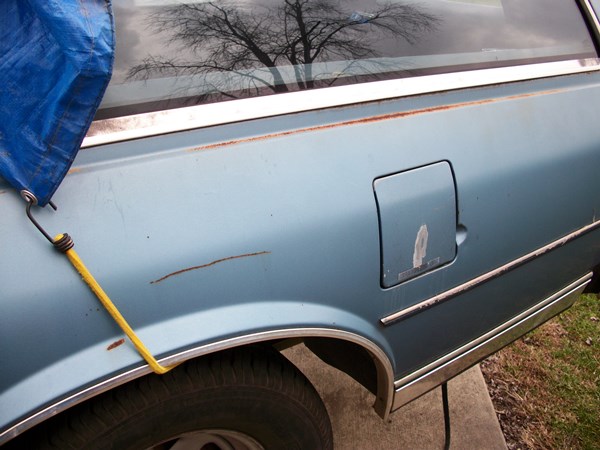

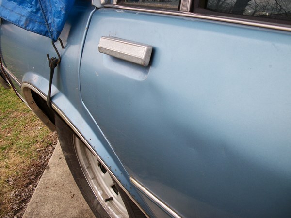

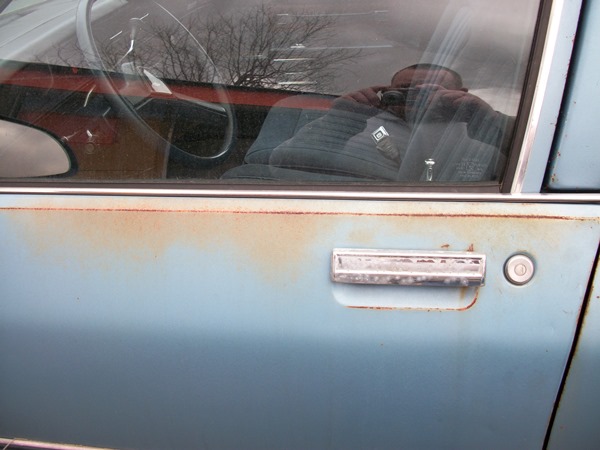

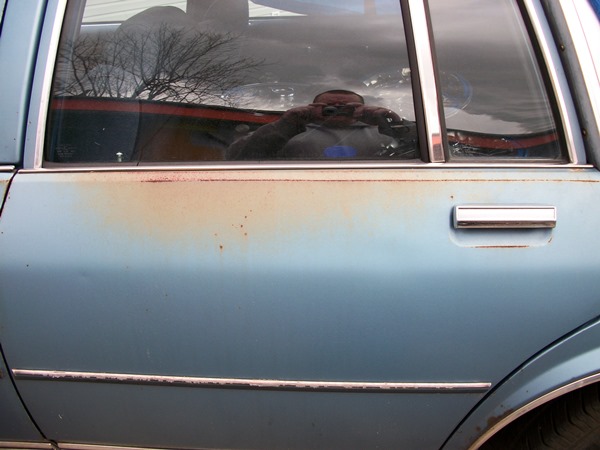

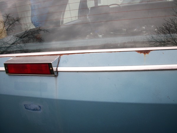

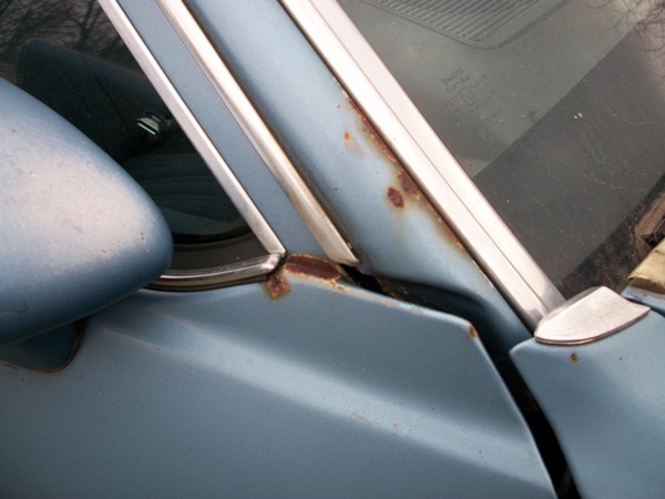

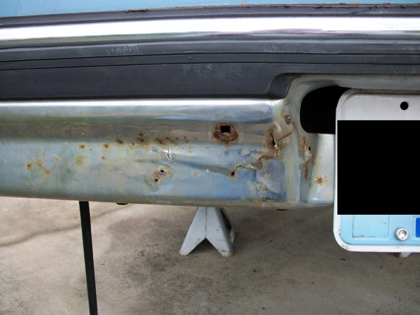

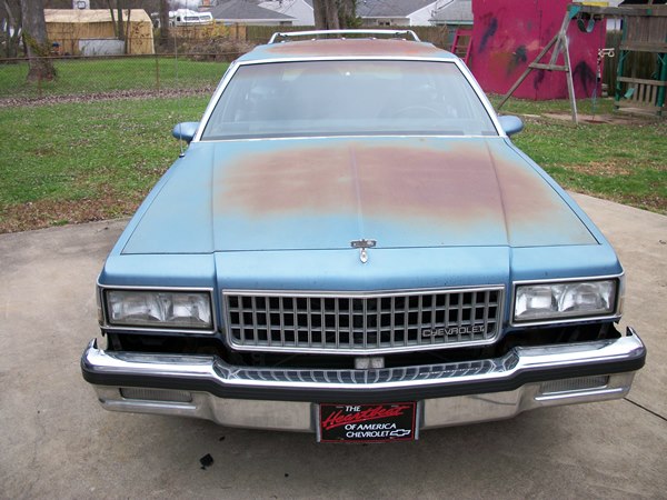

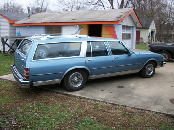

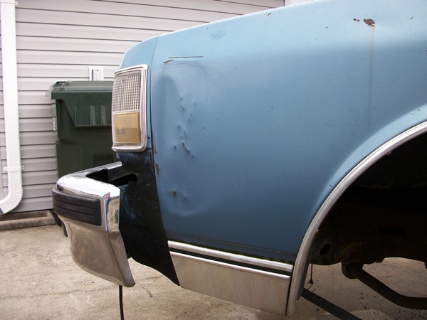

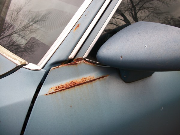

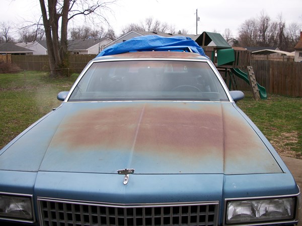

    The purpose of this car was to be a family hauler. I can get in my wife's borrowed econobox but it isn't comfortable. I can only fit three in my truck and with the kids at 7 & 8 at the time of purchase it seemed to be a relatively sweet deal. So the body is a little rough. The only rust through I could find was the spare tire well. Good place to learn body welding right? I knew I could fix the mechanicals if anything went wrong. Not looking for fast, just dependable. Okay, so GM in all it's "wisdom" thought putting small Olds motors in big cars was good for fuel economy. "I can fix that if the need arises" was my thought pattern when make the decision to buy. It was the week of Thanksgiving 2011 and you know how hard it can be to Christmas shop for some people, I must be one of those people. When my parents got word of what I was doing and why, they pitched in on the purchase price of the car, so my outlay for the car itself was only $200 and it came with a full tank of gas. In retrospect I think the guy knew I was about to get bent over but didn't know it yet. Here are a few pictures of the way it came home.
    After 18+/- months I have named it (something I DO NOT make a habit of) The Blue Turd(le). As I add to this you will see that I have chased the next weak link for the entire time I've had it. It's got (had) a 307 small block Oldsmobile engine backed by a 200-4r transmission and 3.23 8.5" 10-bolt rear, it IS slow.

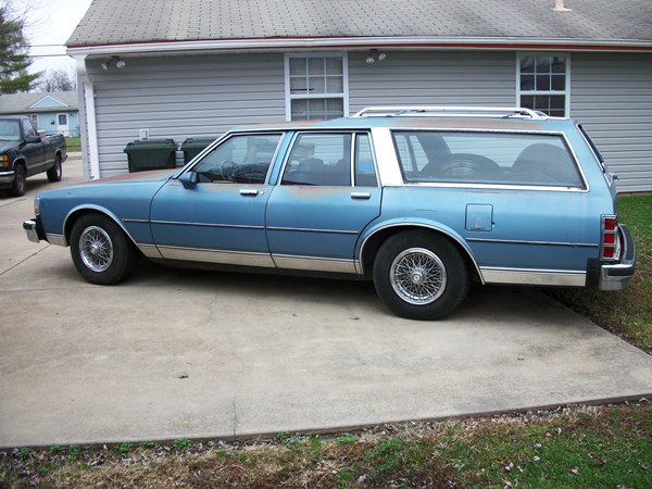

    Some more pictures of it right after purchase.

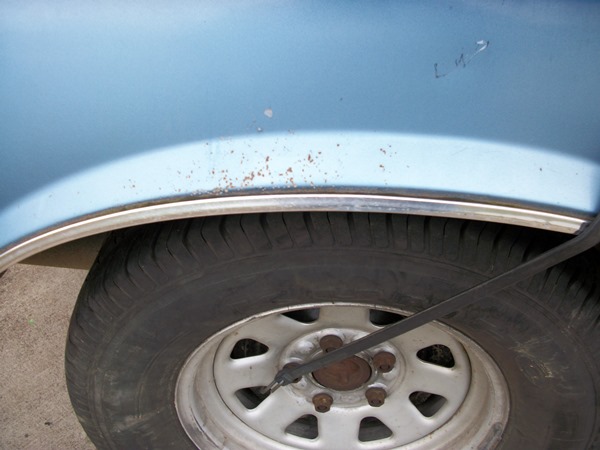

      I had a couple of the Astro wheels laying around. I got four more from a friend that was scrapping his Astro. The tires are Kuhmo 245/60/15 & 275/60/15, left over from my Astrotastrophe. All four Kuhmos are on the Turd(le) now but at for a while the fronts were a different brand but the same size.
      The guy I bought this from bought a set of tires & wheels from Craigslist. You can see them in the back of the car in some of the pictures. The wheels are small pattern 15x8 chrome directionals** with 245/60/15 tires with plenty of tread. The tires on the car at purchase were scary old, dry rotted, and while they were the same size, no two was from the same manufacturer or had the same amount of wear. I got the tires & wheels from him for $150. To use the Kuhmos on the wagon I needed two 245/60/15s to put on the Rally wheels on the front of my '75 Monte Carlo. So now I have two 245/60/15 spares instead of none and a set of small pattern directionals that would make good trailer wheels. I'm not much for directionals, steel or aluminum. These are starting to rust too.
      The factory wheels are 15x7 w/4.25"ish back spacing. I don't remember exactly right now but it is too much to get the 275 Kuhmos under without rubbing, pictures to follow. The Astro wheels are also 15x7 but only have 3.75" back spacing, perfect for stuffing the wide tires in the fenderwells of the wagon. The 275s were already on the two Astro wheels so it's not like I spent a lot of time test fitting.
      And if I haven't mentioned it, the wagon uses the big 5x5 bolt pattern, not the small 4.75" car pattern. This information will come in handy later.
      **The guy bought the tires & wheels to put on the wagon but did not know the small & large pattern difference Chevy uses on intermediate and large cars/trucks, respectively. He was telling me how he bought them only to find out the hard way that they did not fit. His wife found out about it the same time I did. She was not happy.

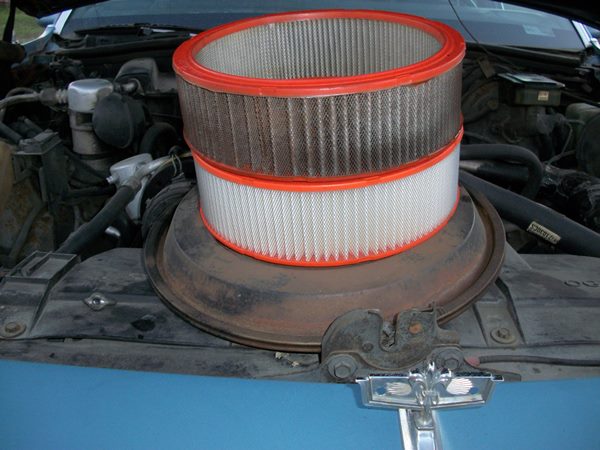

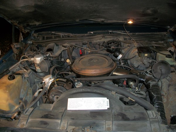

        I guess this should get thrown in about now. The engine compartment as purchased.

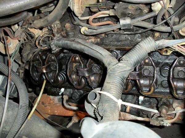

        Thought I'd do a little tune up...

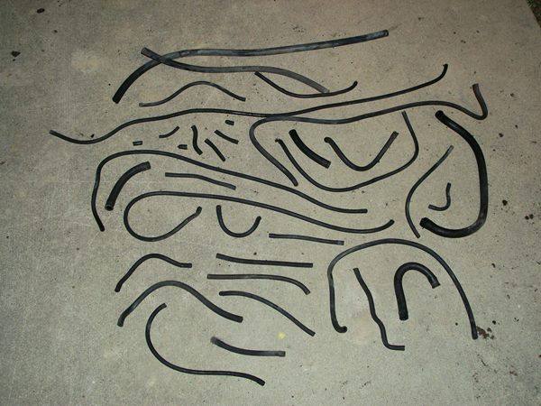

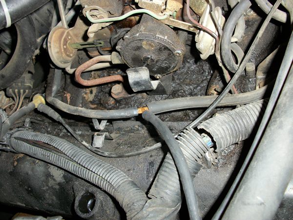

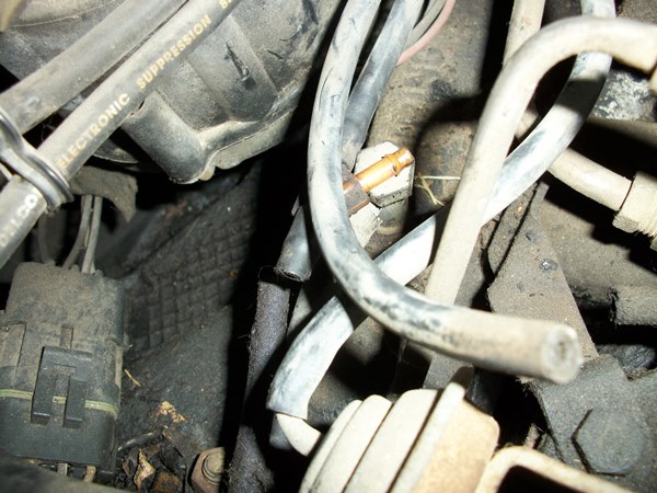

        Maybe replace those leaky valve cover gaskets. The oil was running onto the exhaust manifolds and smoking. It had been doing that so long that they (exhaust manifolds) were caked with heated oil. While replacing the valve cover gaskets I noticed the plethora of vacuum lines was in about as good shape as the tires...or maybe worse as some of the vacuum lines had eroded apart on their own.
        Thirty-two vacuum hoses later...
        How many are laughing?
        Do you see a pattern emerging?

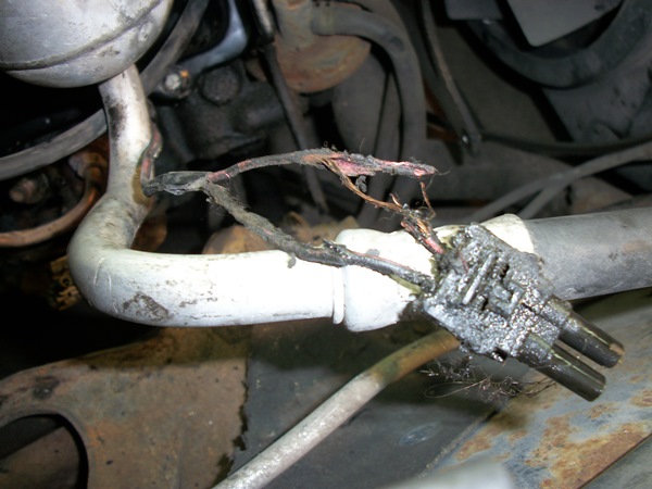

            A couple of pics to show the oil slick under the hovering confusion called emissions control and at least one self-dissected vacuum line.
            Then the lovely feeling one gets in their stomach when they see the evidence of long-term neglect...
            ...but wait, there's a glimmer of hope that the pesky "Check Engine" light can be turned off with some small repairs and maintenance.

                  hmmmm... I'm confused - are you replacing the vacuum lines? why?
                  still, neat car bonus now you have some selfies for the Christmas card picture
                    They were dry-rotted, cracked, broken, deteriorated, etc. It was all for not, but I have an abundance of spare vacuum line.

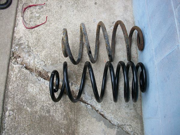

                      This car was equipped with air shocks as part of a towing package. There is a sticker on the door jam, like it was installed as a dealer add-on or some place besides a previous owners driveway. They both were totally blown when I got the car. That was the first parts group to get replaced. I put regular shocks on the rear. It always looked like the rear was sagging, like the springs were weak so I decided to put overload springs on it. It raised the rear some but not excessive, IMO. This is the difference in static height between the factory springs and the Moog cargo springs.

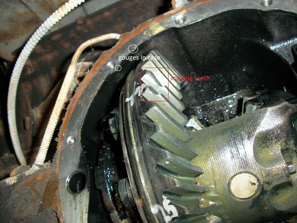

                        I don't know about anyone else but when I get a new-to-me vehicle I go through things to check their serviceability and state of maintenance. It was obvious this vehicle had not been maintained well so a basic fluids change and tune-up was high on my priority list. That's when I spent several hours on New Years Eve on my back trying to drill out the differential housing fill plug. It all started out innocently as a drain/inspect/fill routine. And this was the delight I was greeted with once the rear cover was off.
                          When you go to the salvage yard to pick up the new gear set grab a new cover and forget drilling out the old plug. That plug IS in the cover, isn't it?
                              No, it's in the housing. It's done, that was NYE 2011. Gears replaced 9/12ish.
