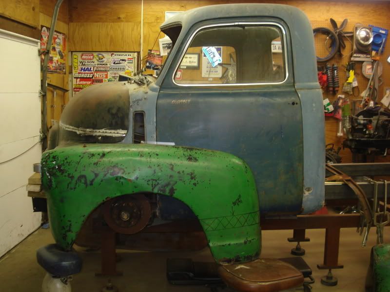

          Before she left however, I did get the cab onto the frame. The Astro has a pretty wide track and setting the fender on the tire shows it. The problem I have is I dont like appearance of the fender on the Dodge cause it has no "tuck" of the tire...it's to shallow if you look at the pic. It would also require alot of metal work to shrink the fender lip tighter to the tire size, which I was always aware of. I'm waiting on a reply about adapters to bolt 5x5 to 8 lug dually wheels which would pull the track width in somewhat for more tire clearance and get the look I'm after.
          All this waiting around and thinkin has me revisiting my chevy cab option. So much so that I went out today and grabbed a few peices and snapped some pics to reveiw indoors.
          The 1/2 ton cab and fenders/COE hood and doors combo would be lower than the Dodge. I have freedom to widen the track alittle with the fenders and again I have all the parts layin around.
          Gonna sit on it awhile....what do you guyz think/like???

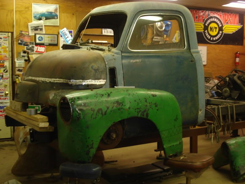

          This is about the profile...although I would still chop the top.
          I would shorten the hood to meet the fender line.
          The wheelwell is sized better, but I'd have to try to lessen the interior intrusion of the fender/door to get in the truck. Not sure which way the door would open, but looks kinda tricky to get in.
          Sorry...it's -5 out...I must have shakin. The leading edge of the hood is 44" wide compared to the 1/2 ton 30". I can narrow up the fenders to tailor my width of the truck better than widening the Dodge fenders to fit and look right.

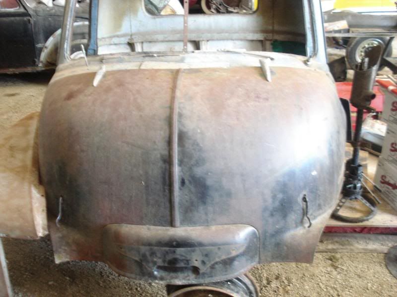

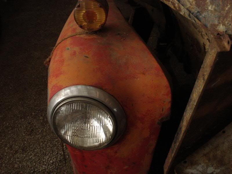

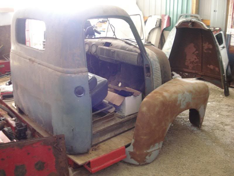

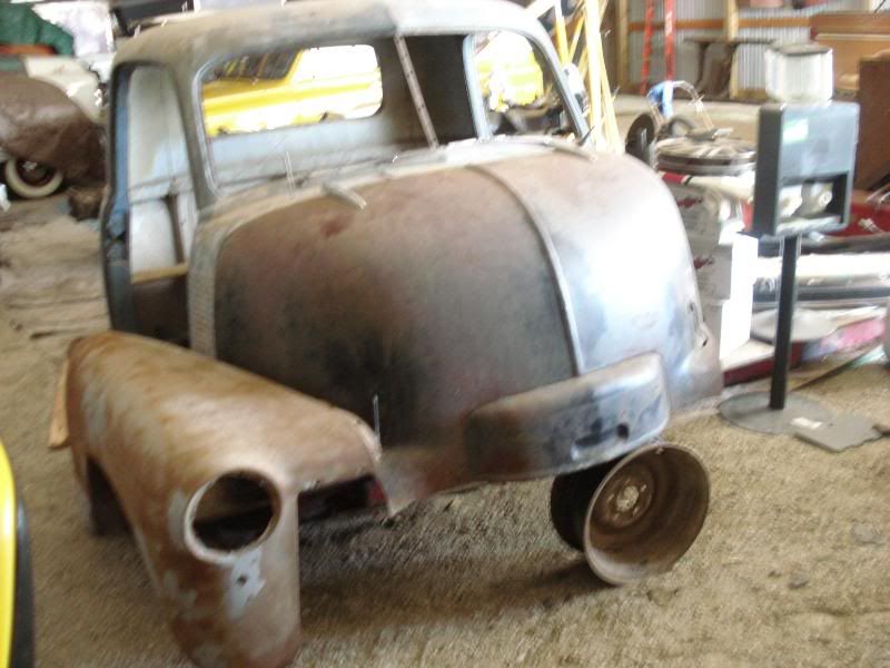

          Here's a real COE fender...notice its narrow up front.
          ...and the big trucks have big fender wells.

              That COE reminds me a lot of the FutureLiners.

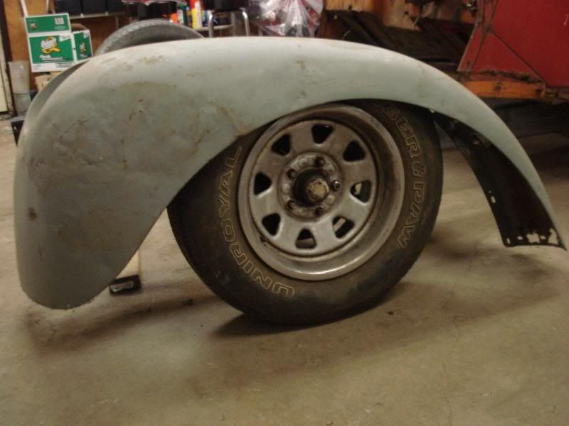

              Could you widen the cab and do the fenders more like this? Big deviation from your original plan, but that's what pops into my head.

                the dodge cab with the chop and grill just looks right the wheel opening your right fit to tire sucks
                you could do a suside door with the back edge of the fender atched to the door so it is out of your what when getting in and out {just brainstorming} i do dig the dodge nose and cab beter but the wheel opening kills it and ya metal finishing it would be a cock

                  I like the look of the Dodge cab and grille as well but I don't think the fenders suit the lowered look. I had to take a look at an original Dodge COE first: they look good in proportion to a large diameter wheel. I think the Chevy fenders look better for a smaller wheel/tire combo. What about putting the Chevy fenders on the Dodge cab, how's that for blasphemy? :P

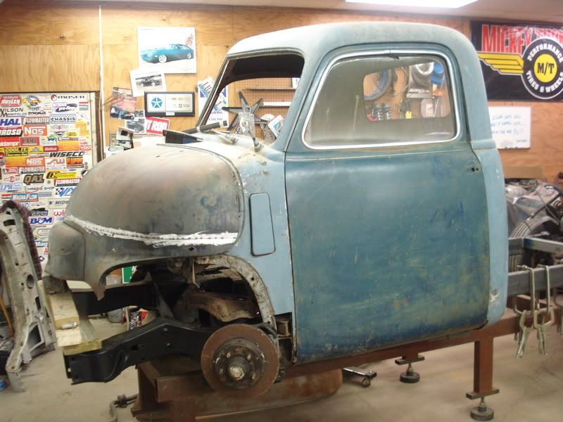

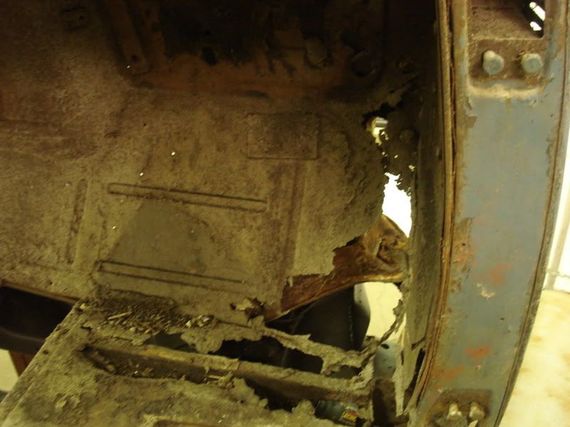

                      Well my time has been comprimised as of late, but I have somewhat of an update.
                      I'm certain I'll alienate a few for this, but I'm convinced the Dodge cab is best slated for a long wanted rat truck project I can make rails for than this project....and the fact someone on the H.A.M.B. is makin one that looks jus like it anyway.

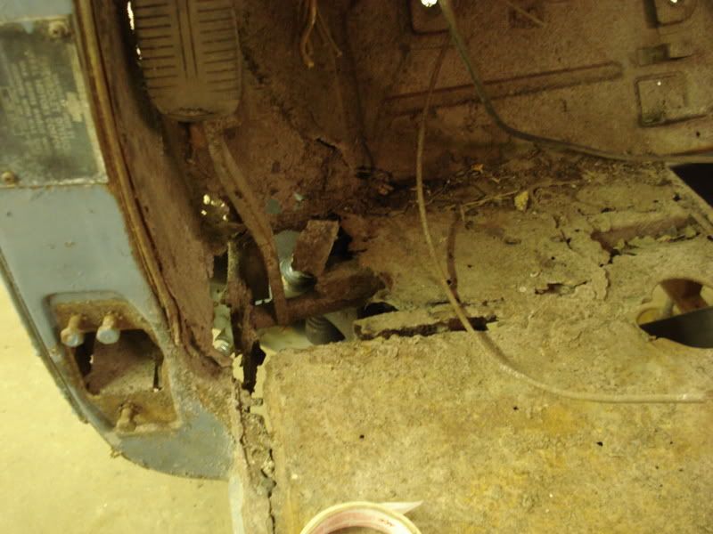

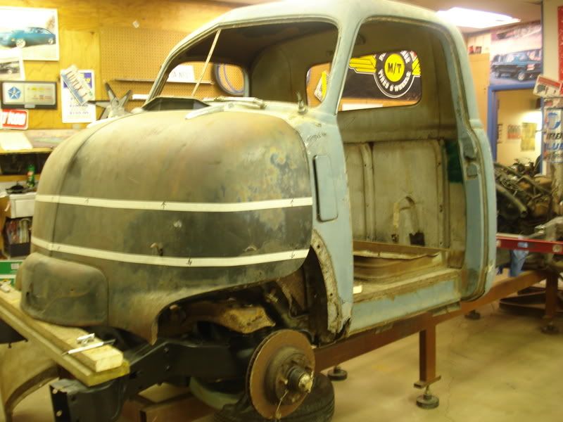

                      I grabbed an Orange Julius and pulled the Chevy cab out. The cab is rotted bad and would cost a fortune in time/money to save except for this application where all of the bad places need to be removed anyway!
                      Looks more like the rendering now too.
                      I've got alot more hackin to do, but this is what I have so far.
                      So I place the COE hood on for kicks...needs 8" removed from mid section.

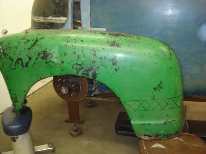

                      Started slicin up a pair of disposable fenders to get the right cuts before hackin a good pair.
                      The doors need to be tacked on so I can remove the dog leg, cause the cab needs to be pushed forward another 4"/5". At that point I need to make the cab mounts so the it doesn't tip forward anymore. The rear of the fenders need to be sectioned 3 1/2" to meet up with the door bottom which looks like it will put the fender on the ground when the truck is airred down.

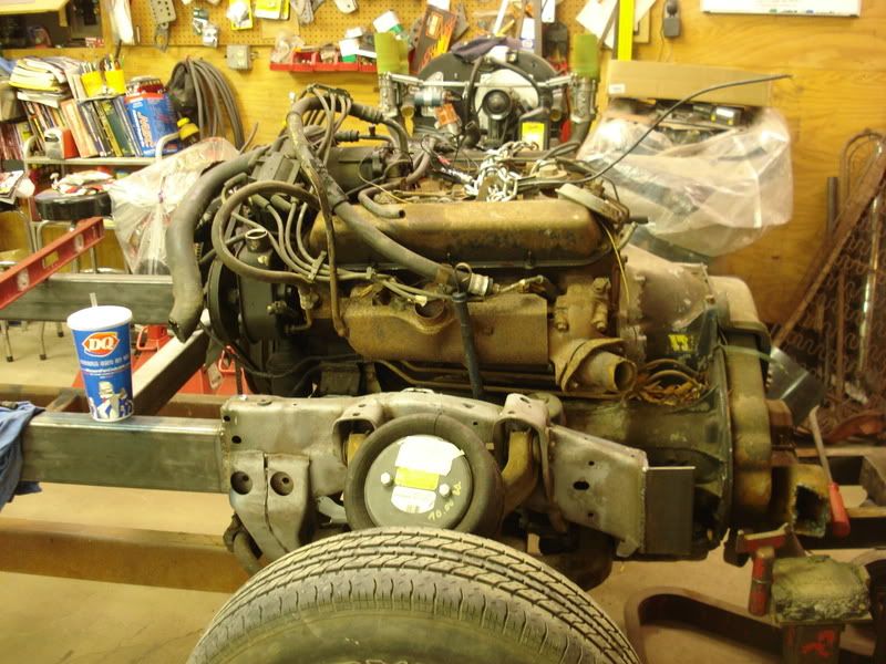

                      Set the junker in to see what the rear of the frame requires. Will be alot going on in a small amount of space with trans mount/exhaust/trailer hitch.
                      All for now...getting back to it after some VW time I'll post in another thread!!!
