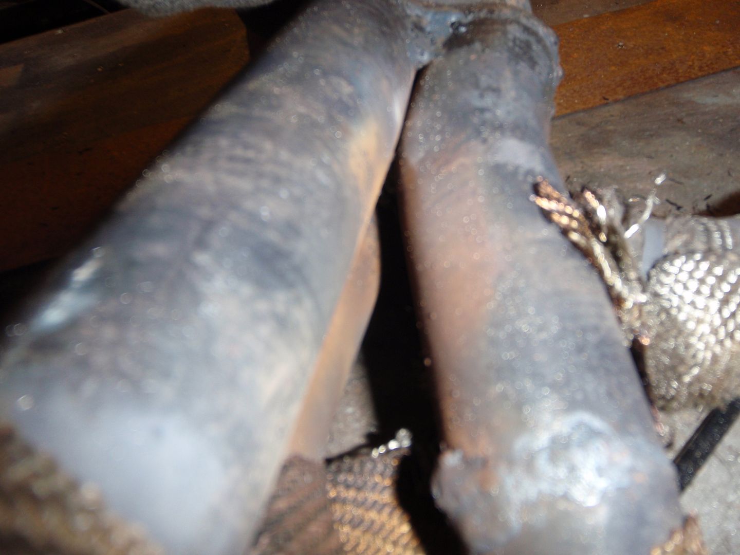

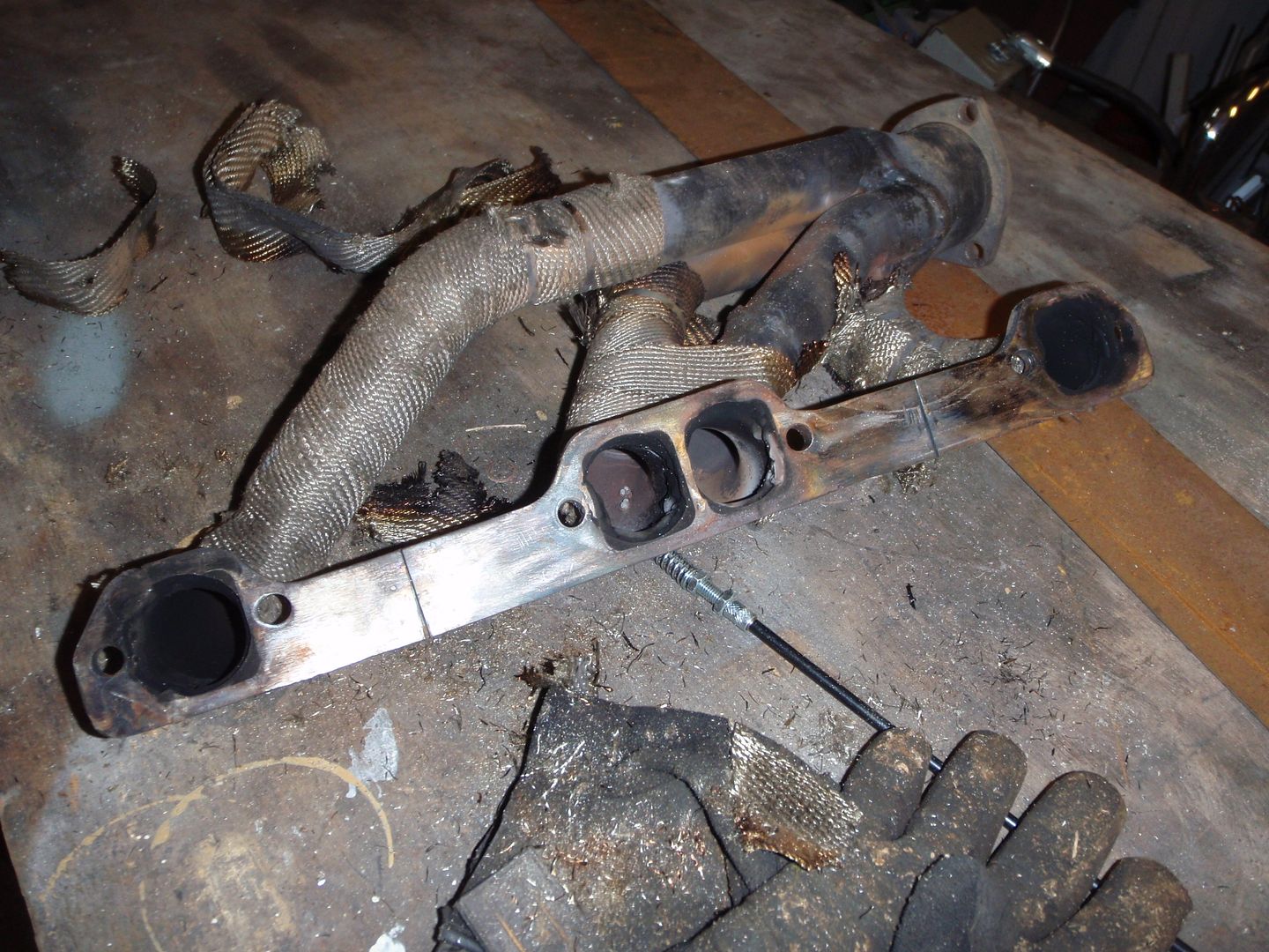

                        Headers, ugh!

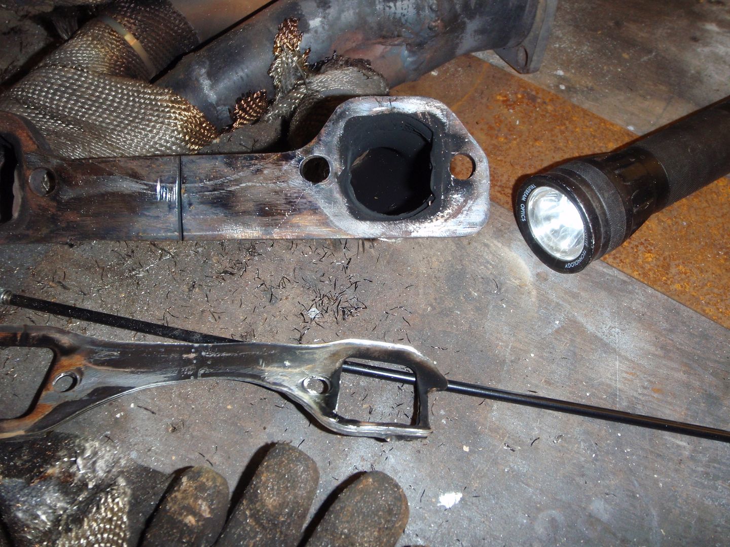

                        I 'saved' myself time and effort by buying what I thought was 18 ga stainless headers. They might be stainless, but I'm thinking they're chinesium... before anyone gets on my case about these silicone welds, this is to simply to reduce leakage until I can build new ones.... but since there's a deck, a trailer, a RV trailer before I have that kind of time to invest...
                        I flattened these last time I did this
                        you can see where they're leaking - that rust color comes from the exhaust leak
                        I do like Percy's gaskets - these are reuseable... and reused
                        silicone weld time
                        blowing lots of holes because they're maybe 20 ga.

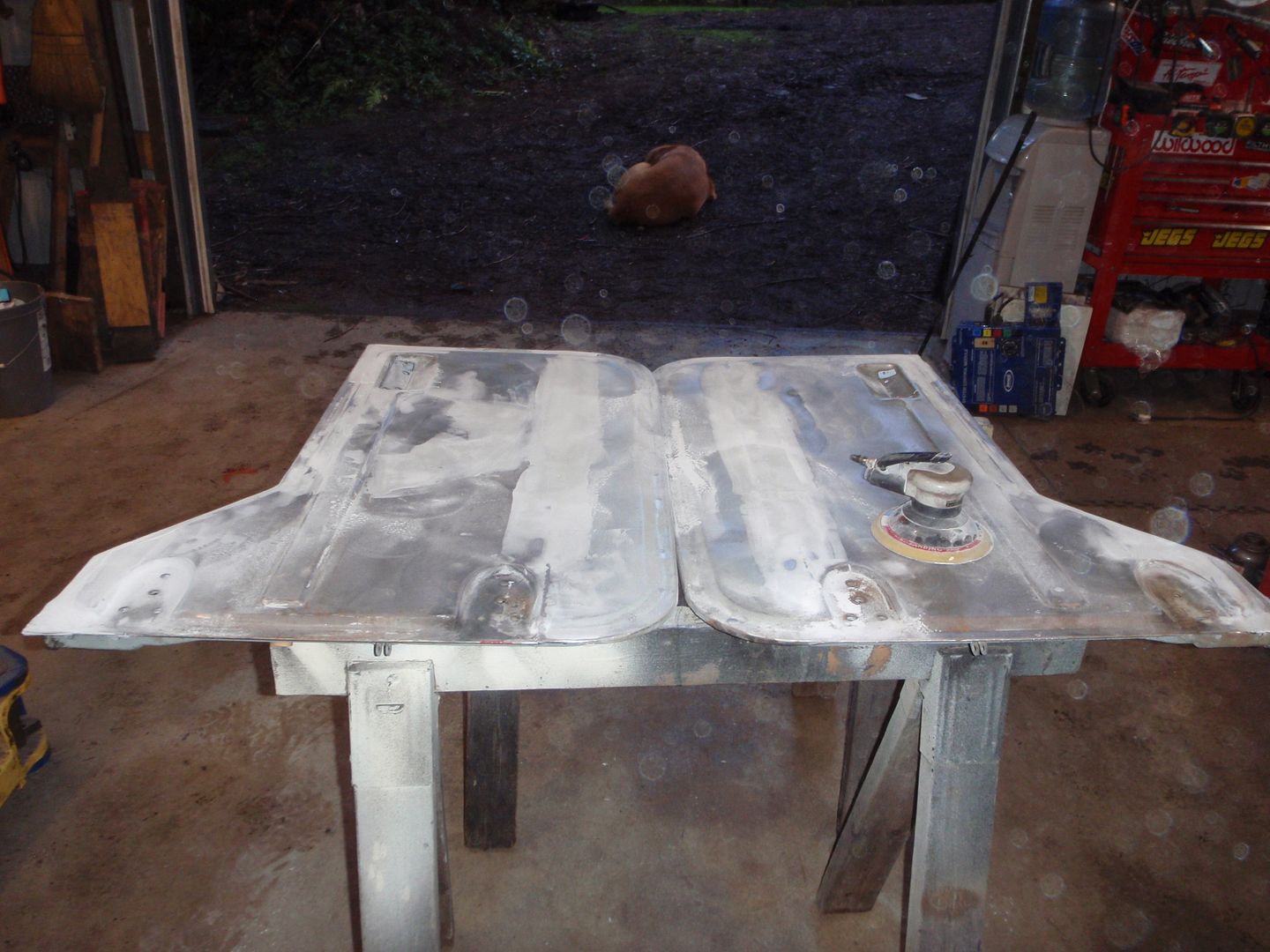

                        and more rust repair coming... but first
                        doors
                          • 31963
                          #1872
                          a bit more work
                          knocked it down
                          premature primer, but for a reason .... it's getting too cold to work on these so it's time to prime them and stick them into the rafters then pull them down when Spring springs

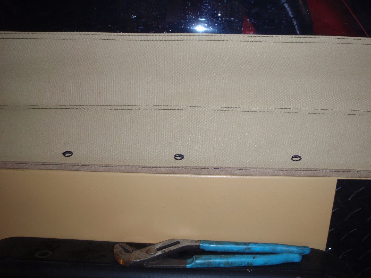

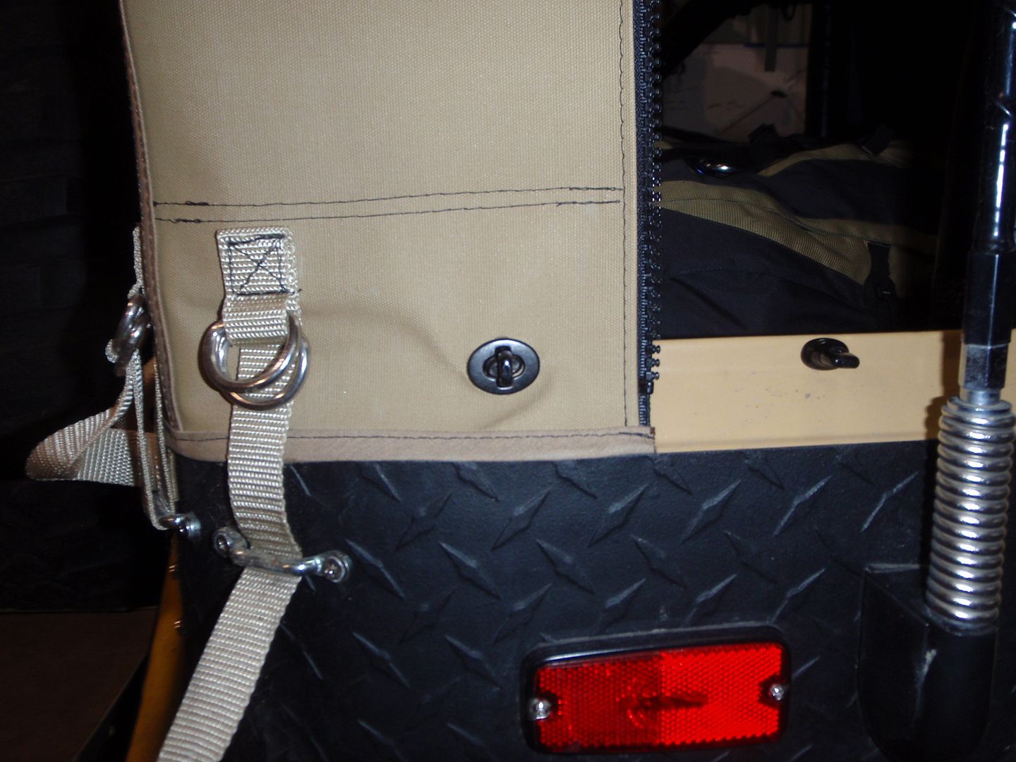

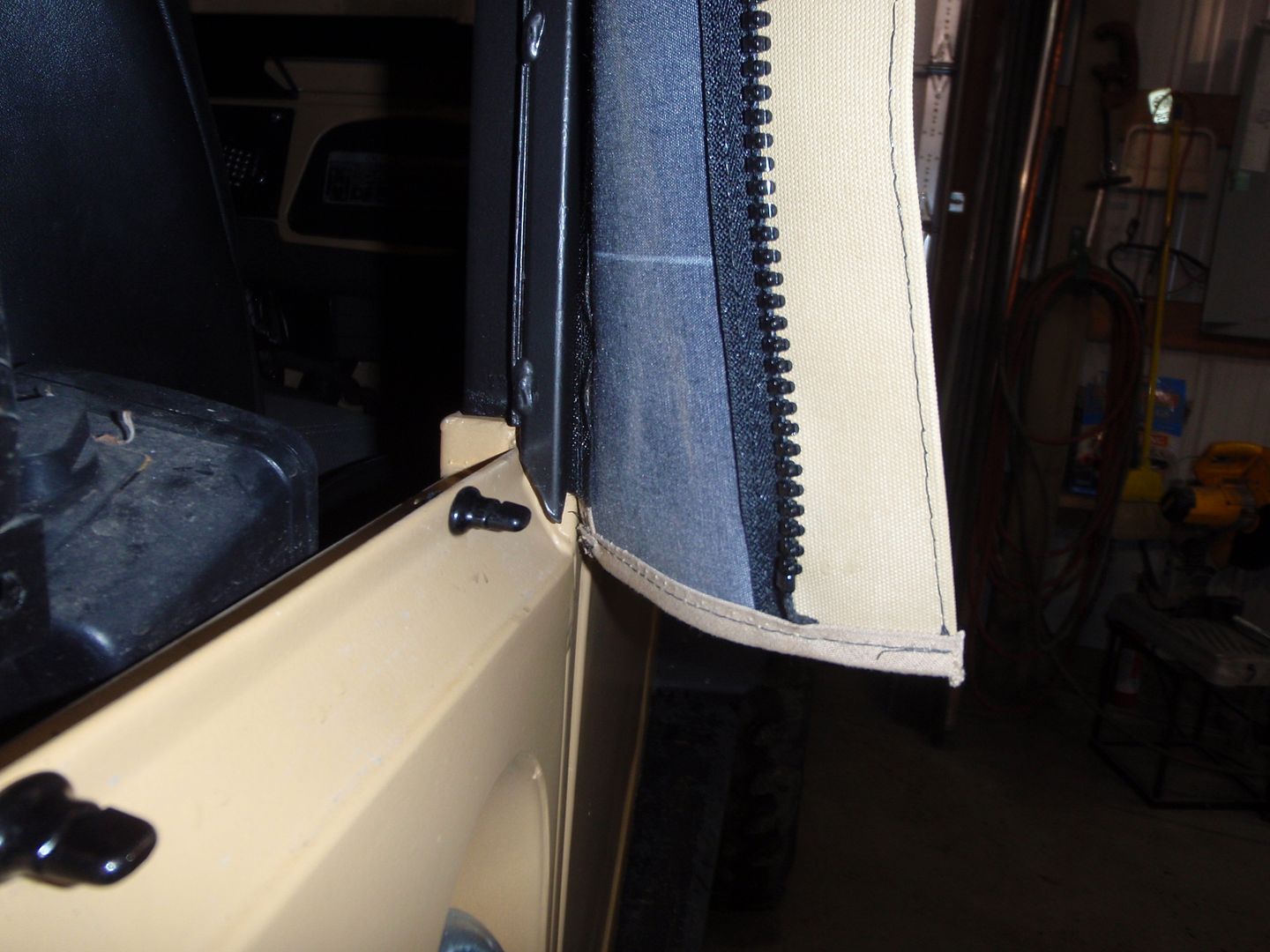

                              so it's time to finish the roof install.... was waiting for instructions, but got tired of waiting - which means it could be wrong, but it's not.
                              screw in the twisties
                              then take a deep breath and cut a hole in your brand-new, $1,500 top
                              and put the ring on
                              that was the first one... next round went a bit easier
                              mark the heads
                              then trim a bunch and install
                              finally a better plan... mark the heads as above, then use the backing ring to mark how much material to cut out
                              like so
                              by now, cutting holes is easy
                              punch 4 holes for the tabs
                              and hammer over using a block of wood as a dolly behind the mount.... easy, no?
