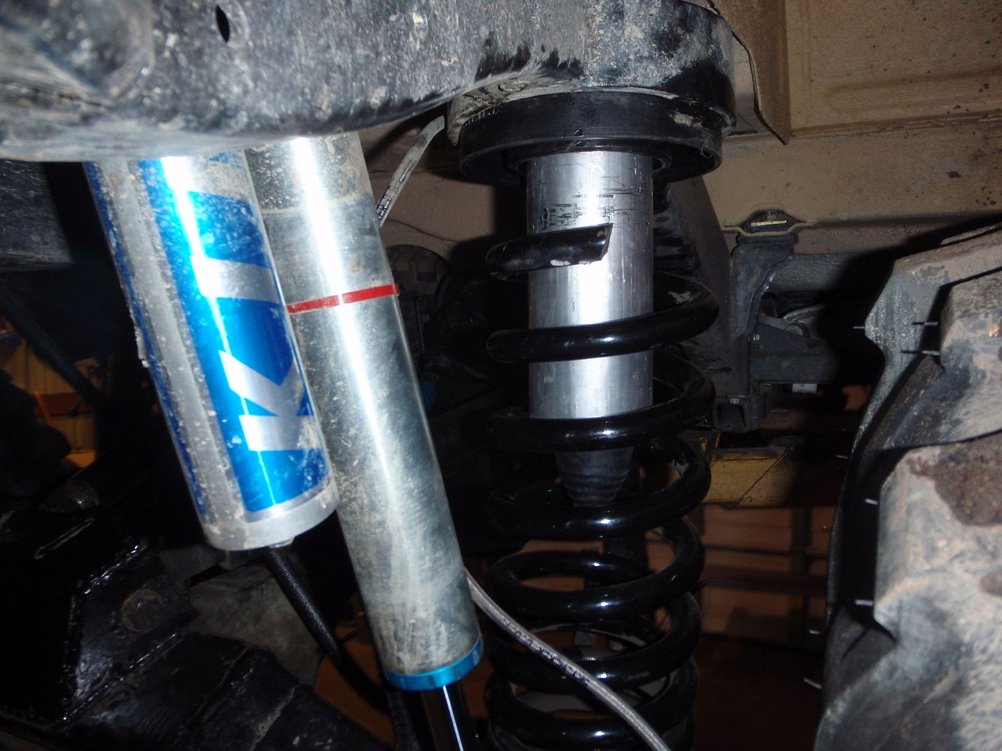

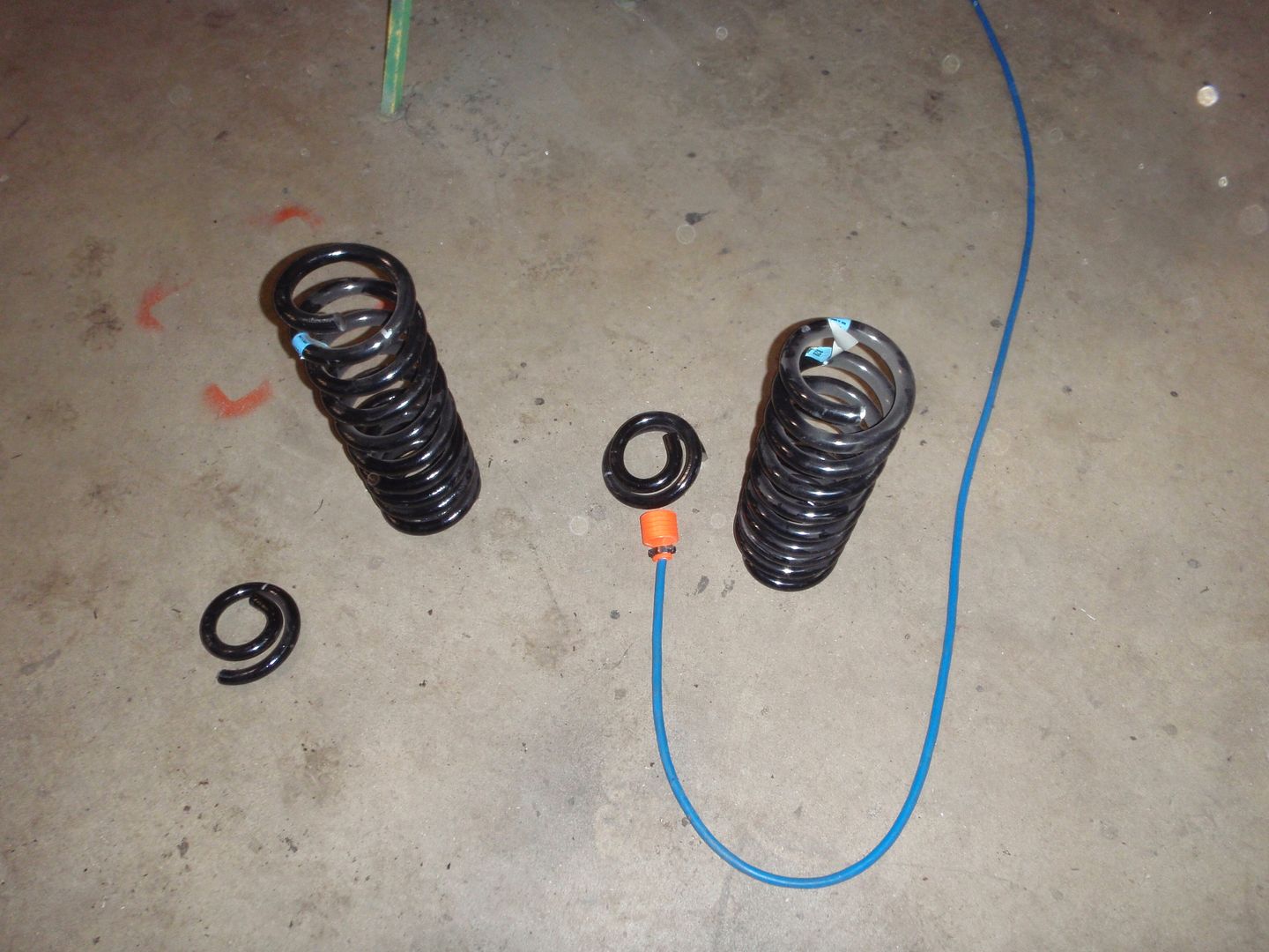

      so more detail work, these are late 90s F350 van front springs - right diameter, increased wire size, and progressive...
      fixing the land cruiser lean by unequal cuts to bring it down to the right length
      I need to tune this a bit more... but it's close, very close

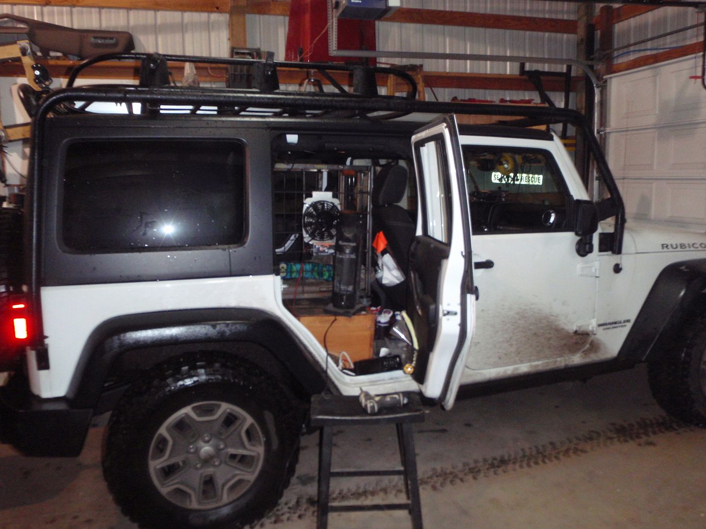

      but then I got interrupted by my wife's Heep - she filled her inverter and a plug full of water... electric devices don't like water (who knew?)
      but we're back

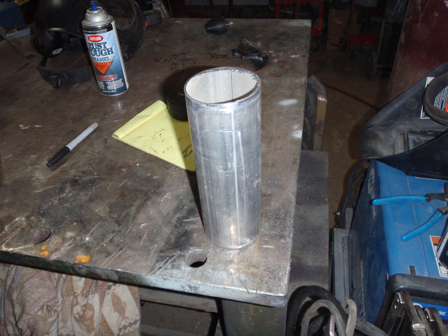

      so I added a 2" spacer for a bit of insulation from noise and put it back together... now I have 5" travel (middle of the travel) for the rear and the rig is dead level front/back
      for those counting, it was 24" with 31" tires to the bottom of the rocker panel. Now it's 28 with 38.5s and a whole bunch more travel. It's ready for 40s, my wallet isn't ready for them, but finally....

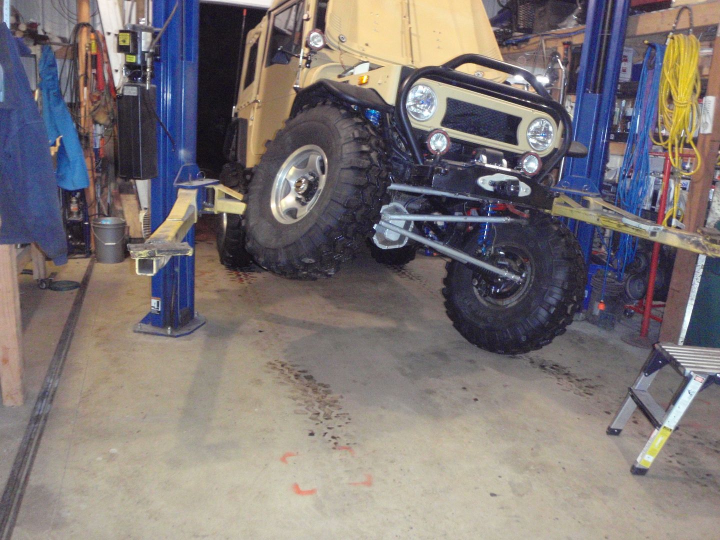

          so back on the ground it had a land cruiser lean, but the other way... equalized the front coil overs, still no joy.... so time to make both rear springs level
          as you can see by the picture, the first strap just could hold the axle twice so time to do something a bit more creative
          and install the bump stop too
          no more lean.
          and it drives excellent. I still need to reset the castor (again) because along with an issue with the driveshaft angle, they changed the castor to the point where it's darty... no big deal, just a quick adjustment

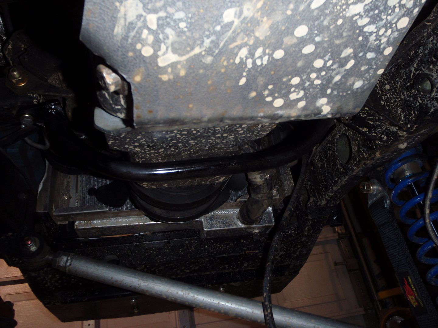

              So as you know, I went wheeling yesterday.... beside not taking enough air pressure out (18 vs. 8)... things went okay. Well, okay if you consider almost rolling it at 70 mph. Pulled off the freeway and the steering box was loose, again.... on top of this, I've been really needing to tie the frame rails together since all of the force is on one rail... so that was today's work
              I suppose if I was doing a full hard-core vehicle, I'd just put a mid-plate in... but I like not rattling fillings out so the solution had to be a be less caveman
              first I tied the motor mounts together - but that's pretty weak considering it's only bolted in
              so I added a Y member
              not a lot of clearance, but my solution (if it hits, and probably if it doesn't) will be move the track bar. It's short, it's on a high-arc and now I realize I can lengthen it and put it on less of an arc which should make 100 mph less scary
