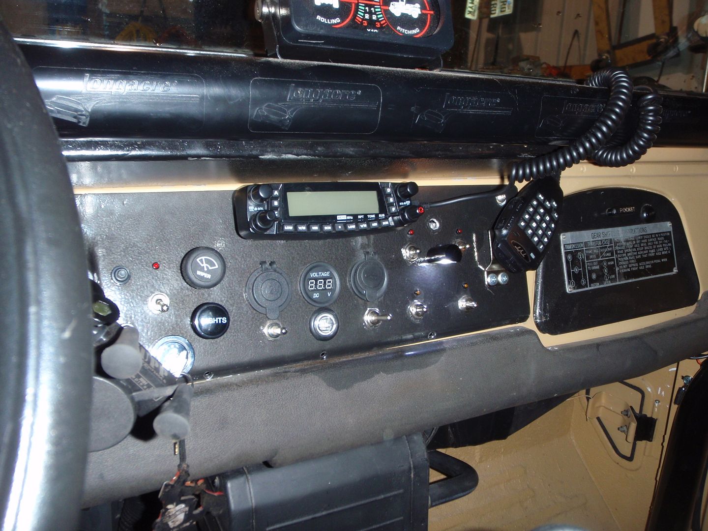

                              I cleaned it, and now the alternator doesn't work again.... that said, I'm not 100% sure this alternator was good in the beginning... I'll put the other on tomorrow night. That said, there will be questions of friends about why.... I'm seriously considering running the charging wire back to the battery or running a one-wire and dealing with its no-charge-at-low-rpm issues....
                              (random picture)
                              so in other news, I added some dash lights
                                • 28463
                                #1920
                                A bright idea! (Couldn't help myself)
