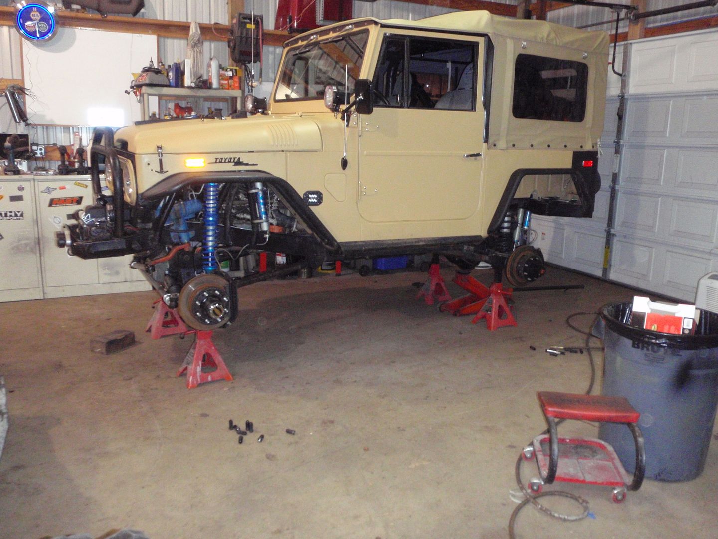

                              #1934
                              Spare removal system completed
                              I'm quite sure there were 2 billion billion billion bolts - all needing to be tightened evenly...
                              dynamic weight inserts here
                              dynamic weights
                              this is a first for me, so we'll see if I'm next fishing them out with a magnet
                              hmmm, not too shabby
                              so after a bit of trial and error - I figured putting taps in roughly quadrants would help... it did. A lot
                              so light it doesn't even touch the ground
                              and there it is.
                              a bit wider track, which is a bit unfortunate because I think I'm on the wrong side of the line to do the narrower trails... ah well, it does look good and gives me a better turning circle.
