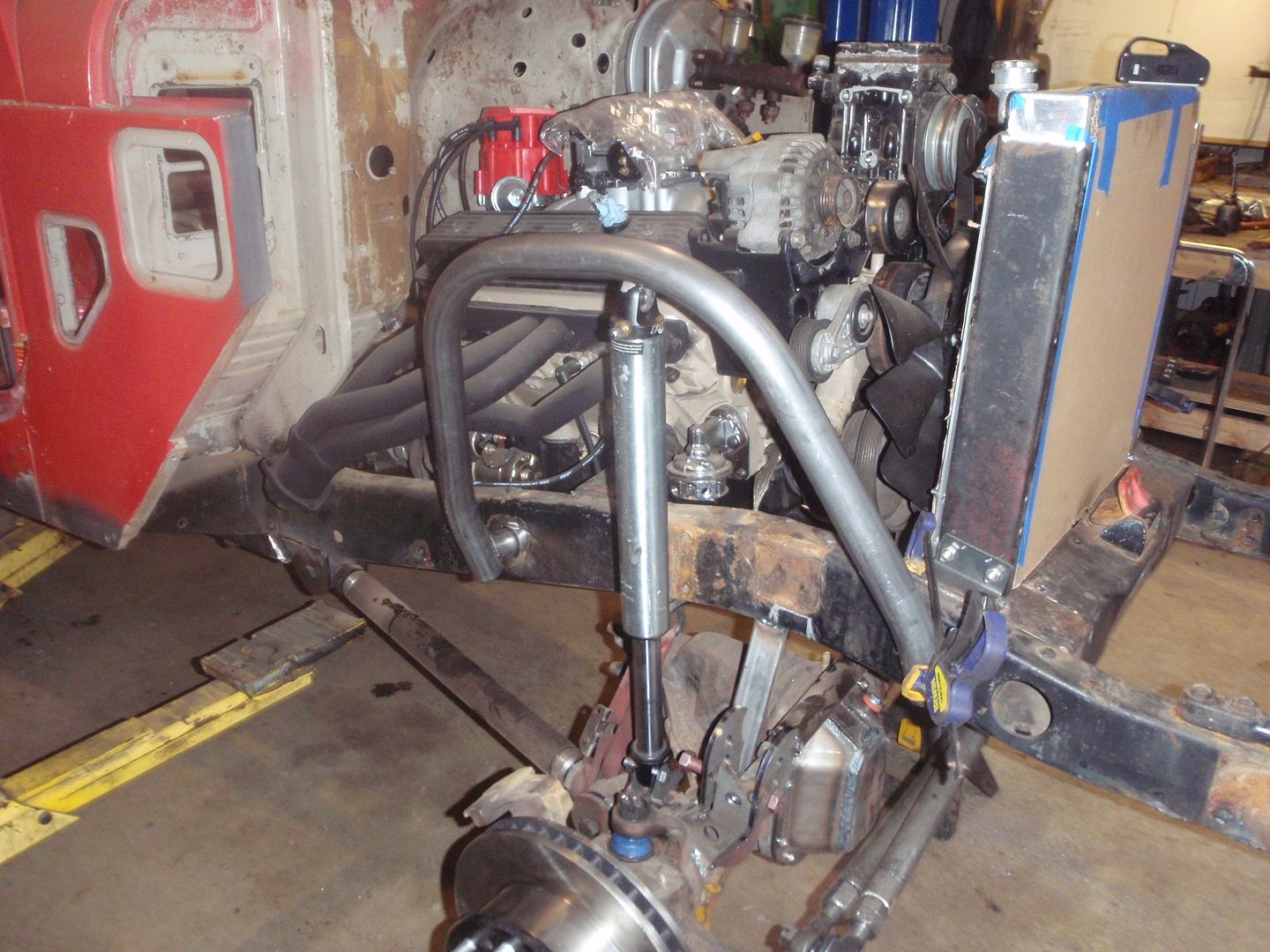

                      #460
                      yupdate
                      ride height
                      here's where things started... note the spring is upside down
                      after a bunch of cutting and changing, here's where it ended
                      I still have to put a plate under the bottom of the spring, but that adjusts/fine tunes ride height, and until the front is completely done... I don't know exactly what that is.
                      and I tacked the brakes on
                      flex

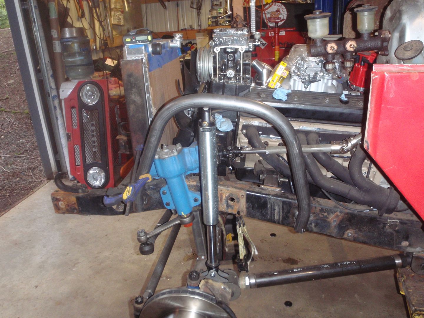

                      now to the front
                      for about 10 reasons, these brackets don't work
                      so time to build some hoops
                      kind of sort of where it needs to be
                      this is round 2
                      mounting tubes
                      round 3 (note the kick in on the bottoms)
                      tight, yet plenty of clearance
                      I have a friend who works at a laser cutting shop - I had him cut these out for me
                      an entire sheet of them.... quite handy
                      there we go, using the air shock as mockup
                      and someone needs to mention to the seller that 8" is not 12" .... they're 8" air shocks (which I figured when I bought them, but for the price, why argue?)

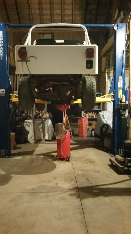

                              #464
                              Tanks!
                              On a slightly related note............if you pressure wash first, and let some water drip on your shop concrete floor - cleaning up the spilled ATF is much much easier as it floats on top of the water.
                              Just FYI.
                                • 32052
                                #465
                                Tanks!
                                Just FYI.
                                it's also a really good way of seeing how good your balance is.... an ice skater, I am not
