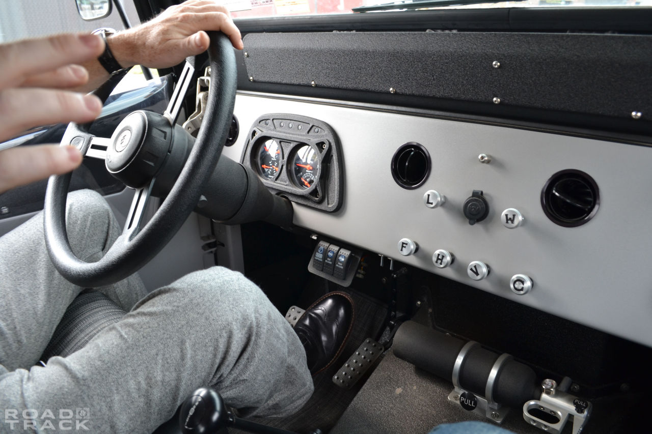

                      in other news... this is interesting (ICON)
                      I really like the use of the spare-tire clamp for the windshield but I'm still not convinced that knobs are the way to go. On top of that, removing the lower dash pad doesn't seem like a terribly good idea.
                        #896
                        Is it just me or is that roll bar on backwards?
                        That multi-gauge panel is pretty cool. Little busy with the black face thing, but the gauge part is neat.
                        All that work and then shove an AutoZone style add-on rocker switch thingy below the dash right where your right knee will hit it? Really?
                        Personally I like old-fashioned heavy-duty stainless steel toggles. The ones with a nice audible "Snap" when you flick them.

                          I don't get that - $120,000 (or more) for an ICON FJ44, and they couldn't come up with custom switches?

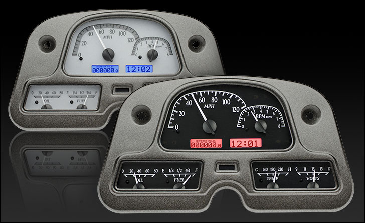

                          what I don't get is why they don't use these (like I'm doing)
                          not busy, works with electronic speedo sender, and is easy to read.
                            #898
                            Now those I really like!
                            Wonder if they would be compatible with the '94 Chevy truck harness? Inputs from computer....hmmm must research.....

                              cool part is, if you compare it to buying separate gauges and senders, it's quite a good value.
