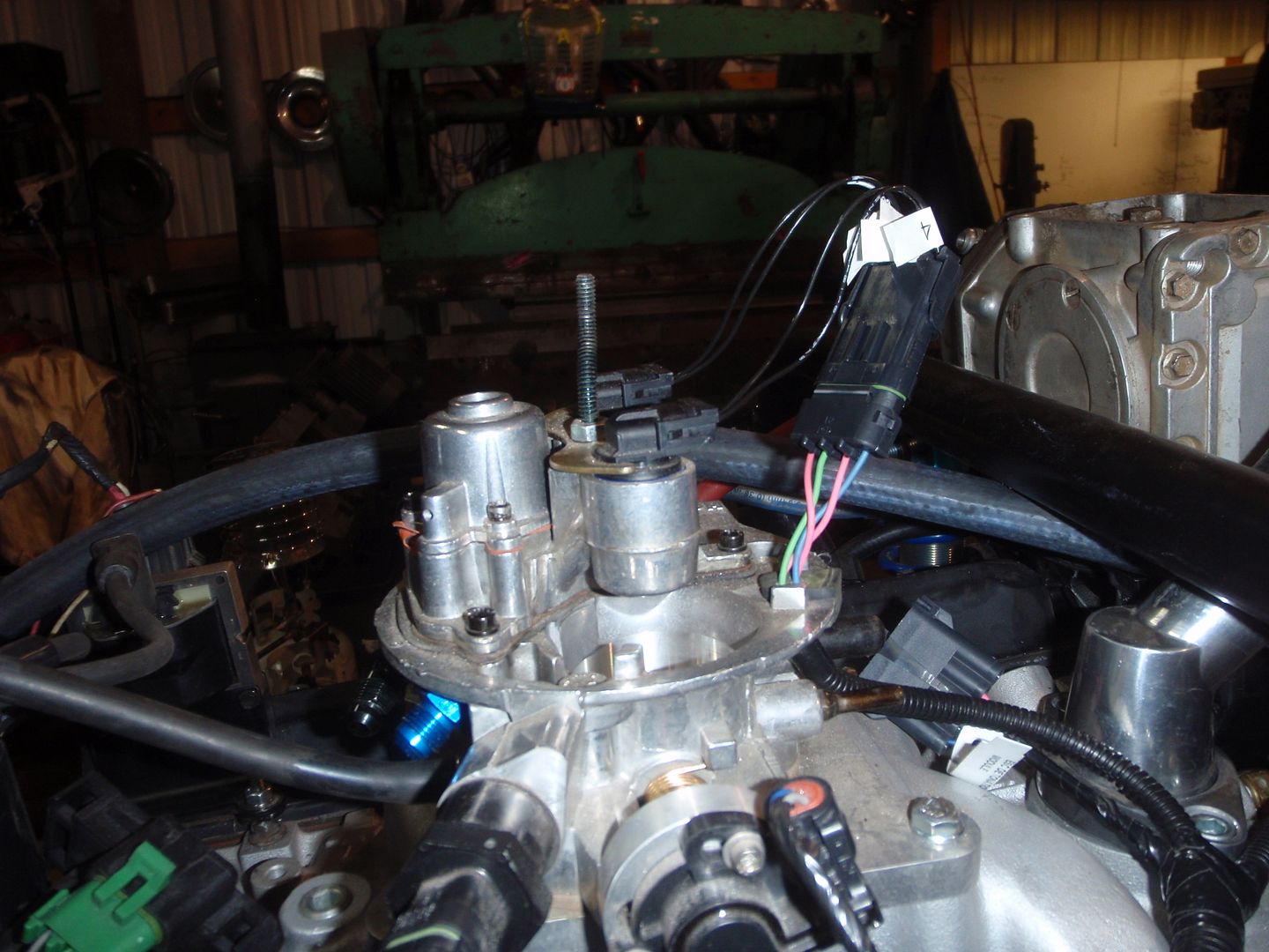

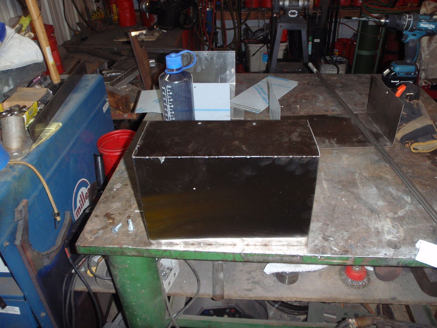

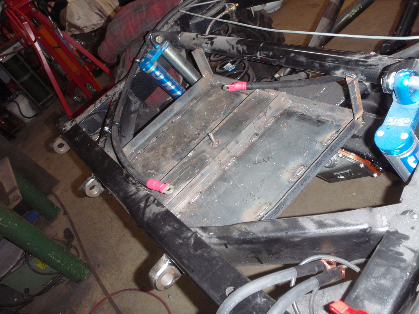

      stainless bolt welded to the battery tray....
      stainless box which has nothing to do with this build

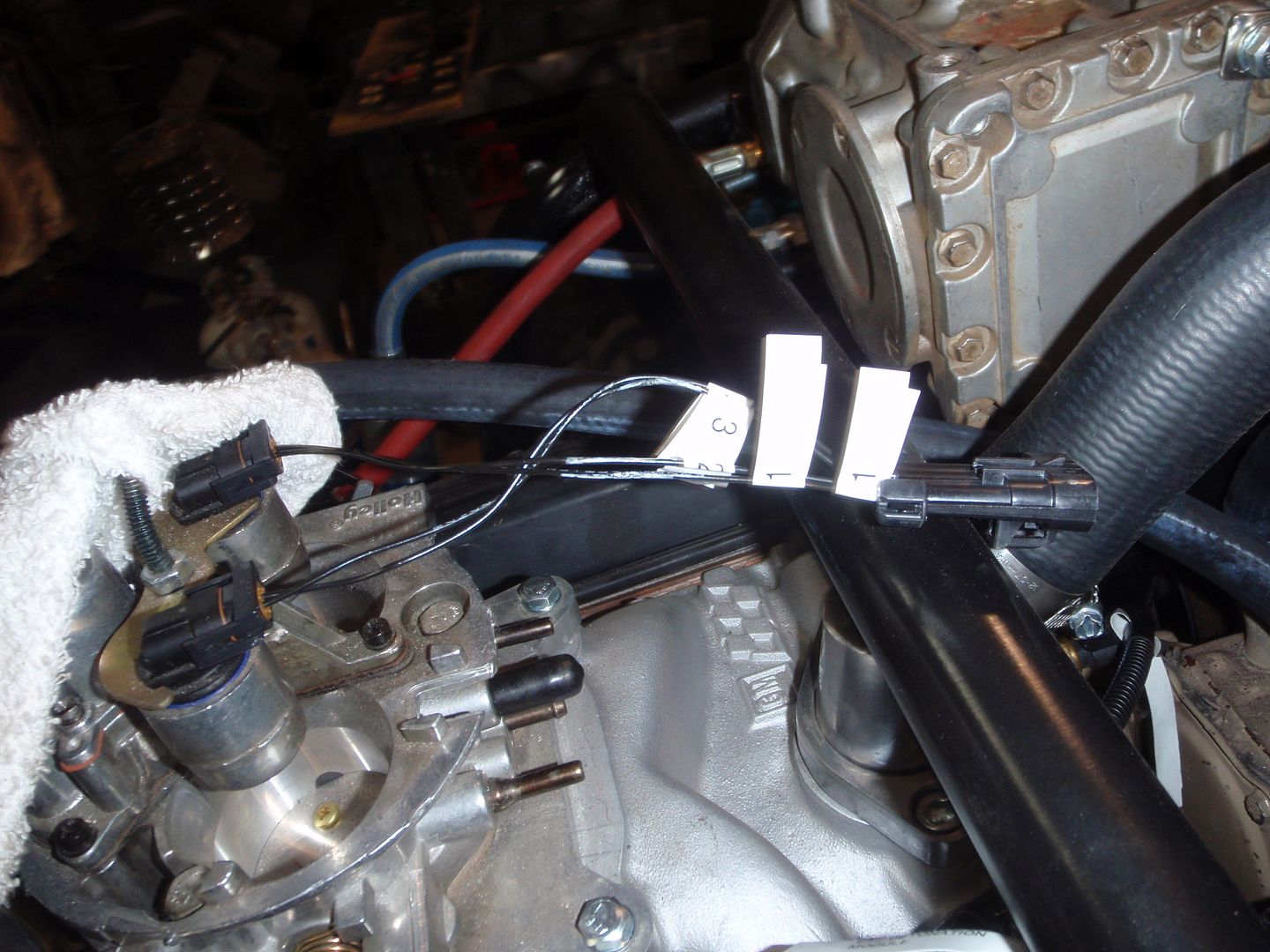

      according to the instructions, these wires are color coded... yeah... good thing I have a label machine
      so I cut off the newer connection and used a delphi connection on both sides.... now the injectors should work. I shudder to think of just how many things have to work for this to fire....
      that said I am getting better at these connectors so perhaps all will be well.... it's possible, but if it is perfect, I won't be playing the lottery every again because I'll have used up all my luck

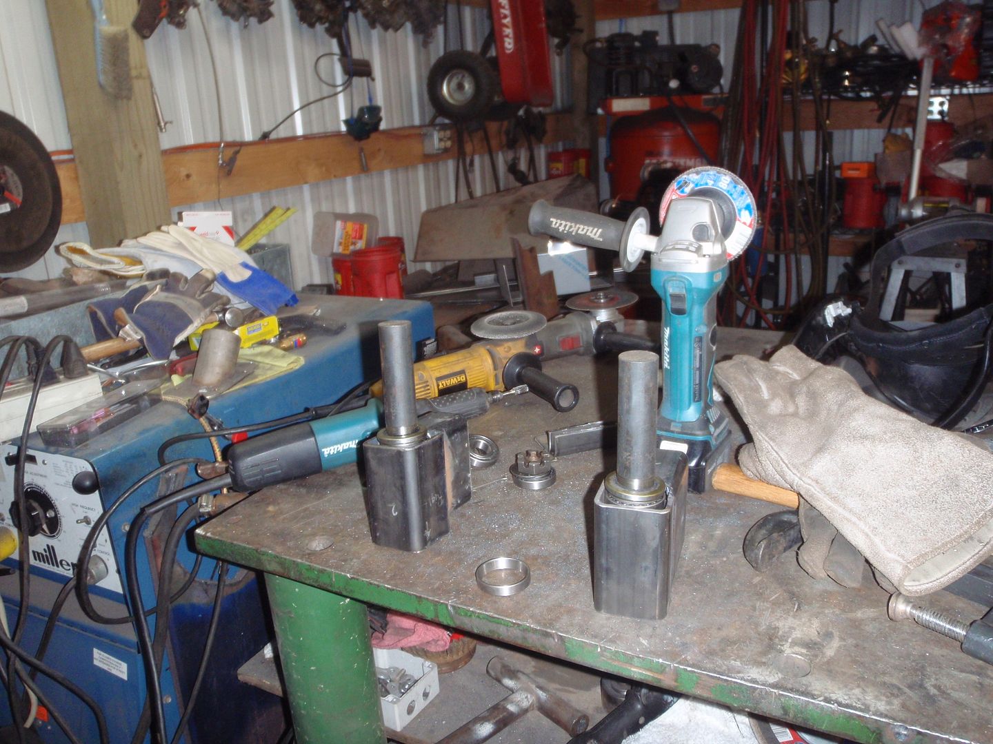

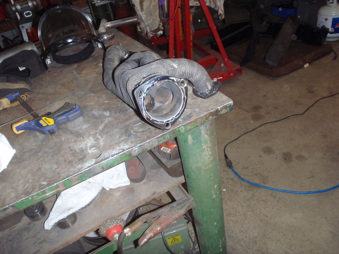

                  exhausting work

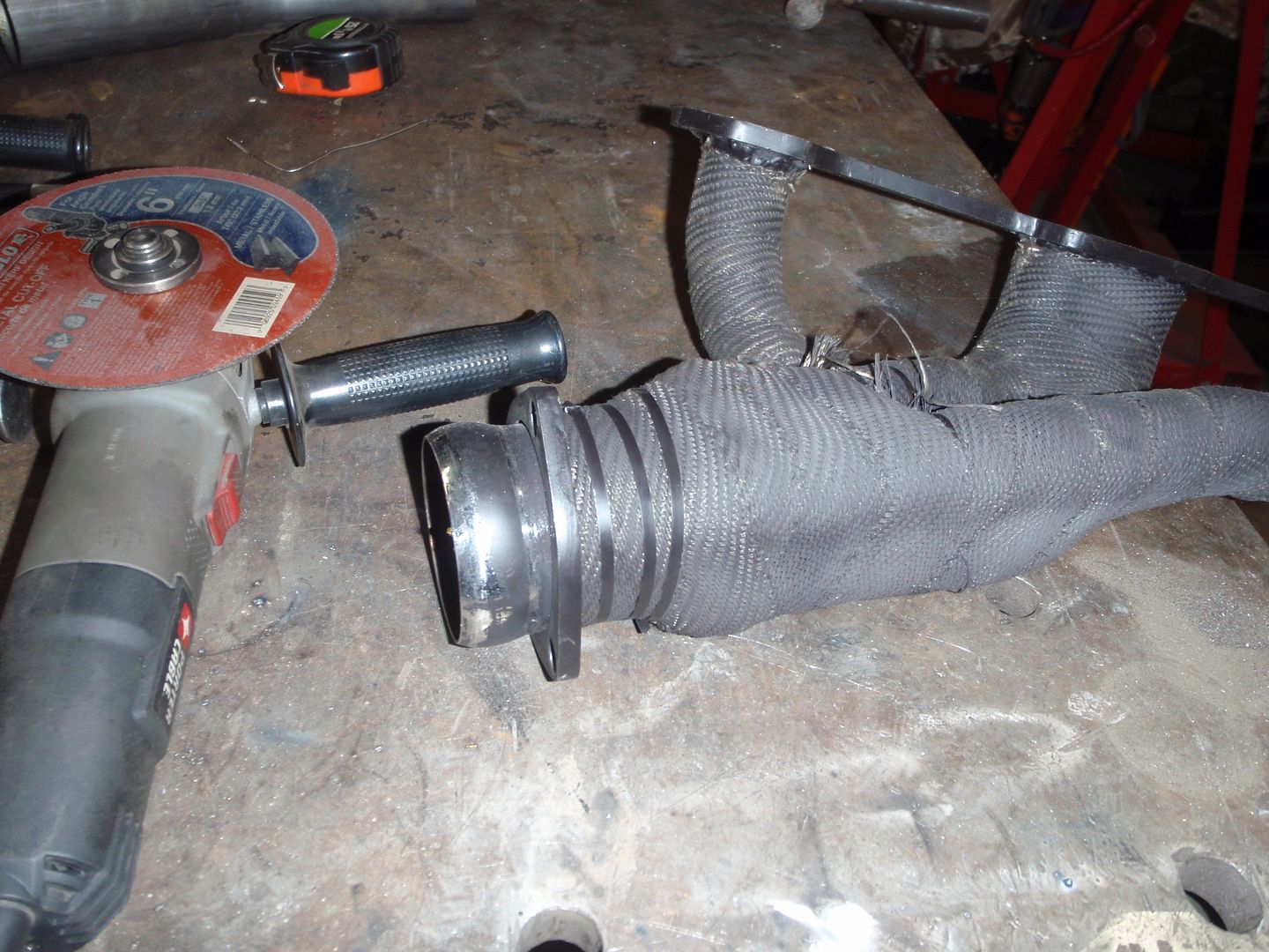

                  reminder, it looked like this
                  now this
                  with some welding on the header as well

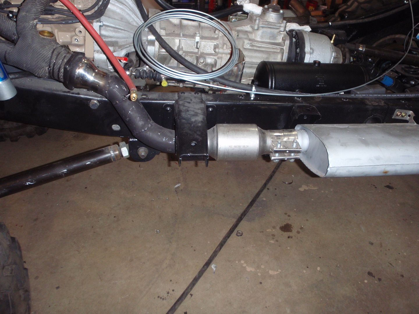

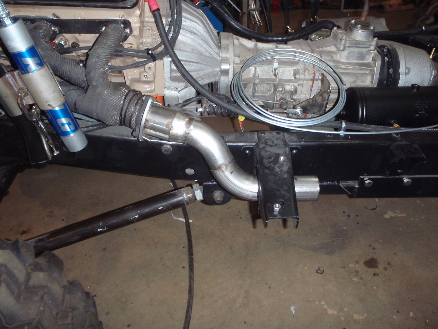

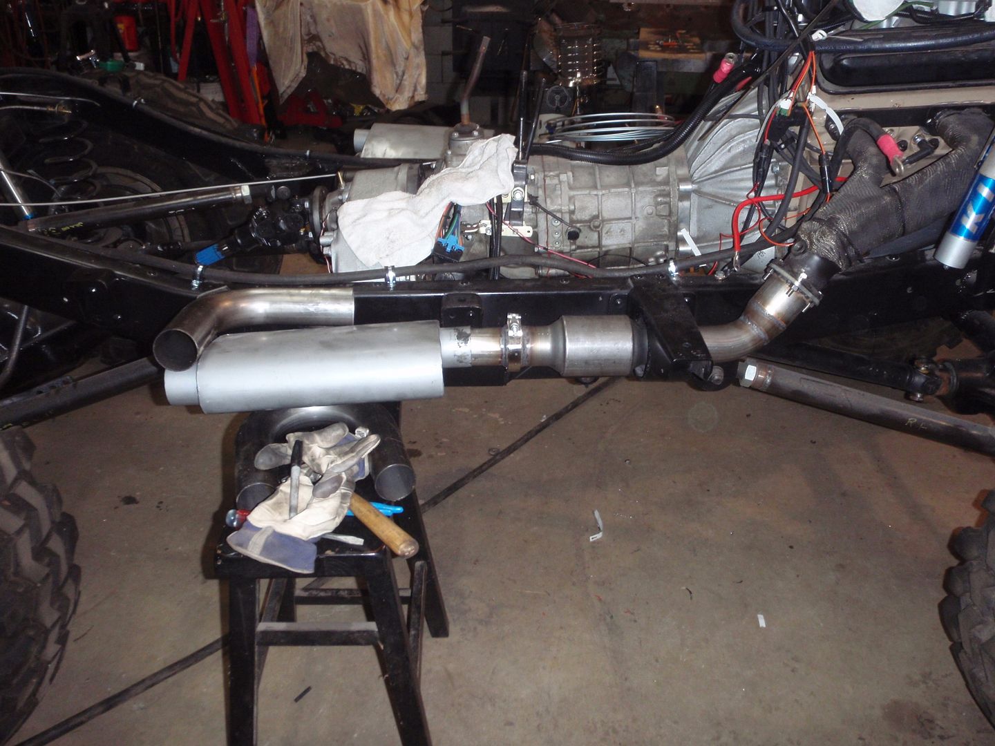

                        getting closer to body-mount
                        header mod, take 2
                        some cutting and fitting
                        and there it is

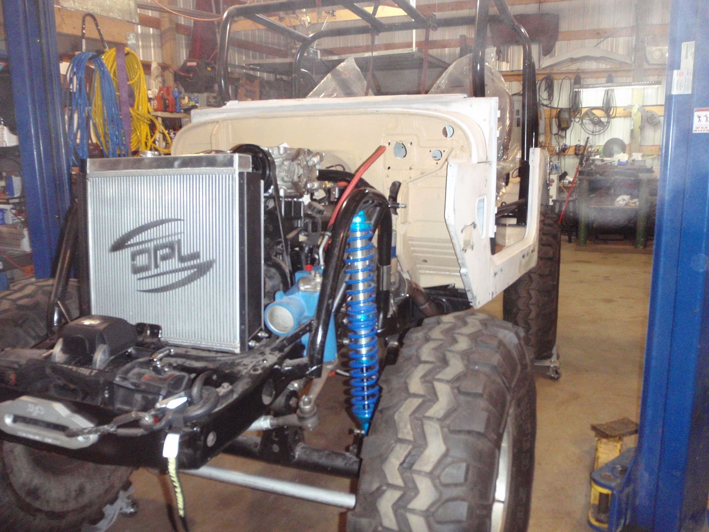

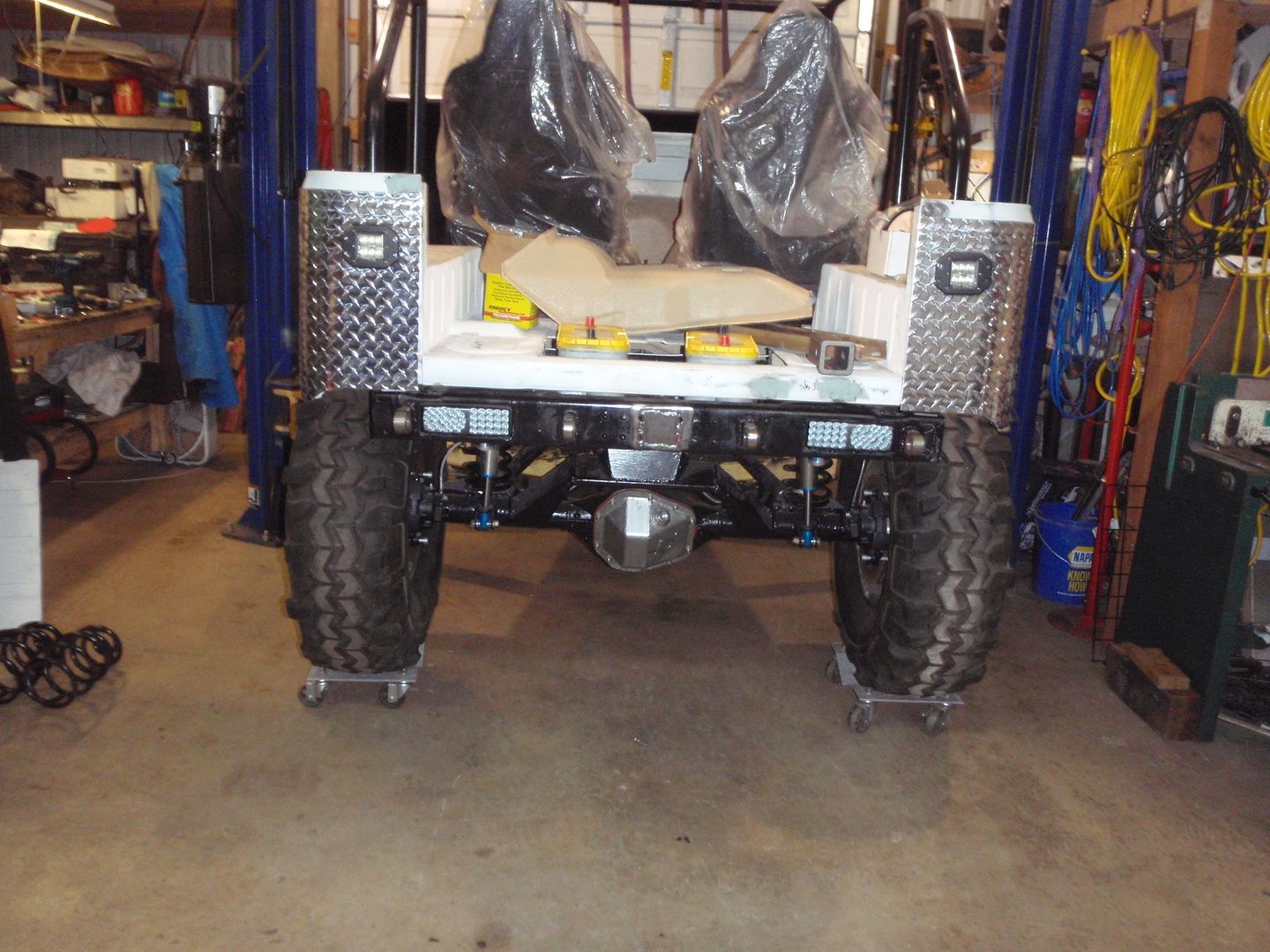

                        body back on, I could attach it, but it's so much easier to paint it on my body-dolly that I'm going to wait for it to show up back on my doorstep and finish some more of the minor stuff... like the tire carrier and rear tail gate....
                        so the goal was 4" up travel in the front and back.... 7 1/2 up front at the moment and 2" back.... fortunately, I can' solve the back pretty easily and the front won't be so tough either... just get some 175 or 150 lb upper springs.
                        • Russell

                          #1047
                          Trying to understand how that works. Does that mean. It is sitting higher than you want now? What spring does it have a now 200+?
                            • 31963
                            #1048
                            too high in front, too low in back.
                            the current springs in the front at 200# - I need to change the upper one to 150#... but I'm only going to change the back at the moment to get it close to level.... spring and shock rates are the very last thing to tune.
                              • 31963

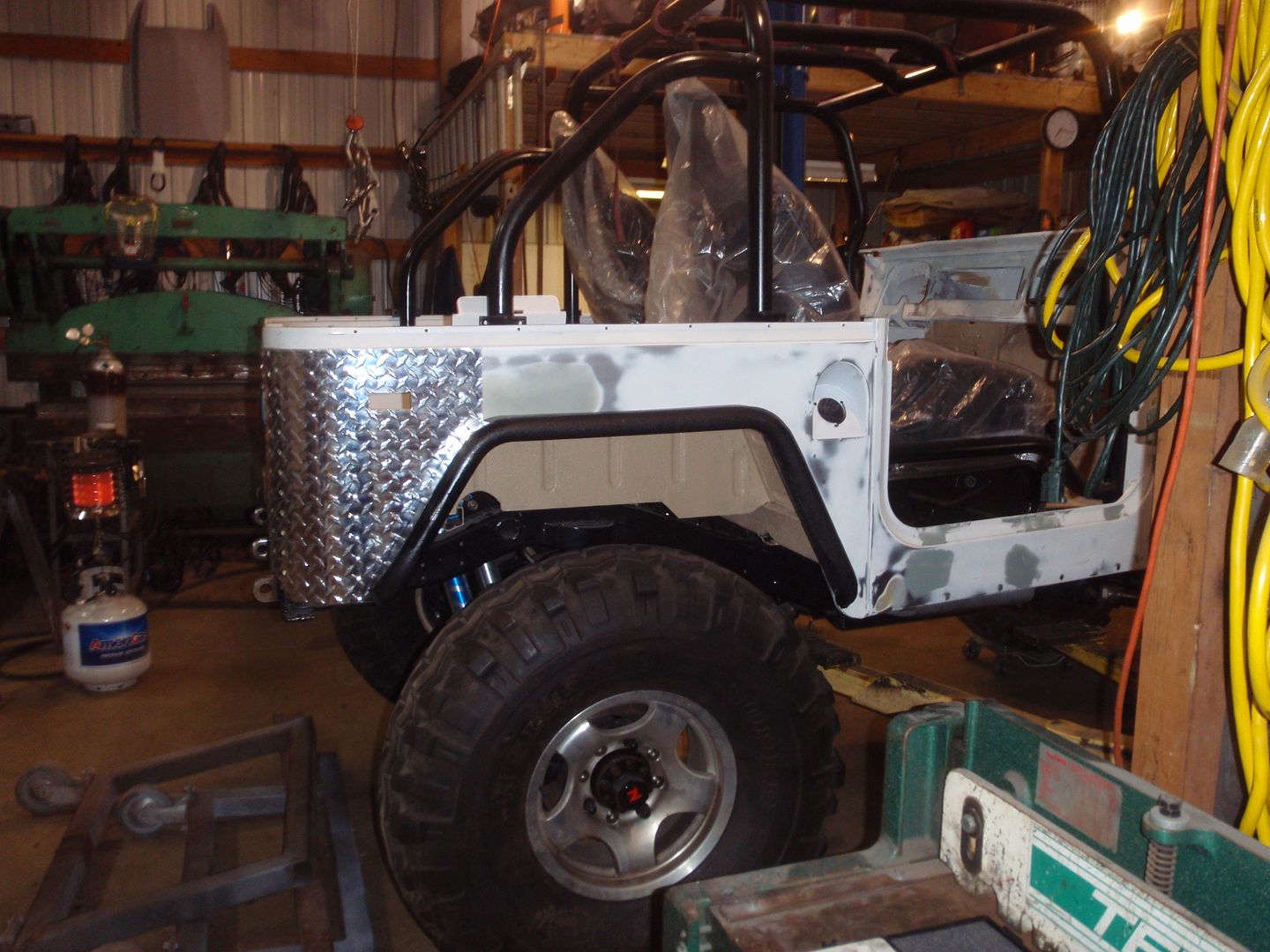

                              I changed the rear springs so it sits level...
                              still arguing with the shock folks about what I need for springs...
                              the shorter flare
