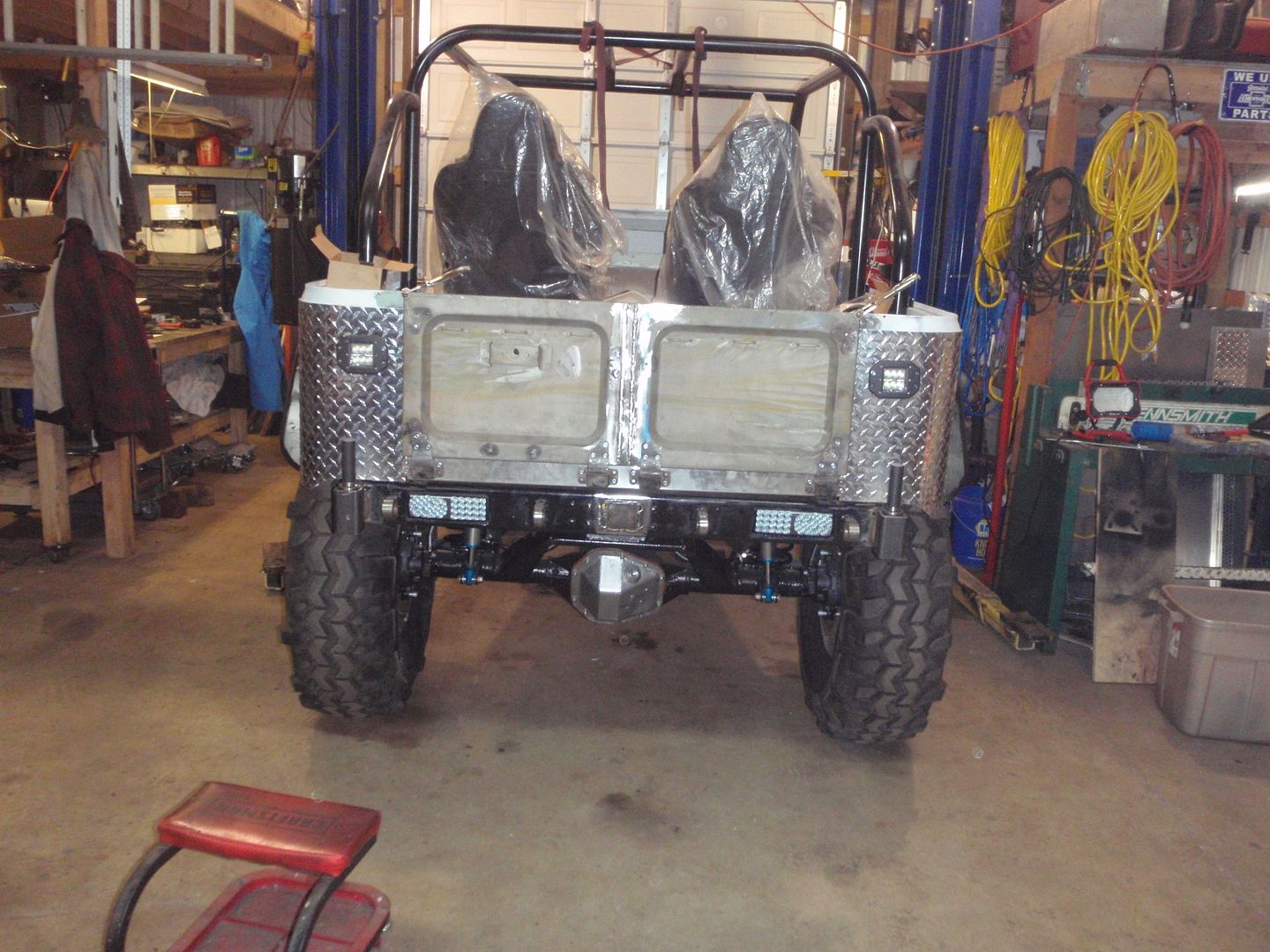

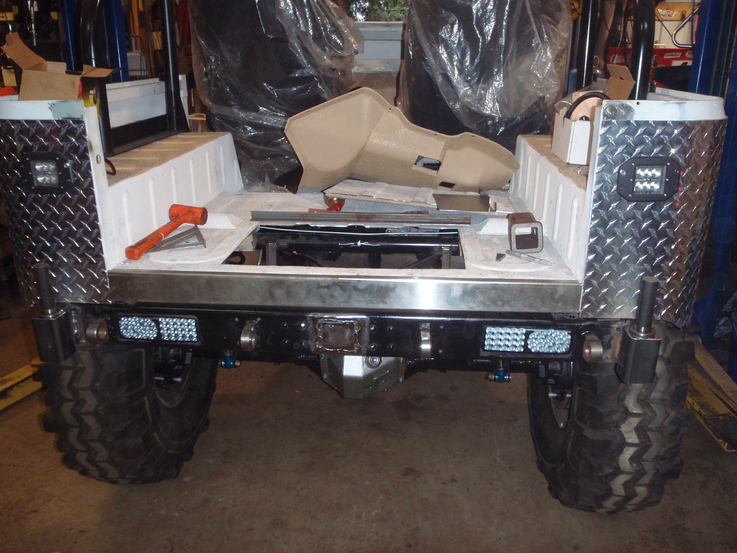

      back on the '40
      first step, mount the taller springs
      and I still can't convince the spring/coil-over dealer to send me 150# springs... I know he's trying to help and I'm trying to maintain my sense of humor.
      onto the rear swing-carriers
      I was going to go with 1 pivot, but the tire is a monster that is going to be on there, add 10 or 15 gallons of fuel, a cooler and a hi-lift jack - and hanging off one would really stress the mounts and the poor sap who has to push it uphill to lock it or try to hold it open when the vehicle is aiming downhill.... so two it is.
      ever look at a mounting spot and think "that's way too good"... yeah, this is protected yet accessible... but before I make it permanent I'm going to consider it a bit more

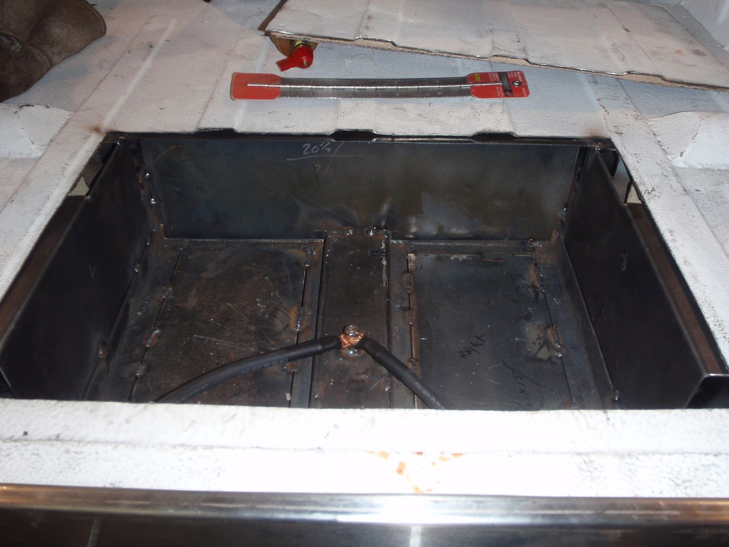

                    I also am going a slightly different route with my transfer case brake
                    battery boxing
                    oops
                    that's better
                    add hinge
                      • 31963

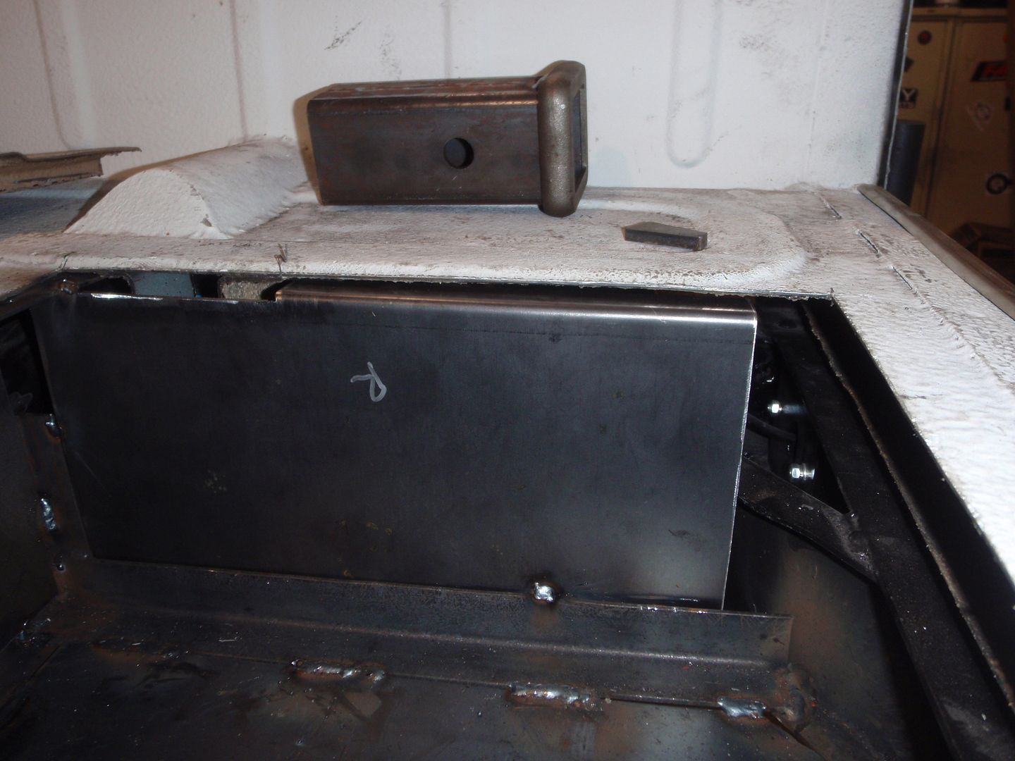

                      #1060
                      tailgate... time to reuse some hinges
                      thinking about reusing the latch for the spare tire carrier.... not sure it will work, but considering it...
                        • 31963

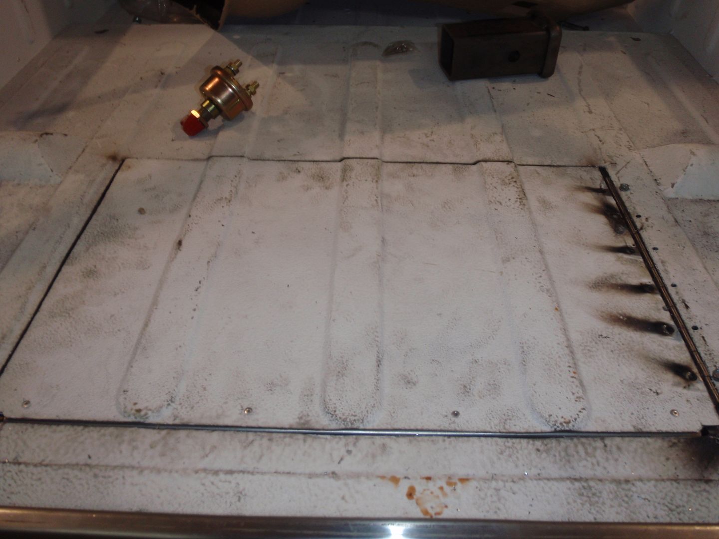

                        Anyway, fun aside... I got more done.
                        time to fix a gap
                        better, but not good enough
                        hmmm, I got a bit zealous with the hammer
                        no big deal, I have heat and a hammer - it is fixed
                        temporary latches
                        onto the carrier
                        2x3x1/4 tube
                        hmmm, some adjustment is going to have to happen
