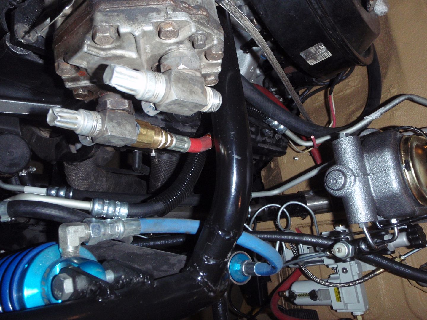

    is that a check valve up against the compressor?
    I don't know what you're seeing...

      I was looking up check valves and they looked similar:
      I thought, if it was, it wouldn't even matter that much if it leaked a little. The compressor has plenty of output and you'd still be able to store it without it leaking it out. Just "Checking"... haha.

        #1158
        yep, but why?
        Just asking... we may use that as an idea on our high expectations project...
          [ATTACH=CONFIG]n1082670[/ATTACH]
          nope, I pinned the fitting to the air compressor fitting because the a/c fitting is not NPT but it's close.... by liquid steel and pinning, I hope it stays on.... and it should.

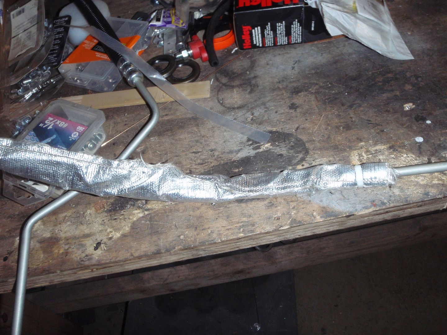

                            got the right(ish) hose for the hydroboost
                            and stole the heat cover off the wrong one...
                            and my tube bender needs a new bolt - weird, this $5.00 bender broke bending 3/8" steel line.... pos right?
                            first fit, maybe now some might see the reason I wrapped the headers.... smart, no?
                            with a little extra bending, it fit
                            and covered...
