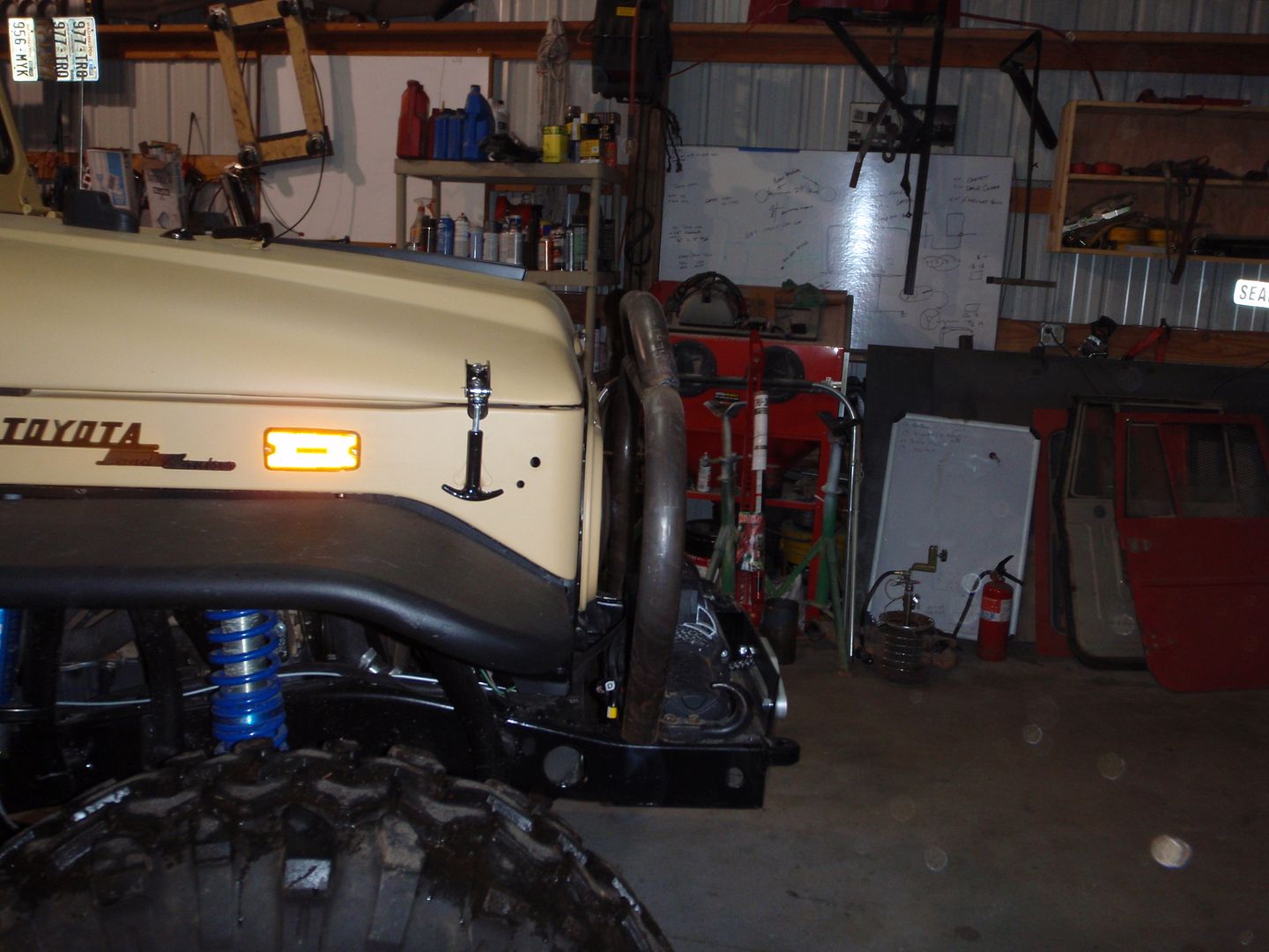

    LED lights don't have elements....
    anyway, now that that's cleared up

          I was just checking to see if those were usable as marker and signal because we have flash lights at work that are dual intensity...

            If you read Barry's thread on hs pickumup, you should know he replaced almost everything with LEDs saving lots of voltage and getting brighter lights.
            I need to look at my PAINLESS kit and see what I need to do to change bulbs to LEDs.. 57 lights are good for what it is.. LED will be better!..

                not much done.... just playing with lights

                        brush guard
                        seat belts
                        start on console
                        trimmed
                        replace steering arm
                        it's longer
                        decreases radius of turn, but gives better leverage
                        dash doodles
                        finish weld and paint safe
