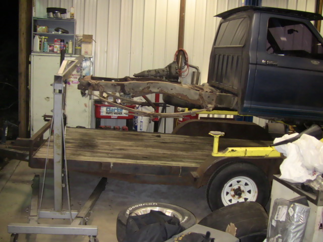

    After a nap - we got back at it Saturday morning, and by 11pm Saturday night the engine, trans, axle, msd box, gauges, shifter, etc were all out of the ranger, the ranger was on the trailer - and the splash box (which is HEAVIER than the steel stock box) was swapped out for the steel box that fits much better..... the truck is just missing some white to be a patriotic paint scheme...

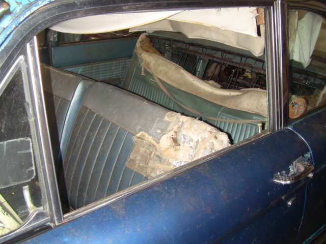

    Headliner and seats are pretty well shot. Hopefully I can find a rear seat that is close enough in size to replace the existing one without having to pop for $$$$ oem restoration seat recovering prices. Jegs has some "racing buckets" for about $145 each that are tempting - but will kill any vintage look - I'm not sure I'm ok with that or not yet.

    Lots of potential for sure ... those cars are so featherweight, with a decent small block they can run real nice.
    If you're interested, I have the original black vinyl low-back seats that came out of my 68 Cougar. The bottoms have been covered over with a plain vinyl material, no pattern, the uppers are still original. Padding seems to be in decent condition. If you want to come for a drive in to Soviet Canuckistan, I could meet you half way between Toronto and Windsor ... just buy me some lunch and they're yours.
    cheers
    Ed N.
    07 Mustang GT with some stuff
    88 T-Bird Turbo Coupe 5-speed
      A thought on the seats .... check with some of your local, smaller upholsterers, sometimes they will give a deal on re-doing original seats with whatever material they have on hand. The lady that did my camaro only charged $600 for everything .... about half what the bigger shops wanted.
        I love it! This car would be bitchin for drag week!
          Ed - thanks for the offer! I'm going to see what I can scare up here locally - but it's been a while since I've crossed the bridge to canukistang - it would be fun to meet you.
          Shawn - yes! that is the plan.
          Dan - thanks - there are few upholstry shops around here that aren't either marine specific or cater to higher end customers, with all the stuff I know of around here, uphoolstry is one area I don't have a single connection.

                              The ranger is already "back home in Indiana" to it's new owners house.
