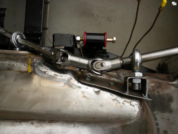

      • You are doing a great job, I love following along on projects like yours. I remembered seeing a picture of a double universal set up. This guy is putting an ls1 in a TR6. It may not work for you but it may give you some ideas as to what is possible.
        • ^^^ That looks neat - and gives a picture to stiney's idea of heim joints in the steering shaft.

                      I didn't... it clears just fine on the Spider - I'll see if I can find a picture of that portion.
                      pictures
                      lots of clearance.
