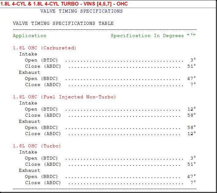

    Another fact that left me running away from Subaru forums...revealing the cams for the ea series.
    the spfi Subaru of the 80s has a cam as big as the stage four Crower cam for the ej series..
    and you cannot just install it to the ej engine, it needs special springs, and warns of a lopy idle.
    I know how tight the big cam gets, the belts have to be non stretch, or engine will blow.
    the mystery...
    how does it idle that smooth?
    retarded timing of course. This one at correct timing has the sputters, but they are gentle. (Three main is good for that)

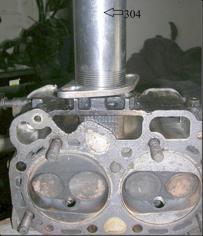

            little head big exhaust
            tried the flange on an old head. Excellent..there is a little bit of reaming to do, but that is as close as I have gotten for this one. the gasket on top of flange is a turbo gasket, meant for high heat pressures. Awaiting the pipe that fits the flange, that is a thick stainless piece. the cost for this one chore is now at $40
            13 for flanges, 17 for pipe, 10 for the gaskets.
            total cost of header is now at 200 something. All this time, all I did was delay a similar cost.. for the wrong header. Well worth it to have a correct one, stainless..heavy duty and balanced..
            only being familiar with horned instruments after running a Subaru. this one is going to get a little more bassy, but no v8 thump. A giant bumble bee. As long as it is pleasant. One thing I can never stop admiring is zero counterbalance twack , (the real annoying sound that goes with rice). this car has none. It is a modern Porsche six minus two cylinders... attractive to look at the source of noise.
            for now delayed for an unknown time. A pause with sun today, more rain coming. I'll just have to wait. The last chore.
            timing ahead a little bit. Good to go. I can feel that damper close. It is a good thing I went giant on vacuum diaghram size. with exhaust open it should need a few more degrees. I did learn now, the exhaust is the biggest retarder on the ea82. looking forward to opening.

                        browsing you tube for the ea82 Subaru finds some once and awhile. I have yet to hear one running all four..
                        and the backwards misconception of the ea82 turbo with its 3 degree cams portrayed as fast just puts a pit in my stomach.

                          • #58
                            header ends installed
                            will grab photo. robust for the little sube, nice thick gauge. Not a single inkling of any leaks.. I am very happy.
                            just under two inch o.d., the new pipe is just over 2 inch I.D., big difference. ..and I actually had to wonder what the problem was? It gets even smaller inside the pipe, I was using subaru original ends. As you can see the flanges are mutilated. 26 years old.
                            I have not had a sealed header for an ea82 in 7 years. the spell before the loyale was also seven years..no sealed header. I go back to the 90s with the ever hissing subaru. I liked that loyale, it held a header…but it was the 84hp engine.
                            The ride home dialed in rather quickly, a lot quicker than I am used to. The ea82 header is a big equation in something it is doing under there. Changing something at the header is typically big drama. The highway was easy going..looking forward to a long ride.I need a whole lot more brake now, letting off the throttle, the engine is free flowing. To feel the heat of a tight seal is miraculous at this point, right at the heads. perfection. Nice and heavy piping. the odd note is no crackles letting off throttle..not a single pop noise. Sounds like a plane in a nose dive. Being a one of none, I could call this the zero.
                            away it goes.
                            some blurry shots of the install
                            passenger side
                            driver side. looks worse than it isn’t. my camera tends to be an ass around welds. No weld is visible at the flange, I carefully welded it from the inside. this was a trick by subaru as well. As heat has its way, the inside welds curl flange upward to make gasket tighter. Even with the weld, it matches head exit size closely. A lot more open than previous ends.
                            old header end from the bottom.
                            • #59
                              followup- header ends.
                              this is precise welds, they head for 1500F, or the altering point of dimpling regular steel. I knew to check it today.
                              The real test for welds is the 12-24 hour mark, done densifying, or deflating. Just what the doctor ordered for this one. Cold start, to warm. A big hint of robust with less throttle. amazing to hear from such a tiny engine. This was indeed much larger than not even I let myself believe. One would hear this car coming, and know it is not in the typical 10000cfm twacky ricer. Very intriguing sound. The crackling I thought was an exhaust leak, is right at the o2 sensor..and I am the only one that hears it. there is no pops on throttle let down..this tells me, if it does it again, to search for exhaust leaks. Beautiful as of now. I had my dad standing in back and to the sides as I gave it throttle. He chuckled in a way I don’t hear often..and asked to go for a ride. that was yesterday, just after welding. Burping air fuel changes, flux gas.
                              Today, from cold start into full warm. Wow. I also got underneath and got real close to seams, a normal routine, with my fingers. Nothing. perfectly sealed..and casual too. A sense of longevity to go with it. Why did I take this long for the exhaust math at the heads? It was actually internet advice 6 years ago..and the rest is history. This is all american. I can say common sense and mean it..
                              I of course apply science to this to lose people who do not think.. call it a defense. Just kidding.. almost.
                              amazing video on catalyst grade materials (they are all noble metals)
                              if I could hand the header ends to someone that would listen.. I 'd tell them there is noble dust embedded.
                              I'd swear some of them are deep enough to see time. I won't say how, you'd think I was crazy.
                              in relation to this post, one of the reasons for the larger header calming a volume..is to kill the hammer that makes a catalyst hotter. amazing trait about the noble metals.
                              This project actually had to have a header for the volume the cam times in to keep and let go, very basic.. but I identified another reason for proper enlarged header via this video.
                              in defense of big pipes on big engines. the same engine in the 60s with a 2 inch pipe..to try today with a cat and modern rules, all the pipes need to be bigger. that is not an act of an ape with his hot rod, to see and hear the big pipes. They have to , to stay safe.
                              Another note is about welding. I checked my auto-dim helmet twice for the #9 on the dial, thinking I had it set too low. The stainless at 1/8th inch is the brightest weld I have ever done. A brilliant white star. Very nice metal. I’ll bump the mask up to #10 or 11 next time.
