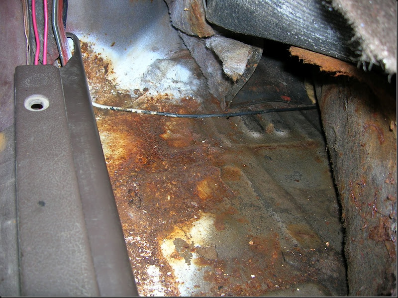

        this one, the floor under fuse box, driver side. My 301 delta 88 had the same weirdness.. if floor was damp. Not much to notice anymore, the fires are as strong as an accel 300+ with iridium plugs..and intake can't burp on a damper. But this buggy used to notice.

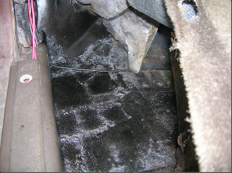

        I am awaiting some raam mat, need small pieces..finish this chore off. It aids in keeping amps content. All driver side cars get damp, even if no leak. Could be the wires. Now the new cars or any with a crystal oscillator (digital) mounted and grounding in the area...won't notice it anymore. I still do, but I am a nerd.

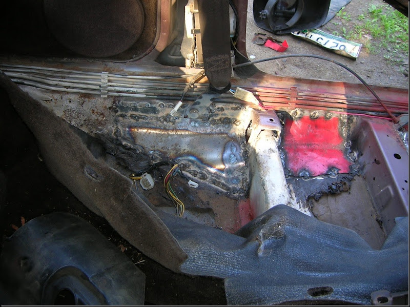

        Awaiting floor deadener. This is not as rusted as it appears, the weld is quite outrageous. The work done in 2010.
        The thing with the driver side is the fuse box and cluster of grounds subaru slams together..up above. This area likes to be electrical insulated. Raam mat being butyl, like factory, will do good. I have this airing out for coming days. The black paint is “oil rubbed bronze” by rustoleum. A real good indication welds are sealed and strong is odor. This car has none. Dampness creates the oxide layer, it would take years to rust through what I have done…more years than it took to need what it did in 2010. 23 years old at the time. The real reason for crazy strong is making a jacking point out of a side arm that is underneath the floor in photo. Does great. I actually like the sight of this, very content. I did both sides to strengthen for jacking point. photo does not show seam were rocker meets floor. that is a big solid bead of weld for a little sube. My version of rocker panel encapsulates this.

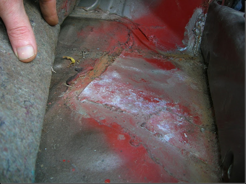

        passenger side. Easy life here. This will also get a small patch of raam mat.

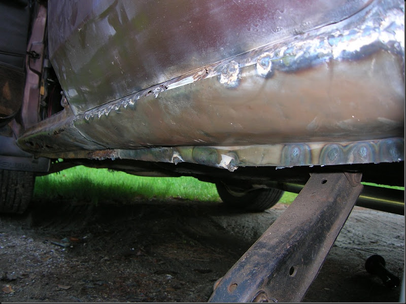

                    The sube is a real weld, not a wild stab. In fact, a guru would just put a hand on what's been done and say "good", like a wine tester.
                    The sube has some serious things needing rework, and I hope I did not make it look simply done. It was not simple.. a mistake is death in a body wiggle, (going for big throttle on a false confidence).

                              rear weld
                              Took 3 weeks. The longest wait state for a weld on this car yet.
                              The workload was a lot bigger than I did not compute. Just looking at photos, it really is a silly thing to comprehend. The distance, load, and that silly flat bar.
                              4am ride, I realized the density created. The diff acts like my 84 monte carlo SS.
                              must be similar, simply different sizes.
                              Very taught and rugged.
                              A regret, as there is no book for this, I should have started with the rear diff bar, and went from there. The rocker work driver side would have been nulled a long time ago. Live and learn.
                              the reward still exists, but the rockers are getting a third .8mm layer. that must be near 1ton caged all around that monster.
                              It really is a special ride.

                              a before and after of the diff bar. This was the monster. I feel abit supid about that. I ignored it for 6 years. It even took out the gas tank and front crossmember into a crack.
                              This could be the biggest advice ever. start with rear diff bar on the old sube...and rid the oil filled ign coil (evidence of pcb infection -enough to kill a good grinder).

                                I took a a hammer to the young replacement rocker. it was worse than I thought. I did have an intention to use this as a outline 6 years ago, I did not trust it then either..brand new.
                                new rocker is 16 gauge, all kinds of decent structure to weld to. that is where you cannot see, my biggest welds.
                                then I found a floor problem, also young. In fact, the welds on the white beam scoot right aacross where the floor went bad. That is only 3 years. I did nurture a punky spot a few years ago, this is the finale. Also 16 gauge. The inner rocker seam rides the vertical.
                                The front half will be 18 gauge. Easier to work. the right side gets nothing. No split in the original rocker, and I went over it with a new one anyway. This should equal out nice, this car is one that needs the concept of panhard bar, odd side torque number unknown. the left side takes the beating forwad of rear wheel. The right side takes the beating after rear wheels. Subaru does indeed have that backwards. Most american v8 chassis gets pummeled the same way as this subaru. I am a fan of the b-pillar..take a guess as to why?
                                This is very strong. Inner structure is doubled, with a steel rod. Now there is 3 rockers.
                                mig reel 22 in the box...going for 44 pounds. A tip for suby welders..the license plate is the shield for fuel lines while welding. I pop lines up off of holders, and slip plate under, give a bend.
