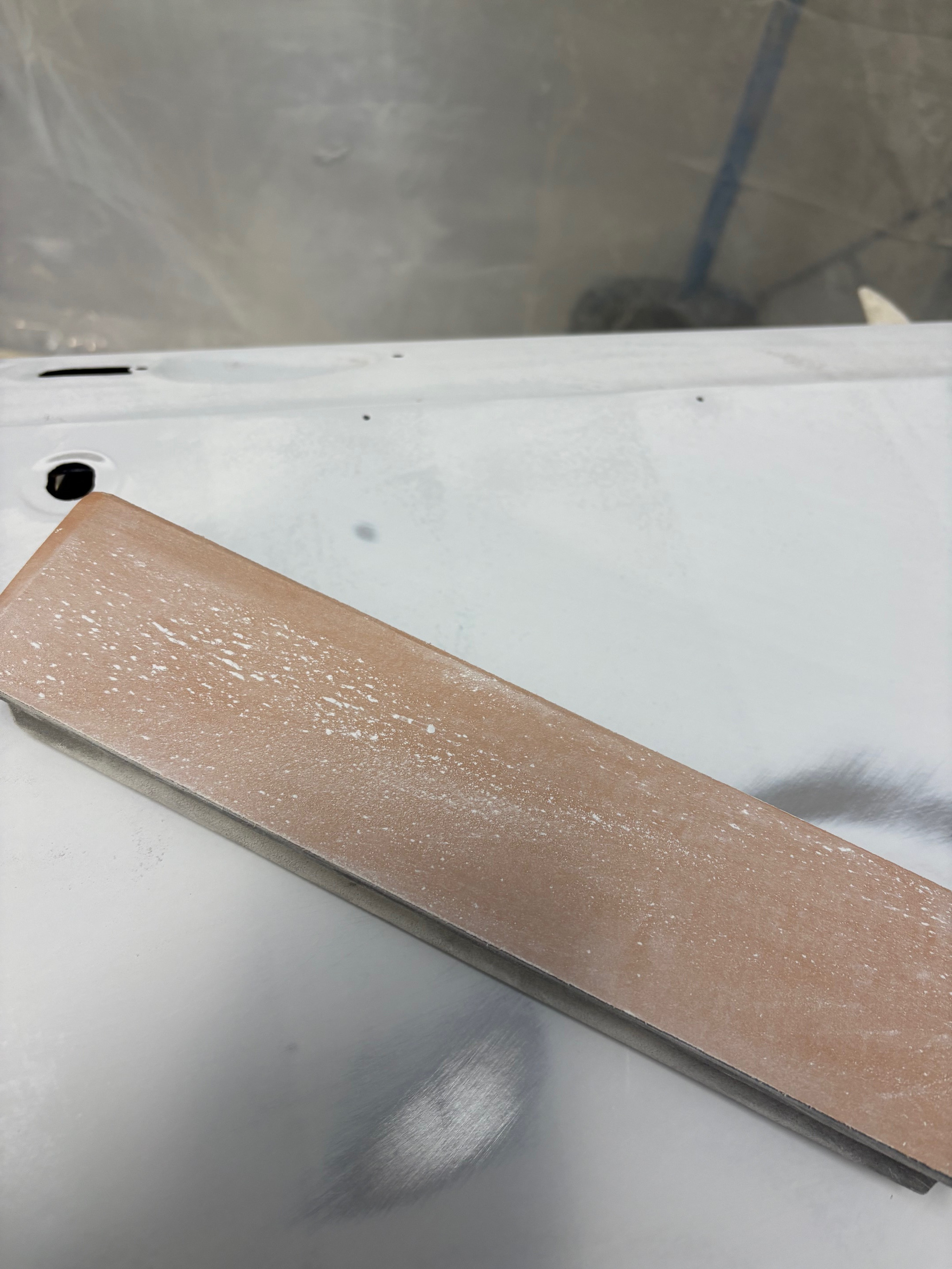

    Using the Eastwood roll-on primer system, I was faced with sanding the epoxy primer. Even after waiting the specified 4 days for it to cure it still loves to clog sandpaper. Note of caution: If you sand with clogged paper it'll leave nasty little groves in the primer which ultimately will show up in the final paint. I tried several methods to clean it out including tapping it out on my pants leg, swatting it with a paint stirring stick, and anything else I could think of. Turns out that there's a fairly simple solution - wire brush. It works really well and returns the sandpaper to usefulness.
    Clogged paper:

      Using a wire brush, slapping and/or scrubbing, to de-clog sandpaper goes 'way back. With some fillers you'd spend as much time doing that as sanding. Otherwise you'd needlessly spend a great deal of money on sandpaper.

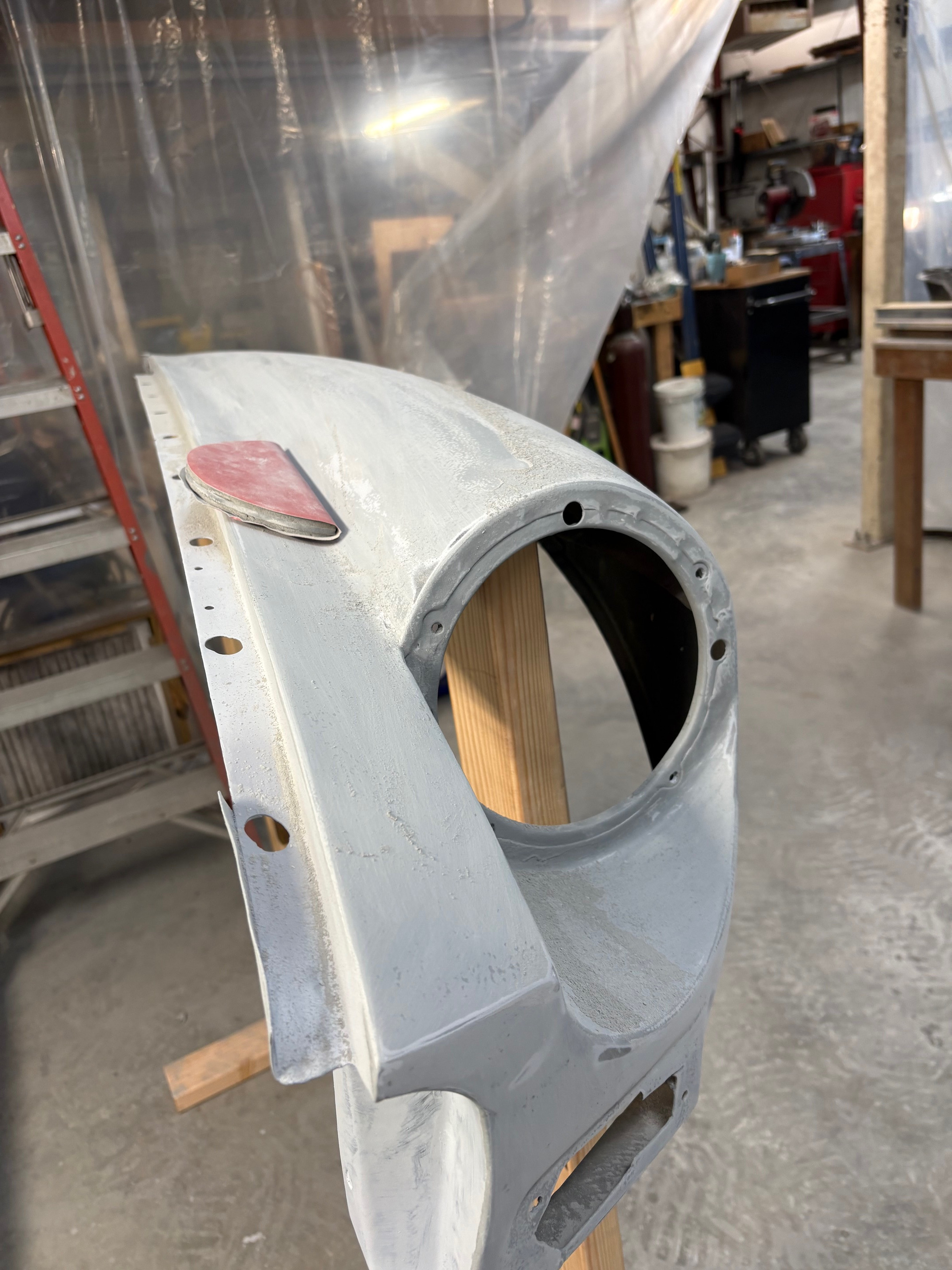

                            Another primer sanding tip:
                            I don't know if you guys know about these but I can't live without 'em - meet the taco. The only ones I've ever met are sized for 6" DA paper and seem to fit in all kinds of awkward places such as this tight curve as shown. Available at any auto paint supply.
                            Best taco tip - heat the paper with a heat gun (I suppose a hair dryer might work) before removing the old paper. I've gone thru a lot fewer tacos since I started doing this. Before I started heating the paper I'd pull the soft rubber off the taco with the paper/adhesive.
