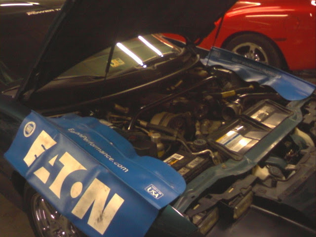

    As some of you might have seen the blog item, I blew the motor in my '95 Camaro. Missed third gear,,,,,and, "took 'er to the moon". I wasn't even racing anybody, just beating the snot out of it all by myself! Toys are ment to be broken.

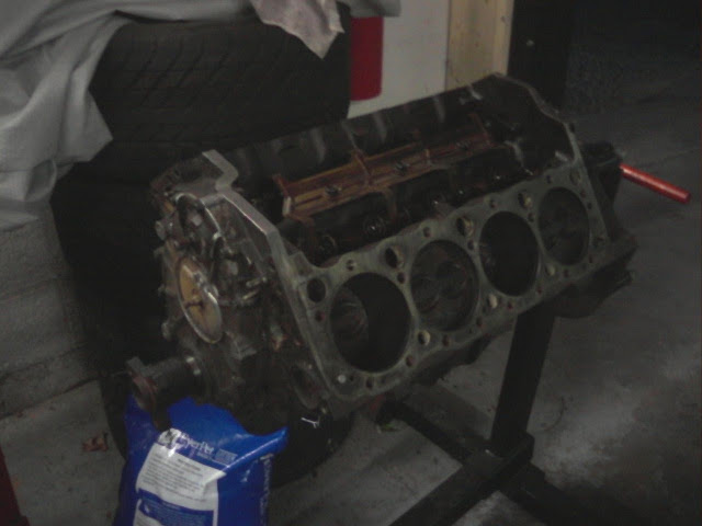

    I obtained another motor with I beleave has 80,000 on it, and here is the tear down........

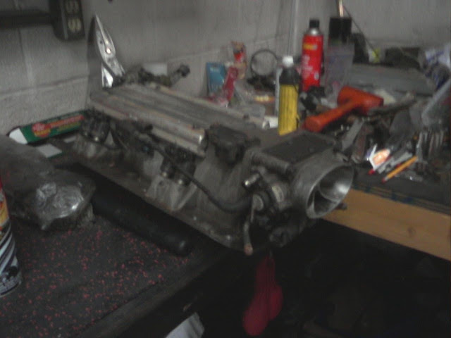

    $450 short block heads and intake

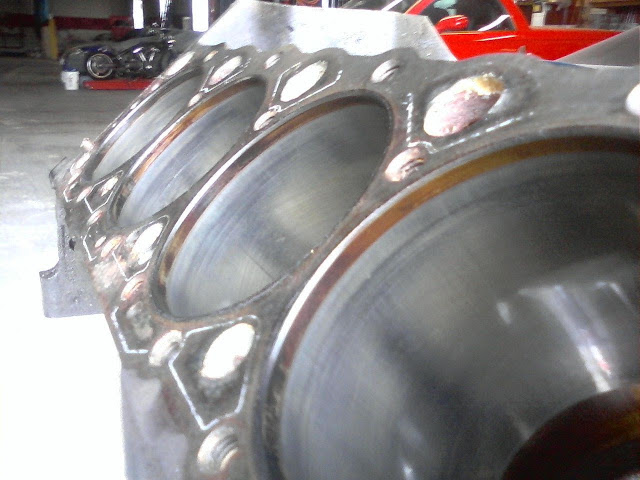

      Walls all look good, maybe no over bore

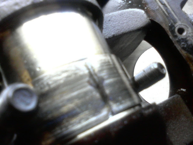

      The only other problem found was this broken cap bolt. the last .625" is still in the hole.
      Little more to do arround here, then off to the machine shop next week. Today I will clean up some flashing on the block with a grinder.

                      Re: LT1 Motor swap saga
                      Hm, busted main bolt - I wonder what would cause that?
                      Sorry to see you have a spun rod bearing to deal with - but hopefully the machine shop will treat you right.
                      Thanks for the write up - keep 'em comin!
                        I have not seen that before either, with nothing catastrophic. Everything else looks good. ???
                        Living the dream!
                          I've actually seen 3 or 4 LT's with a busted main bolt. All were bone stock, not hot rodded and with the factory bolts. None showed major signs of detonation, just very minor cap walk. I just wonder if the metal in the main bolts has changed through the years. I never ran into that with an early SBC.
