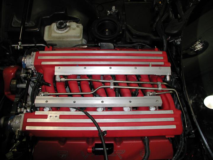

          I ran 12 feet of -8 aeroquip hose , not cheap
          • BKBridges
            • 918

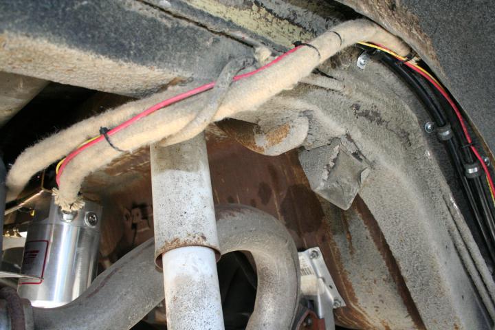

            Ive had good success with nylon lines with kevlar braid over them. Good heat rejection and very inexpensive Dorman's EFi line kit runs about 150.00 and has enough stuff to do about 4 cars. The Kevlar braid comes from McMaster Carr. The down side is aesthtically they dont really pull it off...The pic is of my 72 Baccaruda. Ive got about 20K miles on the conversion/fuel lines with no issues. Most of the fuel heating happens in the fuel rails in the engine compartment. The return line sends the hot fuel back to the tank and heats up the whole tank. Running the regulator under the car right after the filter, keeping the return line out of the engine compartment helps a lot. The down side of that is no air purging in the fuel rails (debateable but a concern). Insulating the fuel rails with silica felt can help reject the fuel heating, but again, aesthetics come into play.

                Hot fuel is lost HP... I think the rule of thumb is 1hp lost for every DegF hotter the fuel is from "baseline". Last time I baselined my car the dyno room was 118deg F and my fuel temp was about 65 deg hotter in the rails...HP was down a bit from the previous session when things were a bit cooler. Im not too concerned since its EFI adn it cant vapor lock the way its set up (and Ive got decent power "hot". Ive seen fuel tank temps rise 10 deg in an hour on the chassis dyno (EFI car with return line). Some guys go as far as to use the A/C system to cool the fuel rails with evap cores wrapped around the rails. The guy in AZ that did it said "why not? cant drive without the A/C on here anyhow" He was very consistent at the track. Just another variable!

                      The motor was getting kinda hot too...EFi has its issues..At WOT the return flow is pretty low. A big bowl of fuel in the carb can get warm but the surface area of the EFI rail contacting the smaller volume of fuel heats up the fuel a lot more. In my tests we found the rails were the main source of fuel heating (not the pump or delivery line routing)

                              It vaporizes at somewhere around 250? But with EFI, 40- 60psi fuel pressure extends the boilng point dramatically. The gas pretty near reaches the temp of the intake manifold due to the fuel rail heat transfer (with return) on a street/heavy traffic driven vehicle. No vapor lock but some lost power. At least theres no exhaust crossover under the intake! Those things really get cooking... Mercedes as well as Ford and a few others are now running active fuel coolers and all makes have been in-tank regulation (no return) for a decade or two...
