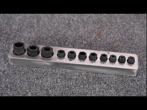

    I am stull using vise grips to remove old stuff.. open end the new stuff, when a new seat needs an extra clamp without making a mess of the new nut. Clever tool in video...and it ratchets.
