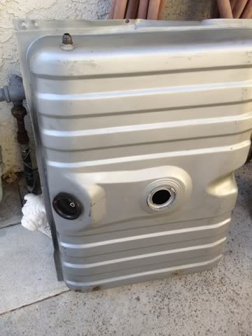

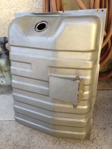

    Guys, I have a bought new, seven year old stock type gas tank that I need to update in terms of some internal baffling and bungs for return lines in new places. The sump I added when the car had a carb on it no longer works well with EFI.
    What is the best way to clean the tank so that I can open it up to add a couple baffles and weld in some bungs?
    What techniques are best for the cutting and welding processes themselves.
    Yes I know welding on gas tanks is dangerous.
    My thinking is that I can effectively clean and nuetralize the remaining vapors and residue. I will open it up with a cut off wheel which will bviously throw sparks. I could use a Sawzall as an alternative, it'll still throw sparks. Once open I can rreally scrub the inside, however its pretty clean now.

    This is how it looks now just out from under the car. I powdercoated it when I installed it in '05.
