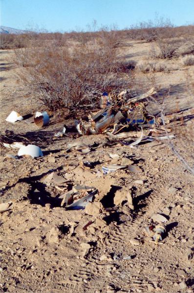

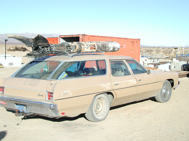

                                A skylight in the dyno cell may be appropriate.
                                I dug up a couple of pics of what things look like when it goes bad (rocket style)
                                BKB
                                www.FBthrottlebodies.com
