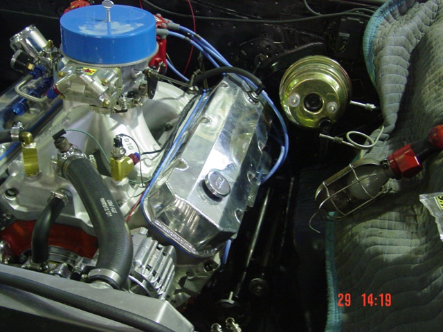

                    I've pretty well been bumper to bumper on the '66: 9" rear, Hotchkiss suspension & coil-overs; detroit speed tube control arms, dropped spindle & swaybar on the front; detroit speed power steering box; billet specialties; fabricated radiator; tremec 6spd; mcloed 2disc, quicktimes sfi can; wilwood brakes; vintage air underdash; etcetc
                    If you have questions about a product or installation give me a shout. I spent about a year and a half adding all this stuff into the '66, after each major piece of work the car was put back together, debugged and driven for a while. I just stuffed the engine in it and on Monday it got to Kooks' for headers, they are doing stainless out the back and should have it next week. Don't ask about the hood - that has yet to be made.
