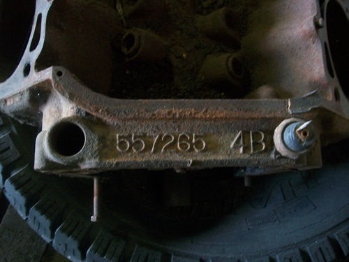

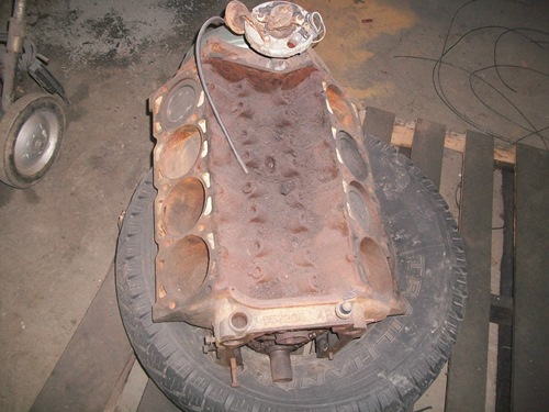

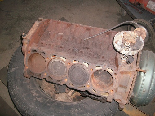

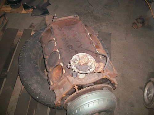

    I am looking for a rebuildable, and relatively unmolested, Oldsmobile motor. Ideally I'd like to find a 455 but would probably settle for a 403 if the circumstances were right. I'm not looking for anything wild, just a mild rebuild for a family ride.
    http://www.ebay.com/itm/180937795425...84.m1438.l2649
    I found this on eBay and would like some opinions before I pursue it. I've got my own impressions but want general feedback from people that know more about Oldsmobiles than I do (been studying hard though).

        It was just an option, that block is pretty rough, my concern are the lifter bores, they will most likely need to be sleeved, that is if you can get the lifters out........ And whatever it came out of the engine didn't turn, thus the reason the converter is still attached to the flywheel..... which makes you wonder what other surprises you'll find.........
        I guess if money isn't an object then you might be able to save this short block, but if it was me, I'd look for something a little more cleaner and that actually spins.........
