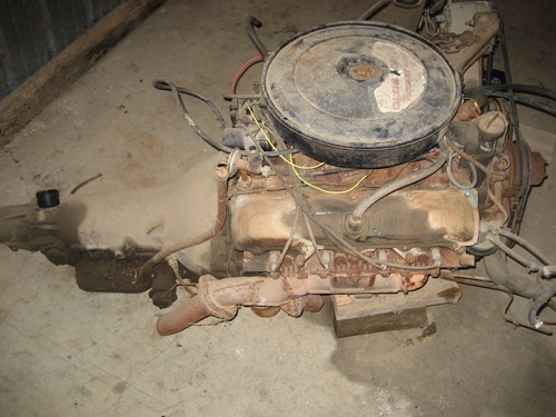

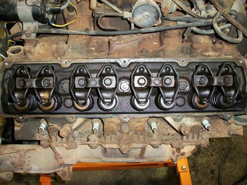

        Just an update. I greatly appreciate everyone's responses, advice, and help. Patience paid off in the long-run. I found a running 455/th400 for a very good price.
        This is the dirty side.

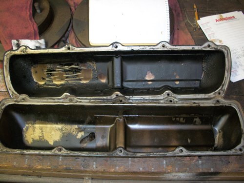

        I made the scratches inside the valve cover, it didn't come off that way.
        • #34
          Looks like a nice motor... Really clean inside!

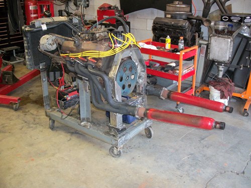

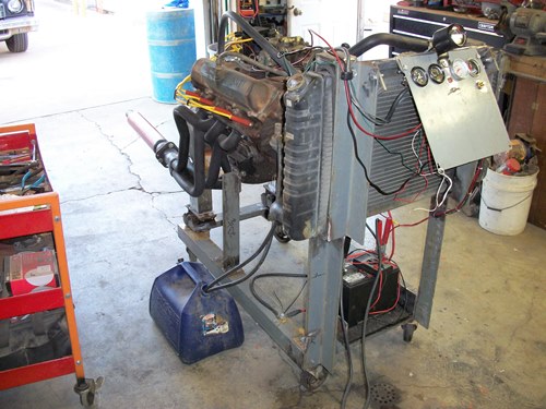

                        As a follow-up after a long for me fab project. The running engine I bought runs well, has great oil pressure, good vacuum, good compression test numbers, but has either a bad head gasket or cracked head. Other priorities, like its intended home, has kept me from working/diagnosing it. Here's a couple pics for those that enjoy that sort of thing.
                        • #42

                            Definitely a nice stand!

                              Thanks for the comments on the stand. I have progress pictures of that project if y'all are interested. I do not consider myself to be a fabricator or much of a welder but I try to do the best I can with what I have, and I'm a picky bastard.
                              DB, I have seen cracked heads spray water out of the radiator just like this one did once the thermostat opened. I made a call based on my experience. From my experience it should be one or the other. In a month, because I have a hard time dealing with the heat & humidity anymore, I get back to work on that motor. I've had several setbacks with its new home. I've been fighting the next weakest link for a year or more. The only good thing I can say about that is that we're/it is running out of links to be weak.
