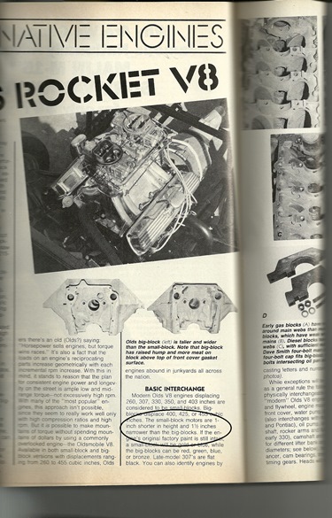

                        Simply, Olds small/big blocks do not exist..it is all one physical size.. Internally...different..
                        Badge it as a 350.. Only those who know to look under the head at the driver side front cylinder on the block will see it's true size..
                          Not true. The Olds big block is 1" taller and 1.5" wider than a small block. I'll cite my source tomorrow but I think Marlan Davis tech article, maybe even post a pic. Bill Travato said in his book that the heads are interchangeable inasmuch that if you have a sbo and want better breathing heads just bolt on some bbo heads and there you go. After tonight's fiasco(s), and winning the lottery, I might try that someday.
                          • #58
                            This is from a Marlan Davis article in the March 1986 Hot Rod page 54.
                            Most of the article in readable form...
                            http://highperformanceolds.com/phpbb....php?f=23&t=19
