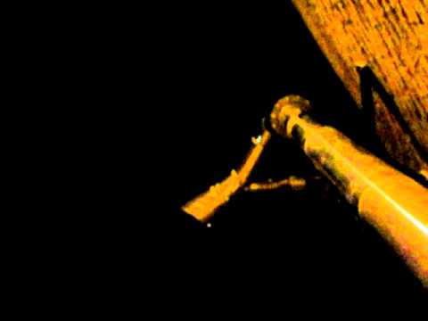

                            Barton Racing has the gigantic mufflers, look like they come off something Randal works with. They do not quiet down much, here's some audio of a tamed down pro stock Hemi
