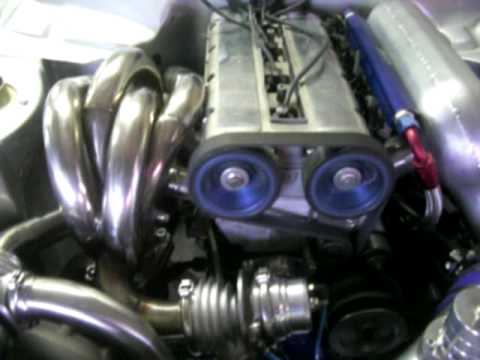

                    Bob, I'm sure you know already, but Turbobricks is the go-to for info on doing go-fast stuff to the B234f head. There are tons of threads on it and a lot of guys are running them nowadays. I'm getting ready to drop one in a 242 of mine as well.

                      Wow - right down to the valve stem seals that looks allot like a Honda head.

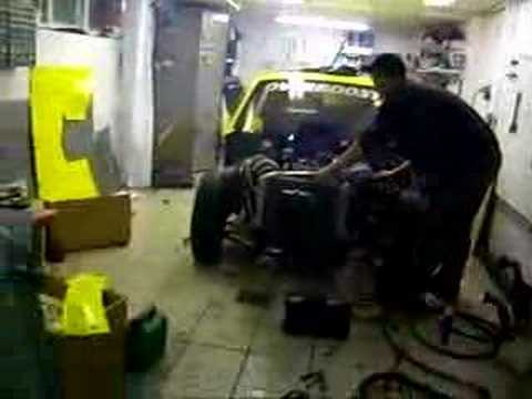

                              that's really cool, but what is it with the Scandinavians and tile floors in their garages?
