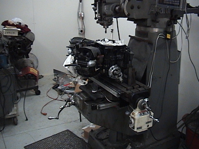

                              This is my mill in my home shop, I have a 52" lathe also
                              but this mill is not designed to do a car block(V-8) I have
                              done VW work on it for my brother and in this pic is a motor
                              cycle engine.... its a 1/2 hp 3 phase but I have a phase converter
                              (electronic type)... I've done a ton of work on this machine but
                              I take my engine blocks to the auto places to have them bored
                              and decked
                              I bought this and the lathe at a auction for a decent price... in
                              Mi a few years back alot of places were going out of business
                              and had auctions
