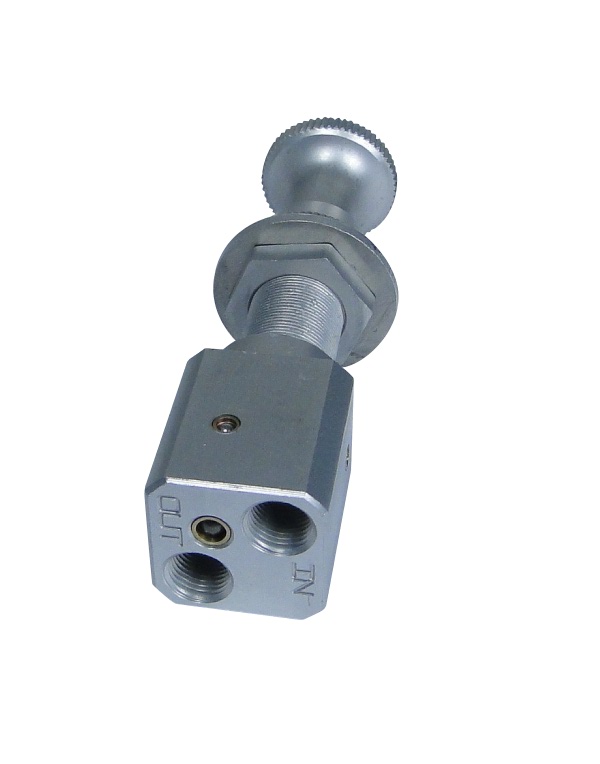

    A lot of hypothetical ideas and interesting as well. But and electric fuel pump is a positive PRESSURE device and a Hilborn pump is a positive DISPLACEMENT device . . . a very big difference! EFI injectors regulate flow by pulse width and are essentially digital valves that shut-off flow. A mechanical nozzle is not a valve at all but an orifice wide open all the time and has nothing to do with controlling flow. (Tuning is with the pill and nozzles are more or less sized for the HP or fuel and then left alone). The MFI pump controls flow in direct relationship to the engines rpm and flow is perfectly linear up to max torque. As engine efficiency falls off after that various orifices (pills) are incorporated to bypass excess flow back to the tank to get max power at max WOT. .
    You have stated you want to stay with MFI and I assume you want to run it now and experiment later. The biggest deal with street driven MFI has always been engine start and partial throttle operation. The first is easy and the second issue is why EFI was invented. The issue with starting is spinning the motor fast enough for the Hilborn to output fuel. Remember a Hilborn pump is not a sucker . . . it’s a pusher. It must be immersed in fuel all the time. The fuel in your tank has to be above the pump inlet. The second issue was 12 volt batters don’t spin the motor fast enough for the pump to start outputting decent flow. Fast forward 30 years and we now have 16 volt batteries. So use a 16 volt battery and one of these:
Name:	Fuel Primer.jpg
    The mechanical primer keeps fuel out of the inside of the car. The plunger goes through the firewall and when you push it you squirt a precise amount of fuel to fire the motor. You only need a small line to a couple of cylinders. That is enough to kick the motor over quickly and the Hilborn pump takes over. This is simple, clean, quick, and SAFE. You quickly learn just how much of the plunger you need to push for just the right amount of prime. Forget an electric fuel pump as a primer. It is difficult to precisely time shut-off, they can easily flood the motor, and can be dangerous in an accident. The mechanical primer is a sure fire easy way for engine start on the street. Surge tanks and float valves were all before 16 volt batteries. Get it running and have fun with it. At some point you will get tired of the rich AFR mid-range partial throttle issue. At that time you can decide if it is worth experimenting your life away or if you want to convert to EFI and be happy. LOL YMMV
