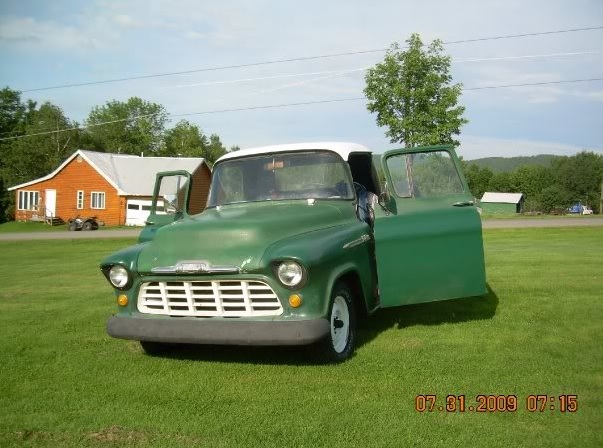

              56....is that a car? or a truck?

                          Squirrel, this thing.
                              I thought so.
                              Where do you plan to put the battery? I moved the battery in my 59 to under the bed, behind the cab, outside the frame rail...but it was a royal pain to deal with it there, so I moved it back to where it belongs. With a stepside bed it wouldn't fit there anyways.
