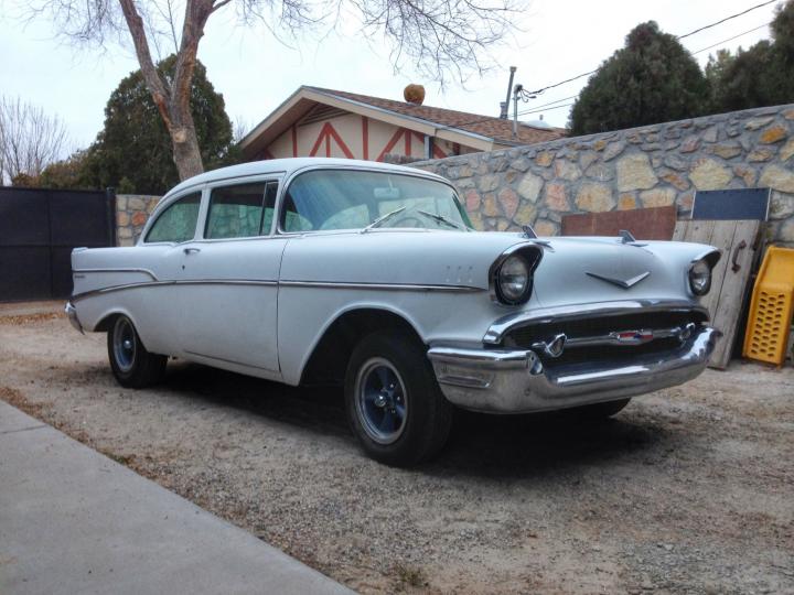

    Ladies and gents. I just picked up a 57 with the help of a couple of B.S.er's. It currently has a 396 and Muncie in it. I am going to put a fairly stout roots blown small block in it and am thinking I will leave it a four speed. My questions are what trans will handle the horsepower/torque and what clutch should I be looking at. I'm thinking a Super T10 or Jerico is the answer, but would an M22 or other Muncie hang? This will primarily be street driver car, but will see a little action on the strip. Also what can I expect to pay for the trans? I have a line on a Tex Racing T10, but don't know anything about them or if the price is fair.

              I can't wait to see it with the small block, I hope you can get the passenger side valve cover off with the small block once it's installed, because when i looked at it, I noticed they knotched the firewall for clearance for the valve cover on the passenger side for the big block. I even asked the guy can you even get that valve cover off? I figured there's probably enough wiggle room to get it off, but it sure did look tight. Congrats on the purchase, it's definitely a cool car!!!
                    If I would have only known you had something to do with this car.......
                    • 1Y
                      • Aug 2009
                      • 223
                      He was kind enough to go inspect it and take detailed photos for me.
