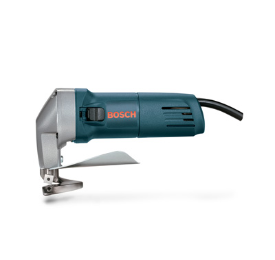

    how would you cut sheet metal with it? Are you thinking of these?
    unishears work fine, but they tend to deform the metal

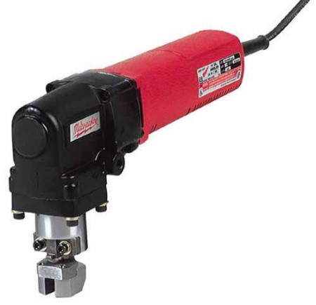

    or maybe these?
    nibblers work fine, but they are not easy to keep in a straight line (when you're freehanding).
