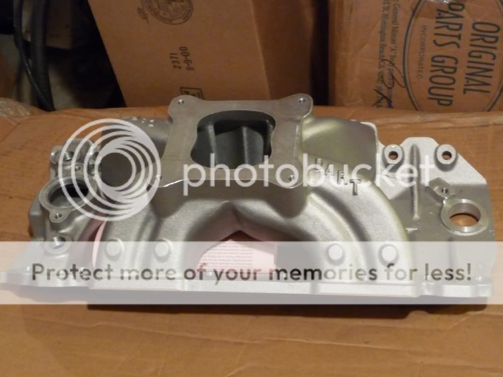

    now the ic
    the 355 intake is just like this one, this is the dart for the 496 but same lay out..
    can that idle control stepper motor/selniod be mounted
ID:	878106here (see red arrow)
    or is that to close to the front runners
    Re: turning an outdated carb into a throttle body...
    My thoughts on IAC is going to be "built in" to a 2" spacer with a channel up thru the carb body so it connects above the throttle plates. I plan on removing boosters, epoxying all holes and smoothing/polishing.
      the iac is to let air in because the blades are closed.. having it above the blades, how that gonna work
        With it mounted in the carb spacer, that is where it will let the idle air into the engine ..... it needs to come from above the throttle blades as they will be closed at idle ....
          conected to the air cleaner housing?
            That'll work too ....
