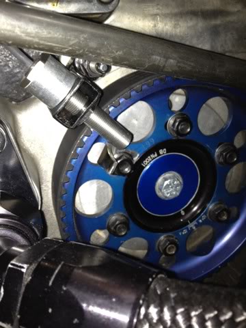

            Super high tech cam sensor
            I figured I'd post picture of high dollar cam sensor setup. Cherry sensor cost $27 mount home made, $4 for wire and weather-pak connector.
                      THAT is freaking brillant. I'm stealing that one!!
