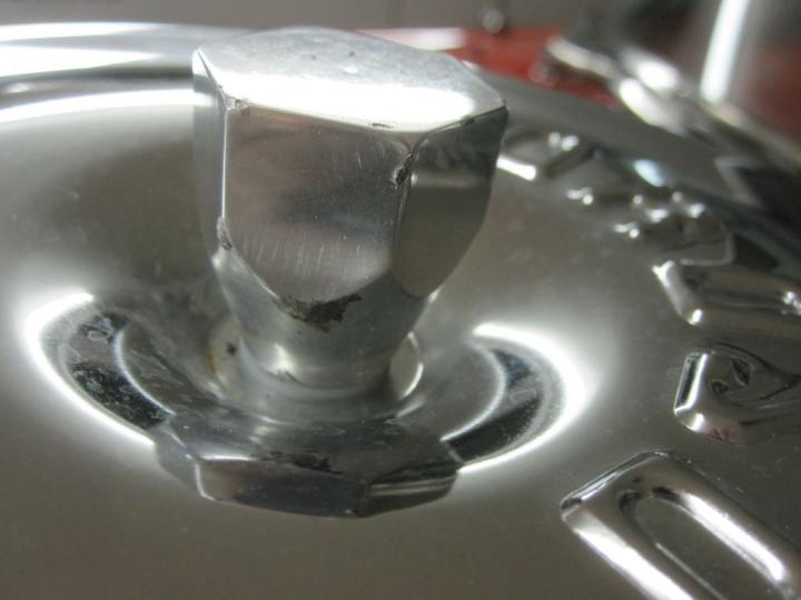

    Jason was one of the guys searching the shoulder of some lonely highway in OK or KS or TX or something, looking for my missing nut. It came off all of a sudden, with the front air cleaner lid, and I watched in the mirror as the nut bounced on the highway in front of Mike's 53 Ford, fortunately it bounced off the highway before could run to it. I found the lid and nut, by getting on the "down sun" side of them and looking for shiny.
    Only on DW can you get 5 guys looking thru the tall grass for your missing nut....
